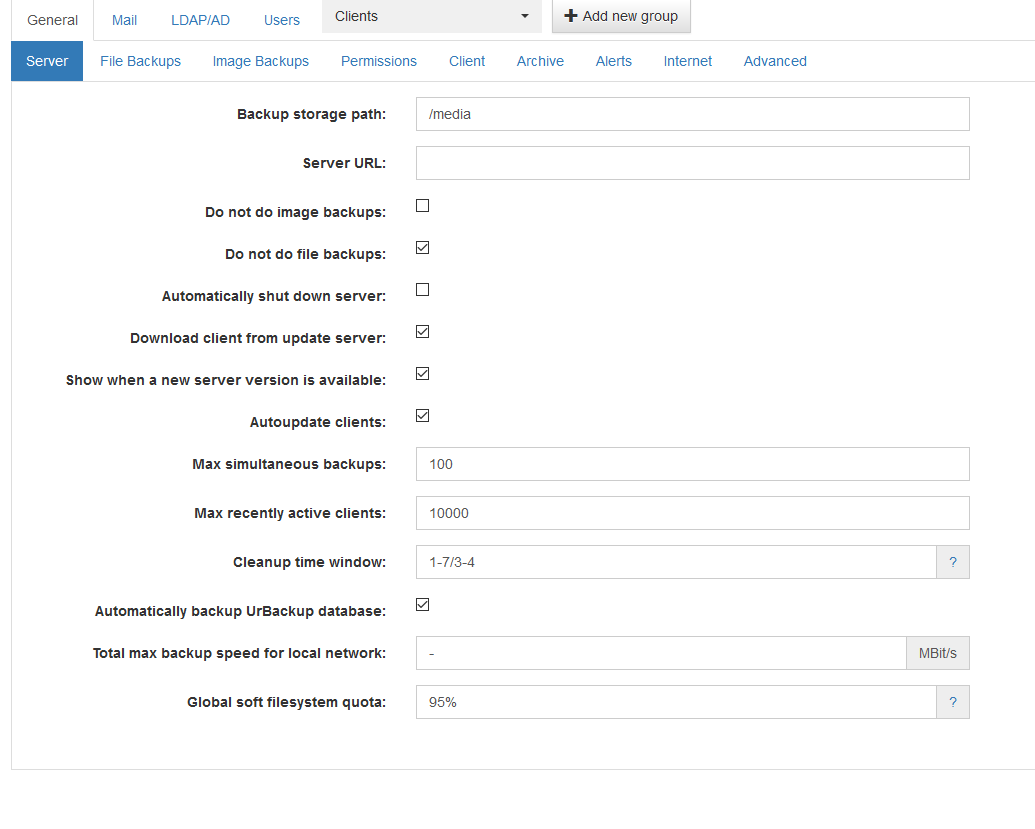

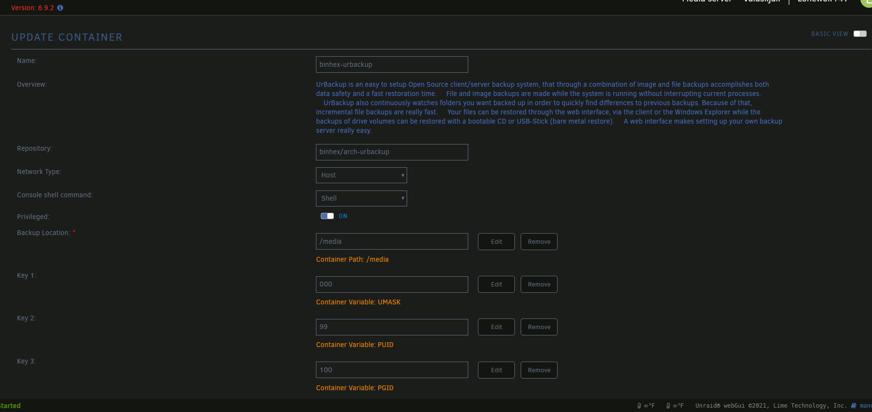

Hey folx, noob here, running urbackup on an unRaid system.

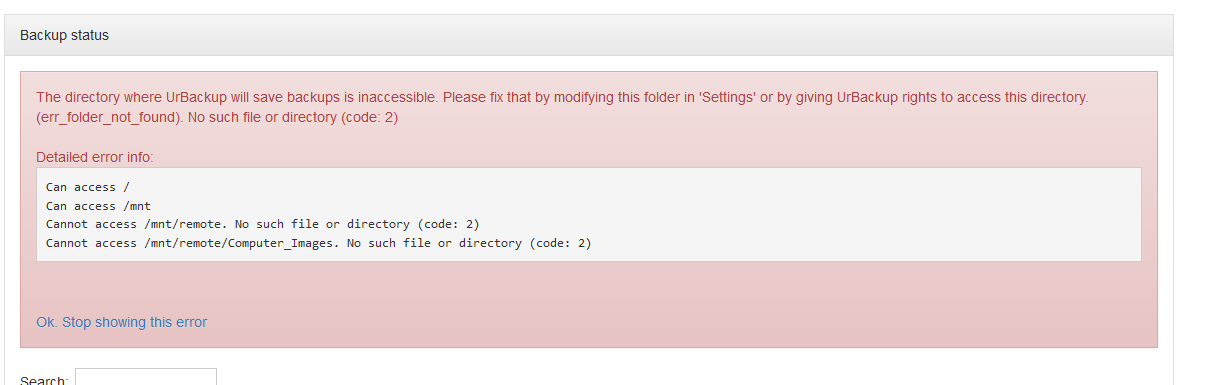

I've been able to get urbackup to launch and run and even make backups. But, I want to change where the backup images are saved. Currently they are saved in my /media folder on the array. I want to instead save them to a shared folder in my QNAP NAS.  I've mounted and shared the NAS folder, I can access it with File Explorer on my windows laptop, and I can even browse to it within the unRaid UI. But, when I go into urbackup settings and point it to that shared location, it can't find it. I get this error:
urbackup can't seem to see anything under the /mnt folder.
I even tried pointing it to the NAS's IP address on my LAN and that was even a greater failure.

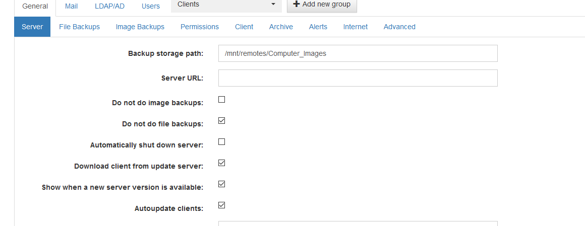

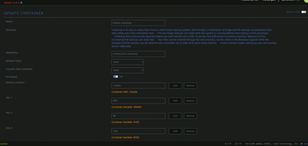

This is my current working settings for urbackup:
Any ideas?
Because nothing is mapped there. Think of containers like tiny virtual machines. They can only access their own folder structure, which is NOT shared with the host, unless you map the location. Whatever you put in the "Backup Location" line will show up in the /media folder inside the container. If you want to point the /media folder to /mnt/remote/Computer_Images that's what you need to put there.
Right now you have it pointing at /media in unraid, which exists only in RAM and will be gone when you reboot.

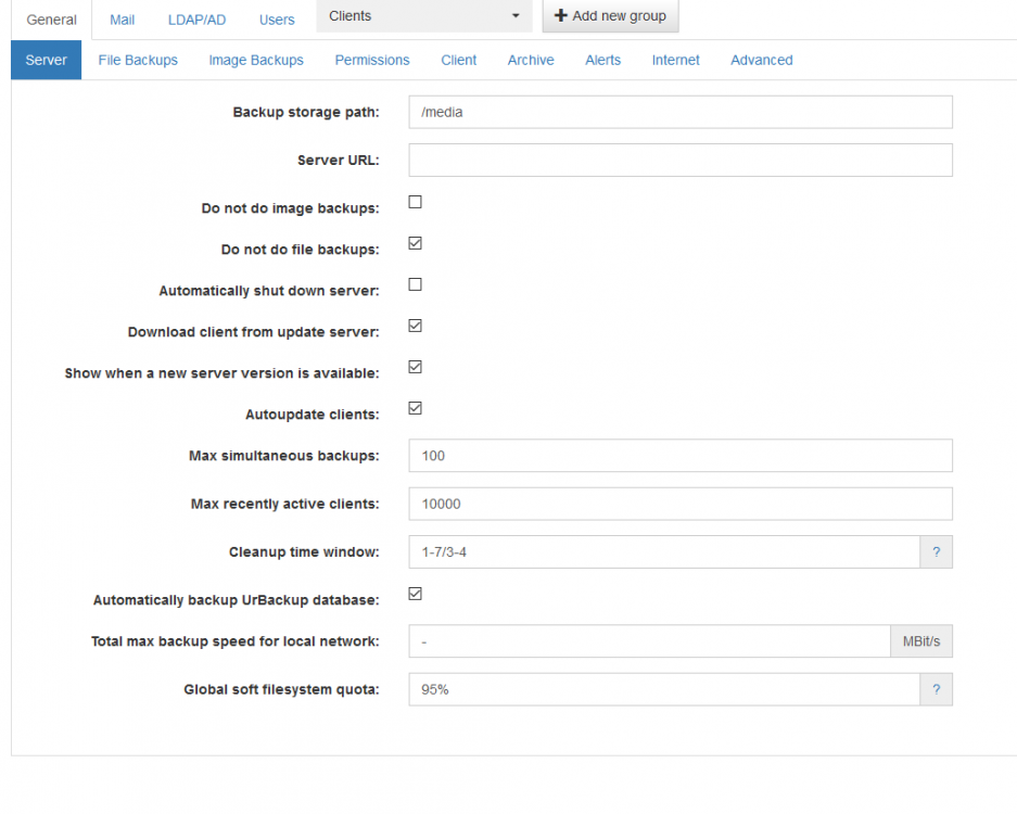

Correct, but my problem is that when I DO point it to the Computer_Images location, I get the error shown in the first image. I just posted the second two to show the setup for when it does work to the array, not the NAS.
NOT the application itself. That always points to /media. You need to change the container mapping. Update container, Backup Location

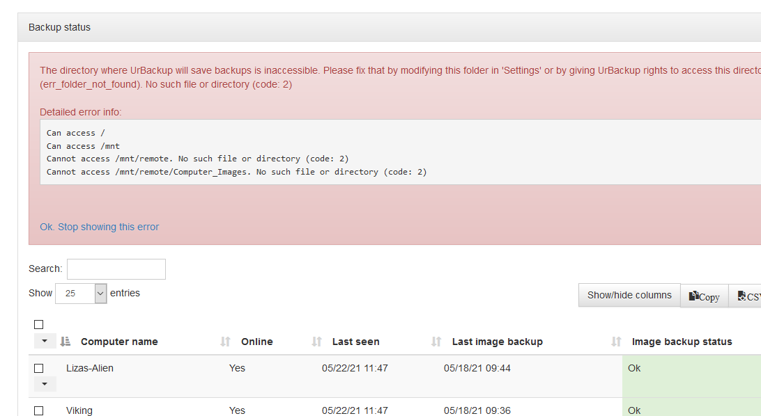

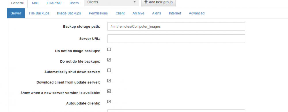

Ok, so I left the app at /media. Then I launched it's UI and changed to /mnt/remotes/Computer_Images
and this is back to the status screen:
Edited by Lonewolf147
spelling issue
No, You didn't.
In your initial post, second screenshot,

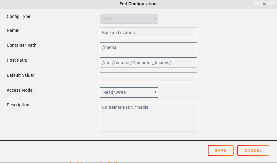

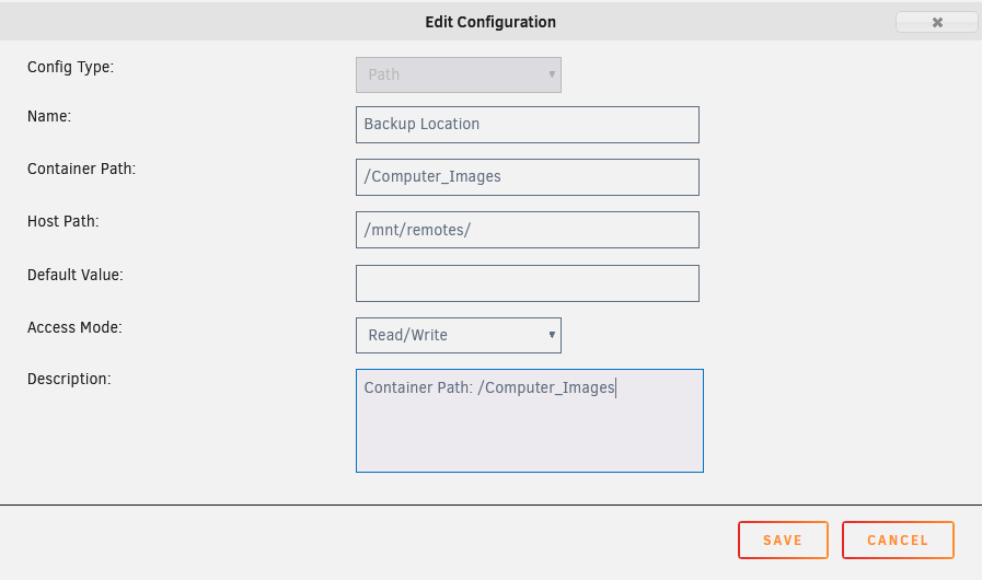

So I switched it around. Left it /media in the UI settings, and made it /mnt/remotes/ for the path and /Computer_Images for the container in the docker app itself.
No errors when I go to the status, but when I try to run a backup, I get a notice that the backup failed. There are no entries in the Log to say why and there are no new files created in the Computer_Images location.
What do you mean? The container side should be /media, the host side should be /mnt/remotes/Computer_Images. That's assuming you see the remote content at that path in the Unraid console command line.
So this is incorrect:
I've seen other apps (so I assumed this one too) create whatever folder is listed in Container Path, at the Host Path location. I didn't need to have Computer_Images two deep.
So do I make Host Path /mnt/remotes/Computer_Images and leave the container path blank?
It should look like this then if I'm reading you correctly
Yes, that is mapping /mnt/remotes/Computer_Images to /media inside the container. You may need to change the access mode to slave r/w.
There it goes!  Whew.  Thank you very much for walking me through that. I was totally misunderstanding how the folder/container structure was working.
