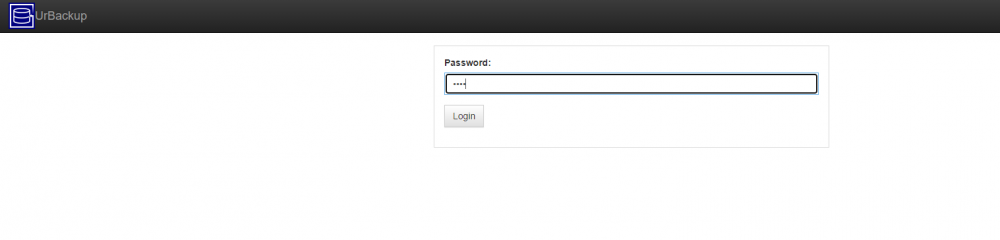

1 hour ago, Supershocker said:
This happens when I clicked the urBackup logo in the top left
you must of created an admin account with a set password, try the following to reset (untested):-
1. go to unraid web ui
2. go to docker tab
3. left click urbackup and select 'console'
4. type in the following and press return:-
urbackupsrv reset-admin-pw
5. restart container
6. attempt login to web ui

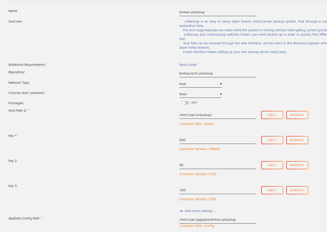

  • Basically you remove UMASK, PUID and PGID variables and change the the variable for the backup to point to "/backups" (container path) and the appdata to "/var/urbackup" (container path).

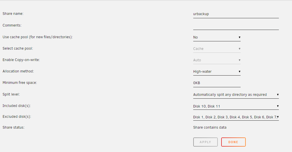

Hey guys,
I have a (I think) small issue with this docker.
Basically it does what it is asked to do, creating backups. But, it is creating them not in the location that I want it to.
I specifically want it to store the backups on disk 10 and disk 11, but it continues to store them on disk 5.
Can you point me in the direction of what I am doing wrong?
Thx!
its not an issue with the docker image, this is an unraid split level issue, its PROBABLY to do with high-water and the inclusion of specific drives, one is probably trumping the other and causing the writes to other drives, you are best off asking this in the general support thread as im no expert on this.
