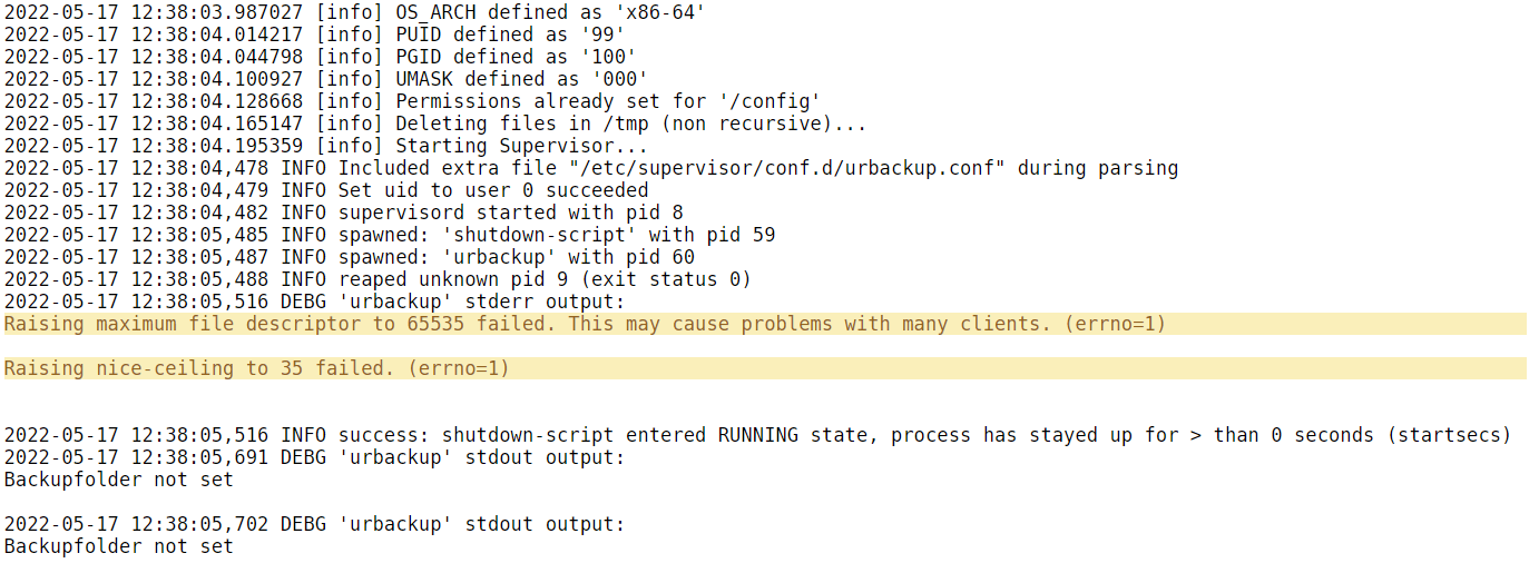

Do you mean -v /mnt/user/Backup:/media  in container?
@wildfire305 So i changed /mnt/user/Backups:/media in container like its need to be , i just didnt saw example
 -v /media/backups:/media \ in docker of Binhex
When urBackup make image of windows disk C its also make image of EFI system partition FAT32 but not the recovery partiton NTFS?
All working fine but having some log error:
yes, but I used Unraid to create a share called backup first and then I pointed the container at it.
I have that same error, too. I don't know what it means, but it hasn't stopped anything from working, yet.
Thank i got it

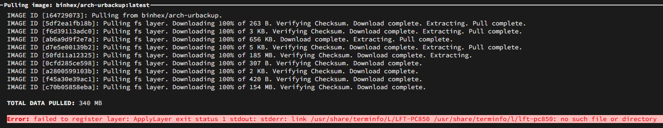

When I try to install this container through CA, I get the following error: grafik.thumb.png.0693e63609253028910921c231454895.png
'Error: failed to register layer: ApplyLayer exit status 1 stdout: stderr: link /usr/share/terminfo/L/LFT-PC850 /usr/share/terminfo/l/lft-pc850: no such file or directory'
I am running 10.3, although this already happened before I upgraded from a 9 version.
My docker images are stored on a case-insensetive zfs dataset, could this cause a problem? It does not for other containers...
I have enough spare RAM and storage, so that shouldn't be an issue, contrary to what you get when you put this error into Google.
Other containers are fine, installing over CA and through the CLI
Edited by steffeneilers
