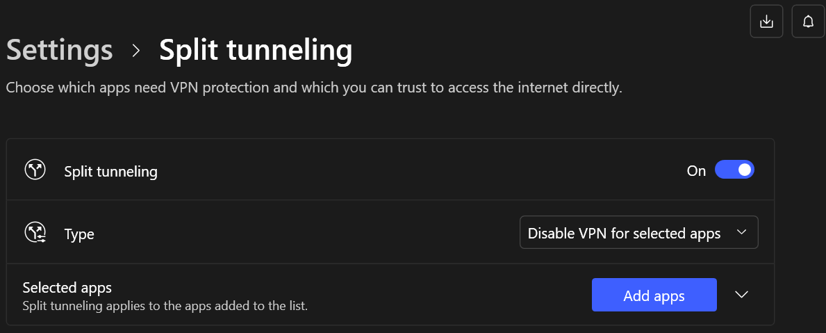

mrbens Posted April 7 Share Posted April 7 Just got NordVPN and had this same problem, but strangely just on one of my three Unraid servers. When NordVPN was on I could browse the GUI of two servers by hostname, but one server GUI was only accessible by IP and not hostname and also couldn't browse to the server in Windows Explorer Network. Any mapped network shares (I map them by hostname instead of IP) were still accessible for the other two servers. I don't have any mapped shares for the server that wasn't accessible. My router still had the IP to hostname mappings for all three servers. Found a fix by disabling the VPN for Windows Explorer after enabling Split tunneling and I can now browse the server in Windows Explorer Network and also access the GUI by hostname. Click Add apps: Quote Link to comment
