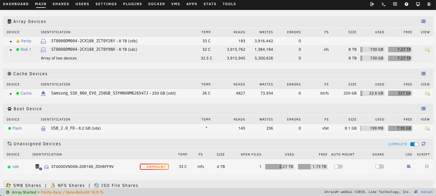

The screenshot seems to indicate cache was written and has contents.

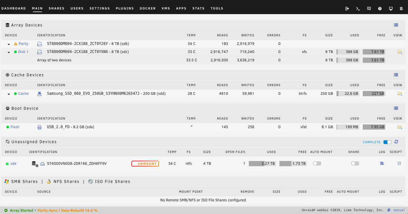

I added another screen shot so we can see that the cache has not changed but the other increased by 700+ GB out of the 2.5TB that is being moved.

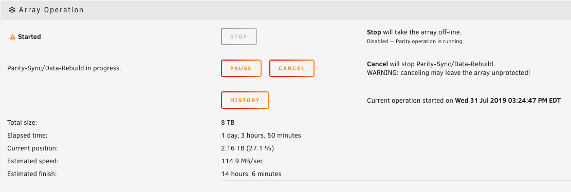

110% correct. Once the file transfers were complete the Parity sync speed popped from 10MB/s to 115-120MB/s.  Here's a screen shot!
