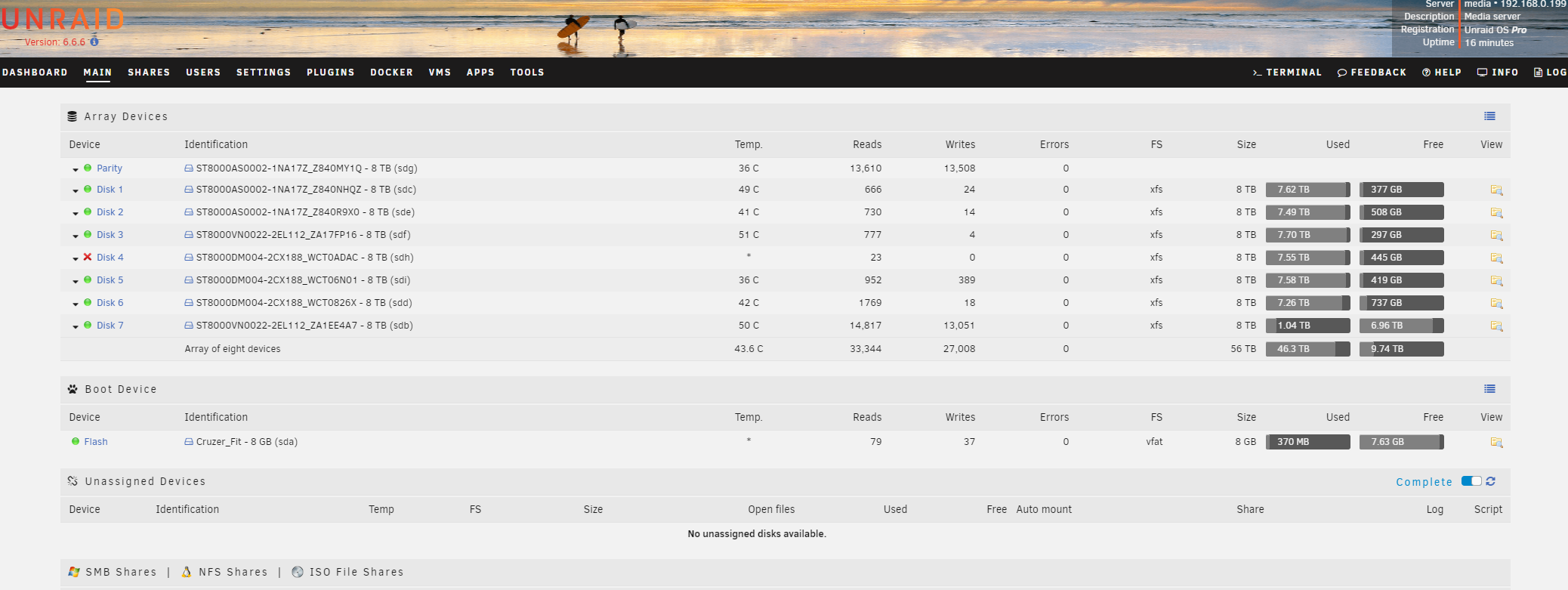

Disk4 disabled and unmountable. Disk7 unmountable. Is it the new disk? Was it ever formatted?
Post a screenshot of Main - Array Devices.

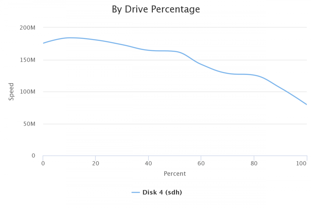

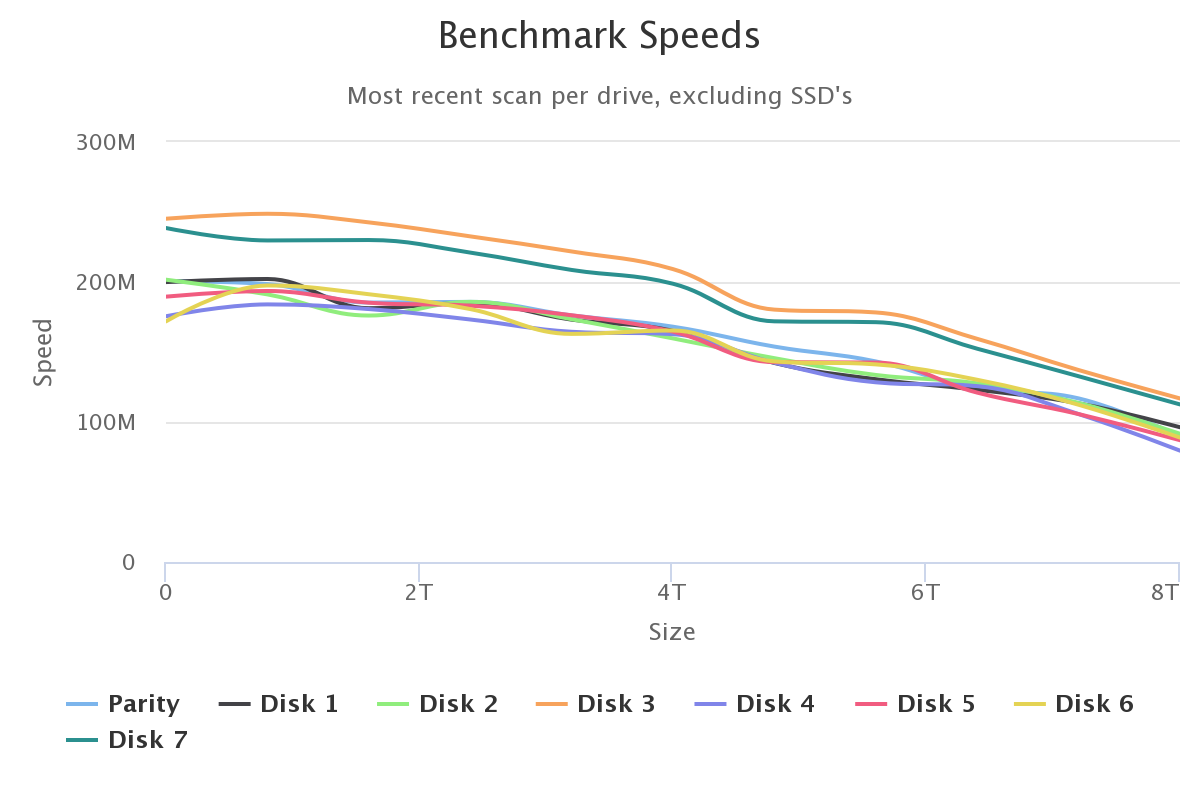

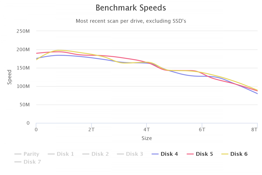

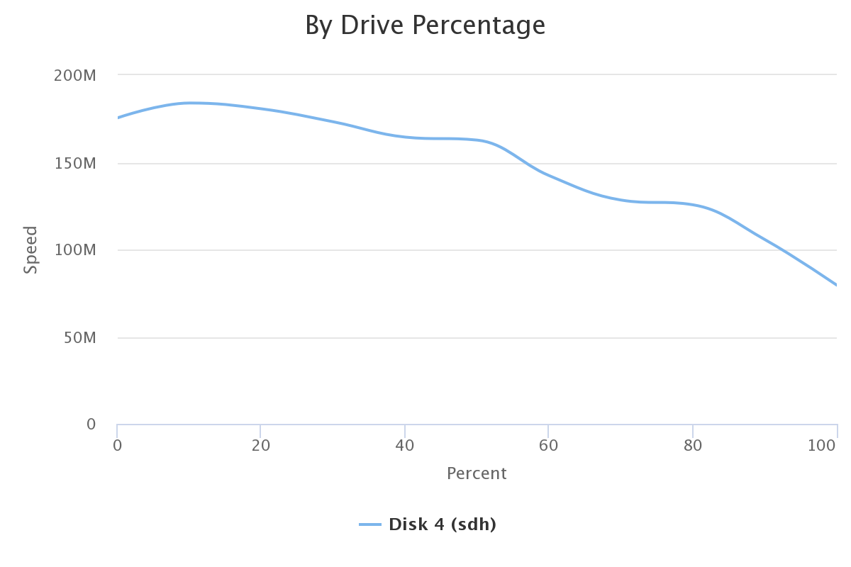

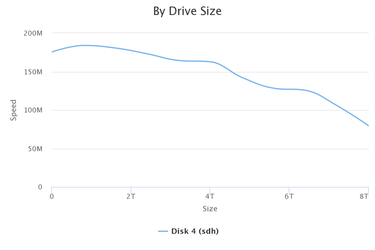

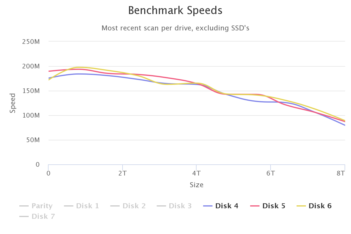

9 hours ago, jbartlett said:
I'd recommend checking out the DiskSpeed docker in my sig once you're back up & running. It can help identify drives that are acting suspect but still reporting All Clear on the SMART report. A standard drive benchmark checking every 10% of the drive as a baseline, every 1% if you want to get down to the nitty gritty.
That's a bit bumpy. Drives tend to gradually drop in speed. Seagate drives also tend to have a dip at the start of the drive. I'd compare it's benchmark with the same model drives in your system.
Disk 5 and 6 are the same models
It's hard to tell which is which. You can click on the drive labels on the other drives to hide them.
Great app BTW.
