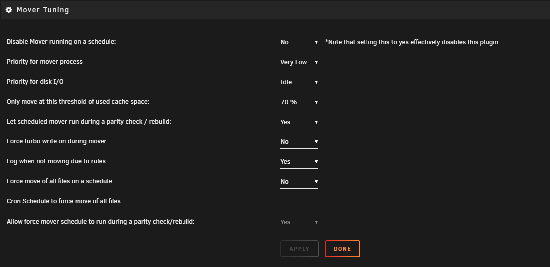

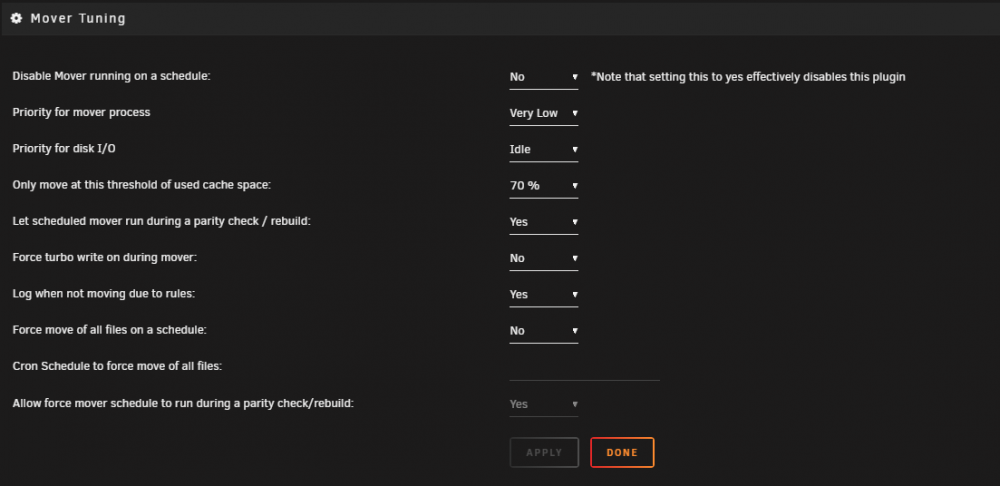

Hi All,
I know some changes took place in the Kernel during the 6.7.0 Update in regards to I/O.
I run Plex on Ethernet from my Unraid Server to my TV and also Direct Play so no Transcoding is taking place.
If Mover is running the Video Pauses every few seconds till it stops.
I have setup Mover Tuner to try and lower the Priority of Mover.
I thought it did work but it turns out it hasn't.
I tried using reconstruction write instead of auto to see if turbo would fix it, but nope it doesn't seem to be a write speed issue.
Plex is also running out of ram for /tmp.
my SSD is an NVME Drive so its not a speed issue on the SSD either.
My settings are attached. So i decided to try rolling back to before 6.7.0 and after a decent amount of testing everything works flawlessly.
Is there anyway to run 6.7.2 with whatever changed before 6.7.0 that broke I/O when mover is running ?
Seems to be a common recently topic we are all having the same issue, so something has changed in the last release update.

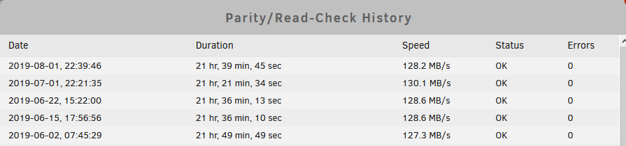

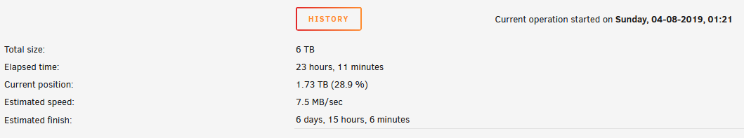

I think the issue extends further. I'm doing a rebuild now, due to having to replace a failing drive, something I have done with UnRaid before. So far it's run for 24 hours and I haven't seen it get higher than 50MB/s. Usually it's in the 20's.
That's significantly slower than I've seen before in this setup.
Might be related.
Here's how it's looking 23 hours in:
And here's the parity check history..
Fairly consistent, IMO.

Two different things. My REBUILD is going excruciatingly slow, but my regular parity check hasn't seen any performance degradation having been stable at 120-130'ish during the period.
The Rebuild is much, much slower than it was a year ago, when I last replaced a failing drive.

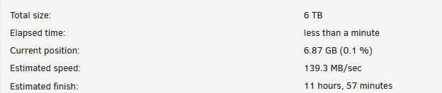

It's now back on-line and the speeds are looking much improved.
