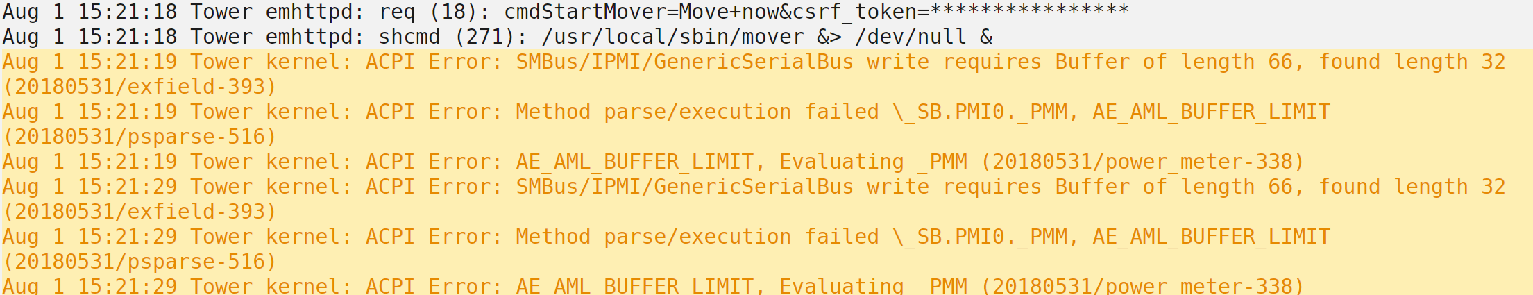

August 1, 20197 yr I noticed a VM I was working on paused itself and refused to unpause. I think it's because my cache drive is full. So I say, "No problem" and click "move now". Nothing happens. Click again. Still nothing. Looking at the log, it doesn't look like anything is happening. I also set the min-free settings as described in this thread (set to 1024kb) and still no luck. I really don't want to reboot as the VM that is paused is right in the middle of a W10 install and I just put the license key in. Don't want to waste the key. (Though, it really doesn't matter...just would rather not.) Anyone have any ideas as to why the mover isn't working? Log: tower-diagnostics-20190801-1527.zip
August 2, 20197 yr Your share M---a exists on the cache drive, but is set to not use the cache. Change it to Use Cache Yes temporarily to clean that up next time mover runs. You can hit "Compute" on the Shares tab next to that share and you'll see how much space it takes up.
