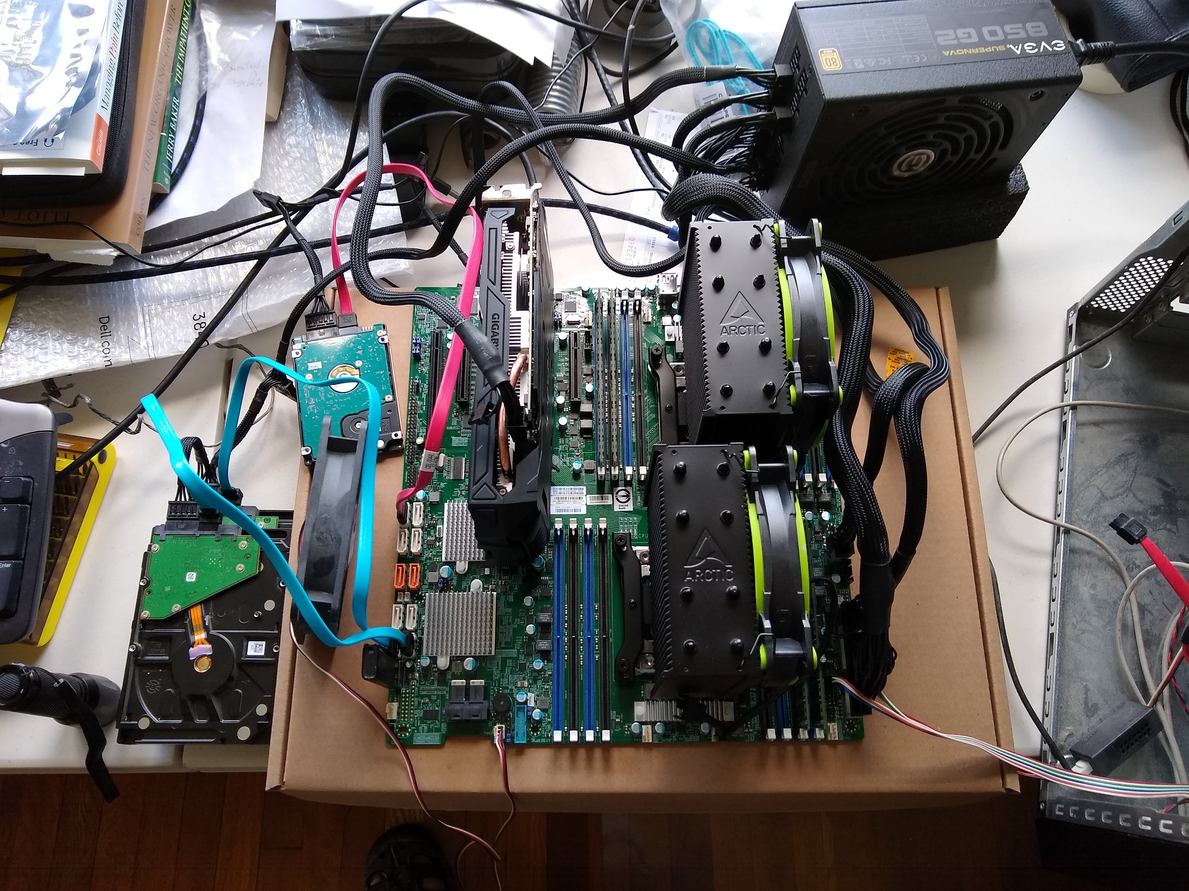

Here is a picture of it on my workbench.  I didn't have a front panel laying around so grabbed as spare tower and used it for testing.

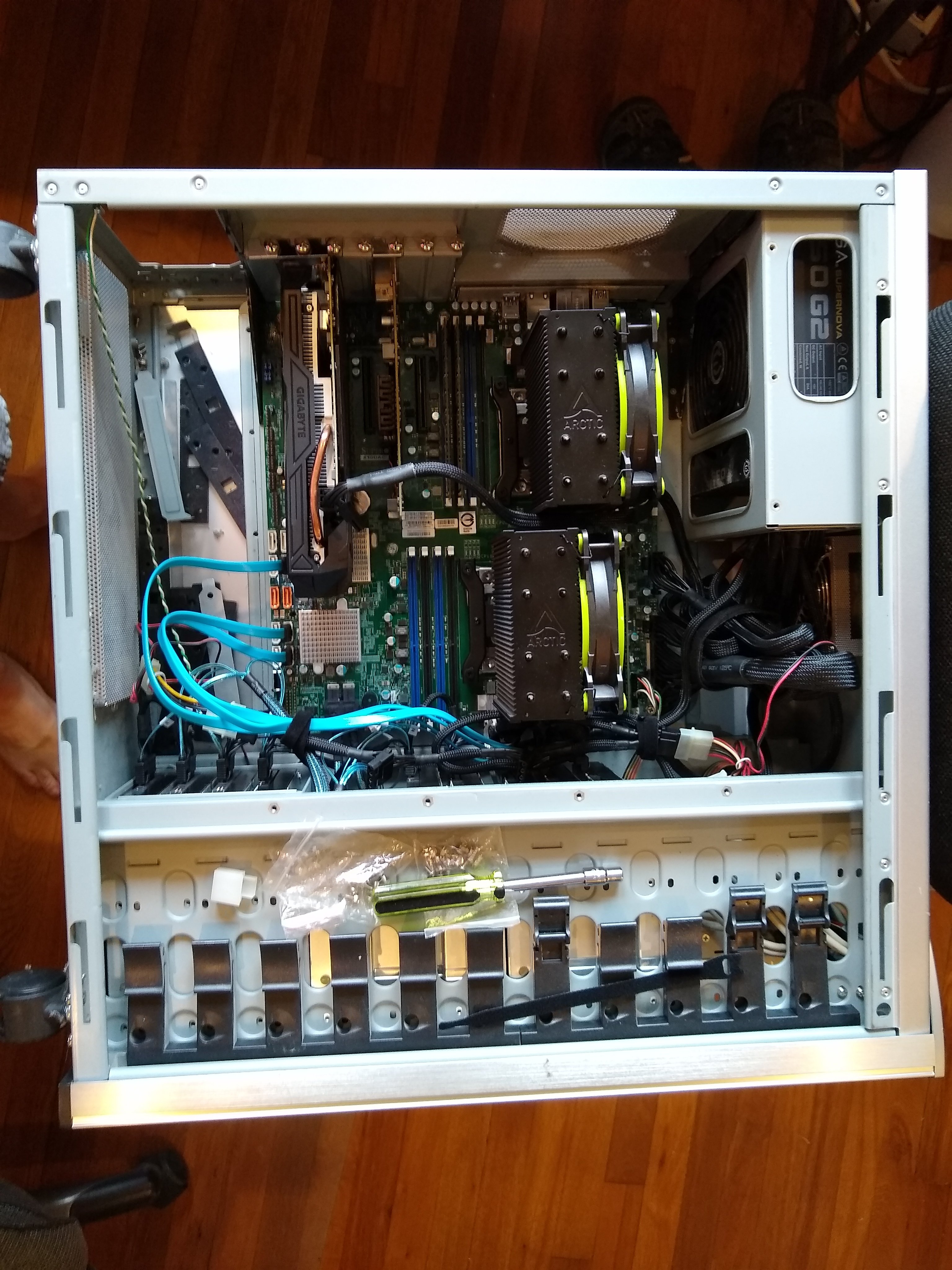

This AM I started to pull my old system a part and replace it with the new hardware.  I pulled the old power supply and MB out.  All I left were the drives.  I then had to reconfigure the stand-offs as I was going from a m-ATX to an e-ATX.  Yep that one little letter means a whole lot!!  My case supports e-ATX, but there were two stand offs that didn't align.  The upper left (by the memory and IO plate) was off by half the bolt thickness.  I could push and prod to see half the thread, but couldn't get the screw in.  I was able to leave the stand off in the system to have it support the board, but no grounding there.  The next was the center top.  For whatever reason there isn't even a stand off any where near here.  I don't know if the standard changed or if my case just came out early (it is my original cooler master I bought when I first built my UnRaid box back in 2002?).
I proceeded to install the power supply/cables, graphic cards and took the time to swap out some 4-in-3 cases with others I had that all match and have a CoolerMaster face plate.  I put both my new GTX 1060 and my old card in the hopes that I could use my old card for UnRaid and then pass the GTX 1060 to Plex.  However after booting I heard 8 beeps and nothing happens.  So I look up beep codes in the MB document and it isn't there.  Hooked my monitor up to the Nvidia card and the screen lit up.  I got an AMI error Out of PCI-E resources.  I've never heard of that. So the swapped the slots of the two cards and rebooted.  8 beeps again.  For some reason it doesn't like both cards at the same time so I ditched the older card.
I had a 4T drive I wanted to put into the system and swap out a 2T drive so I installed that drive as well.  It is now preclearing at 53% done and 153MB/s and at the same time doing a parity check at 150MB/s.  I'm happy with that.  My parity checks previously were 90MB/s.
Here is a picture after I was all done.  I have a hole in the bottom as that is were the second power supply can go.  I only use a single supply now that they are powerful enough.  I wish I had a plate to block it off.
I've ordered a couple more case fans to replace the old ones.  They will be PWM controllable and have places on the MB to plug them in.  Today they are the really old ones that plug into the old style power plug.  I'll be able to pull that power cable out when I get the new fans.

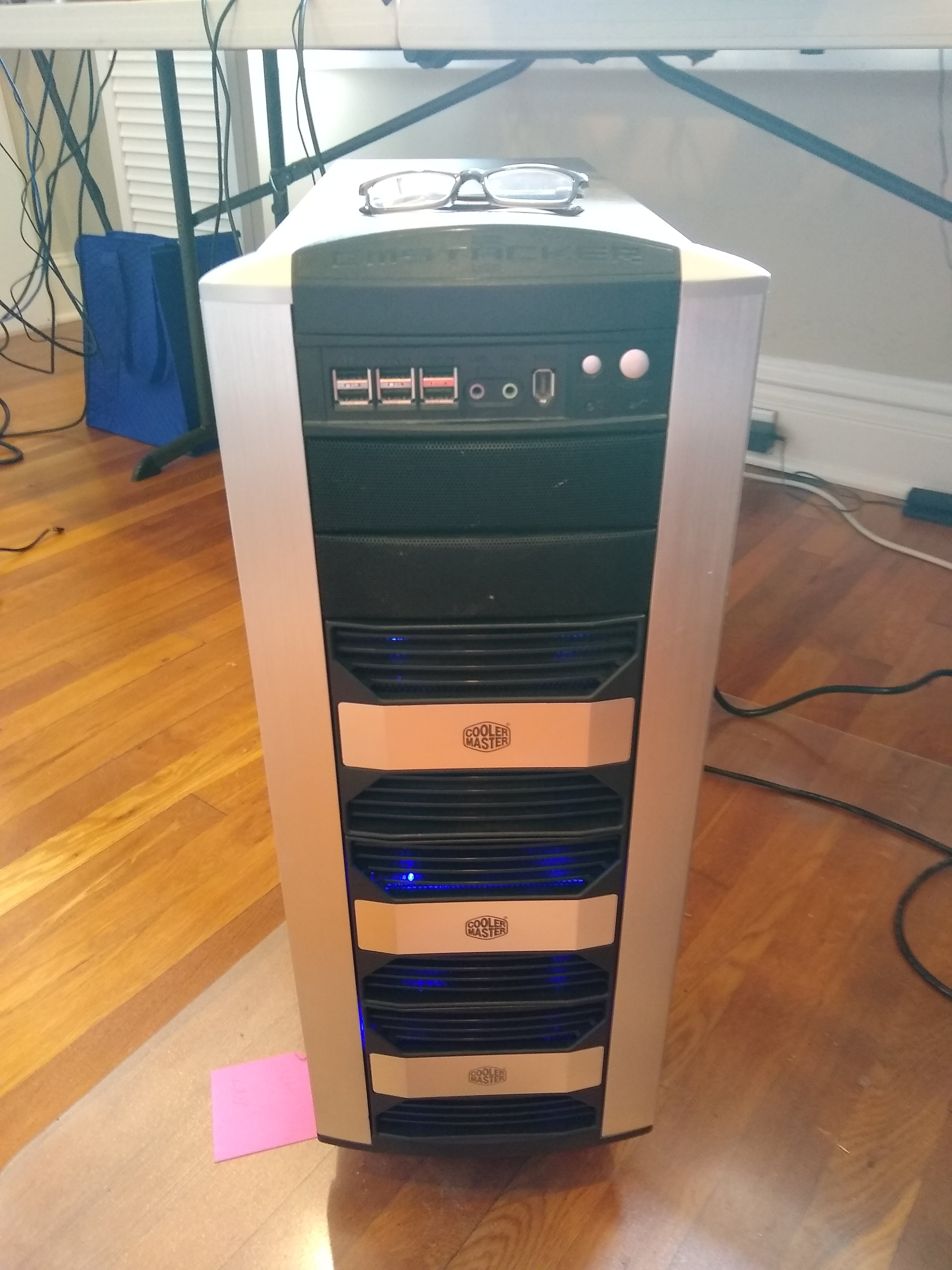

Now the front with matching 4-in-3 bezels.  Yep my 'old man' glasses as I can't see the front panel connections anymore.

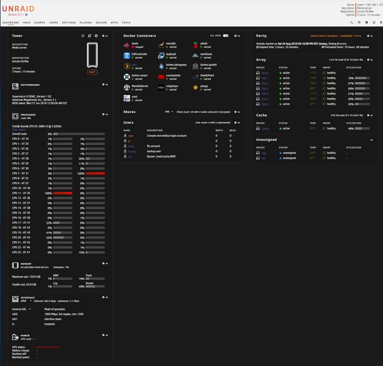

And the best shot of all, the Dashboard

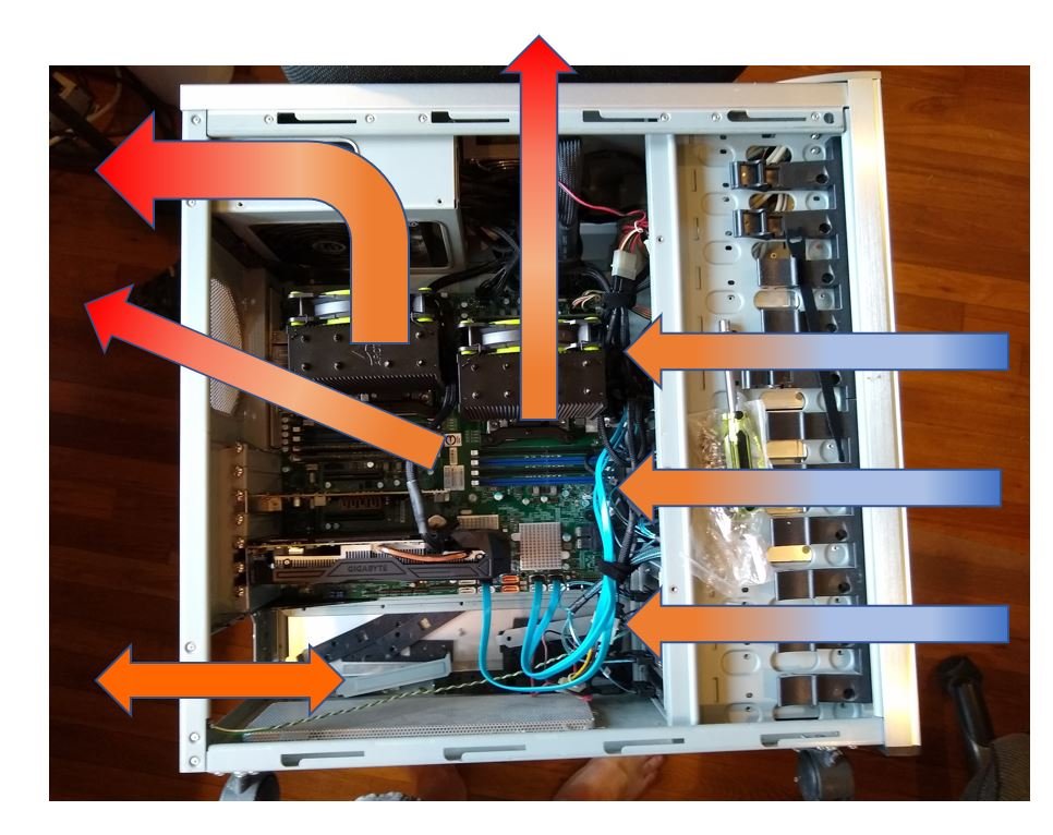

Good question on the airflow.  I did my best to draw it up.  There are 3x120mm fans in the 4-in-3 adapters, one 80mm fan in the top, the power supplies fan and the 120mm in the back of the case.  The final fan is an 80mm in the side panel that brings in fresh air immediately below the cpu fans. The CPU fans move air upwards.
If the hole doesn't have a fan forcing air out, it needs to be blocked off. Otherwise your exhaust fans will just be getting make up air from the open holes instead of pulling air over the drives. The only place that should allow incoming air is through the drives.
Clear packing tape is good for sealing up holes.
There are fans in front of the drives pulling air in from the outside and over them.
As I have 3x120mm fans pulling in fresh air and only 2 exhausting air,  I suspect that air exits the hole in the bottom.  I'll test that out and see.
Edited by lovingHDTV
At CPU part, why don't push air (install fan in opposite side) instead pull air.
Edited by Benson
I doubt that very much. Air follows the path of least resistance. If the intake fans are being properly ducted so none of the air can bypass direct contact with the drives, the number of fans doesn't much matter. It takes a lot of force to push air through the small passages beside the drives, so if there is an easier path bypassing the drives, that's where the air will go. It's your job to constrain that air and make it go where you need it to move the heat. In a server with a load of drives, the first priority is the drive wall, then the CPU, hard drive controller, memory, motherboard, and GPU.
If you don't duct the flow where you need it, you will end up with a lot of flow that bypasses all the critical components, and pockets of heat that don't escape.
I tested the hole and can't discern which direction the air is flowing. It isn't extreme in any condition.  I'm not too worried as it has been functioning for 12 years this way. It has been on my list to block off, but obviously not very high up on the list :)
