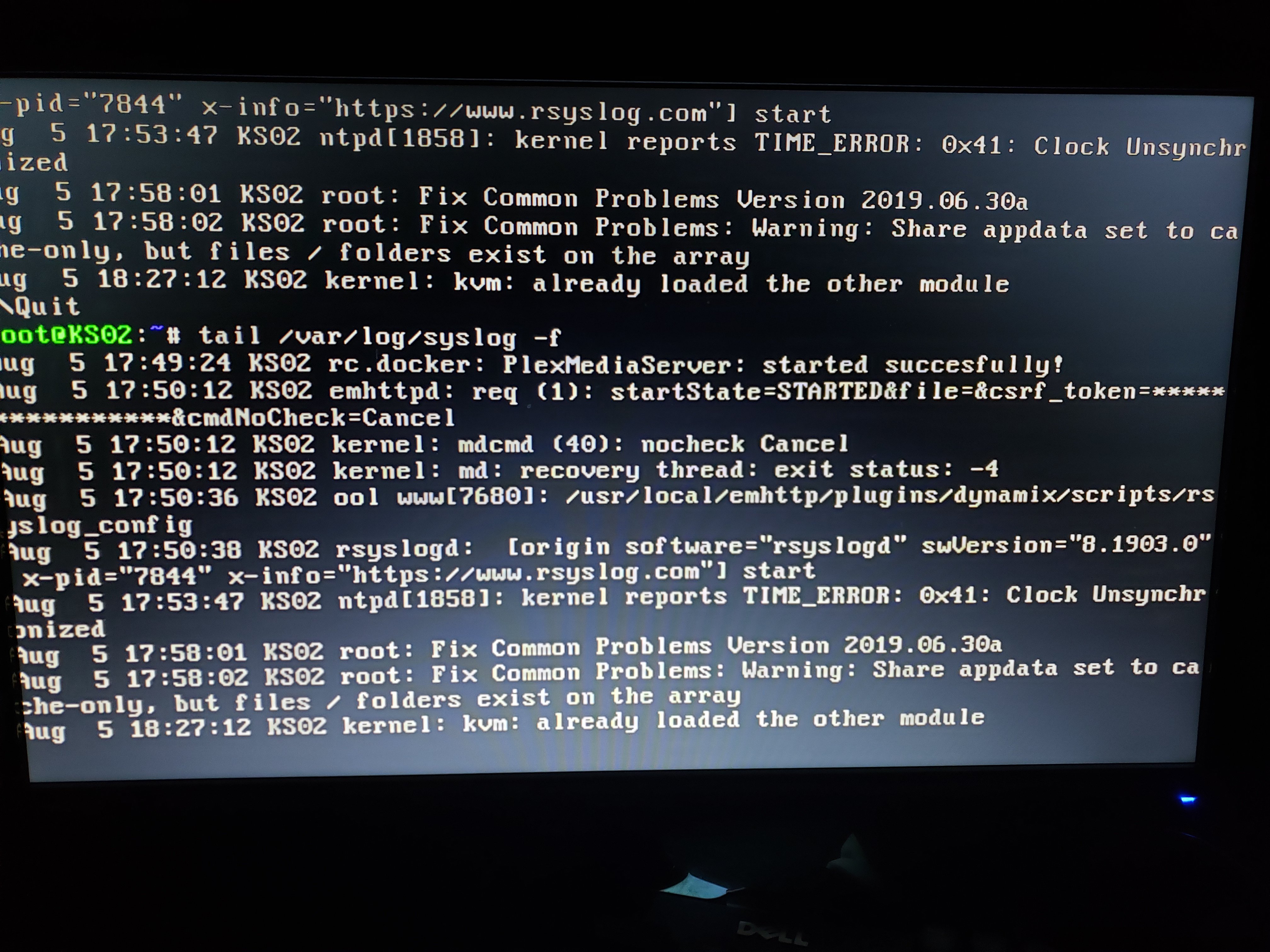

Thank you for getting back to me so quickly, sorry it took so long to reply back. Here is an image of what was last on the screen, I also rebooted the server and pulled the log files and added them as well.

Ok, so the image I'm looking at is of a crashed server?  I don't see any errors in the log to indicate a crash or anything.
If that's the case, then it's most likely not a software bug causing the crashing.  If the server was working fine for years no problem and this just happened "all of the sudden", maybe a little PC maintenance is in order?  Airdusting, check cable connections, ensure good airflow.
