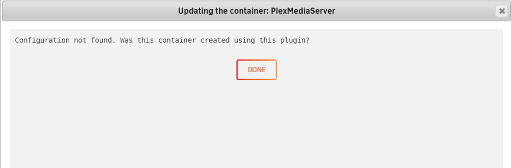

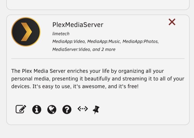

Hi all, as I added some files to my server today, I wanted to update plex media to add these in.
To my surprise, the "Web UI" option was not available from plex in the docker page.
I noticed there was an "update ready" message, and though maybe it needed to update. I tried doing that but I get a message that reads:
"Configuration not found. Was this container created using this plugin?"
I came across this thread: https://forums.unraid.net/topic/38974-support-limetechs-docker-repository/?page=11
I tried doing what IO saw there, and deleted the docker.cfg and .img files, but when I went to rebuild from "previous apps", nothing was shown to choose...
Luckily I had backed up the files so I just copied them back and rebooted and everything is still there, but I still have the initial problem of no Web UI option (I can though access if I go manually) and I cannot update, receiving the same message.
What could be wrong? This was working fine and haven't changed anything.
Thanks.

I tried doing this today and it did not work.
I has worked fine in the past but now I get this:

This is what I got when trying to run as explained adding some name/description:
Command:root@localhost:# /usr/local/emhttp/plugins/dynamix.docker.manager/scripts/docker run -d --name='Test' --net='bridge' -e TZ="America/Buenos_Aires" -e HOST_OS="Unraid" 'Test'
/usr/bin/docker: invalid reference format: repository name must be lowercase.
See '/usr/bin/docker run --help'.
The command failed.

Everything was working fine, and today after no updates, no changes etc., suddenly my plex apps cannot connect anymore, saying my media server is not available.
Trying to connect locally I get "500 internal server error" (or course tried restart, reboot, and power down/up).
After a restart of the docker, the log shows the following:

Hmm maybe I have the wrong one? On the dashboard screen there is a “log” check that open a popup windows with a log.
The one I have is this one on the pic
That is the LimeTech version of the Plex docker not LSIO. You’ll need to post in that thread. Click the docker icon and select support.
Thanks for the reply and sorry for the confusion.
Seems in my lack of understanding I actually did post on the right thread too on sunday, but have not received any replies, so guess will have to wait it out a bit.
Out of curiosity, what are the differences? Aren’t they both plex or what else am I ignorant of?
Primarily the support system. LSIO is much more active.
