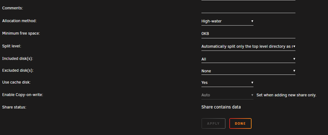

I have all the shares set to 'High-Water', with 'Only split the top level...'
This is storing TV shows, so it is Share -> TVSeriesFolder -> Seasons -> TVFiles.
It is my understanding that with this setup, if all series are the same size, alternate TVSeriesFolder. However this has filled up the first disk and now has only really started to fill up the next disk, some files where written, but only about 150GB before the first disk was filled.
Distribution of files across 2 disks.
All other shares have the same settings.
Share settings
I have another disk ready to add, but if this is not working correctly I want to hold off.
Is there a problem with my settings that I'm missing?

With this setting all seasons of the same show will go to the original show disk, so that might be your problem, if you change to split top two levels a new season can go to a new disk, but note that any existing incomplete season folder wil need to be moved manully, or else Unraid will still try to make it go there.
Mover won't move anything if there's not enough space according to current split level, disk1 is full and likely it's trying to move data there, assuming use cache setting is correct.

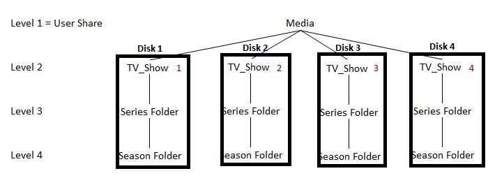

I'm trying to have it so each TVSeries is as a whole on one disc, but the system tries to keep the system balanced. What you are talking about is that TVSeries1 has seasons spread all over the disks.
Is High-Water with Top Level not how to do this?

Split level overrides allocation method.
And that's what the split level you're using will do, but like mentioned it will override allocation method, so if you have a tv show with 3 seasons on disk1, and disk1 is now full, you can't add any more seasons to that show with that split level.

I already answered that, current setting will keep all seasons of a show on the same disk, it will never split seasons from the same show, so once a disk is full you can't add any more seasons to an existing show, if that's what you want it's correct.
I started with 2 empty disks. With the settings my understanding (simplifying this) is that it would copy 1 series to a disk, then next series to a different disk, then all following series to what ever disk has (roughly) the most space and repeat until done.
However, all shows went to one disk, and keep doing so. It is working like "Fill-up" not "High-Water". Am i missing something here.
Ignore the fact its at 100% thing of it one is at 50% and one at 0%, and it keeps writing to 50%.
Is it, I have the wrong settings, or is there another issue?
That's not what High-water does, you need "most free" for that, but still will never split seasons.
