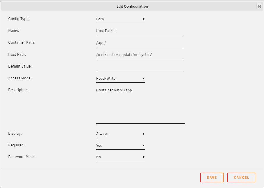

For the appdata folder being empty, I went back to that link and it says that the volume should be /app, not /embystat.
As for connection through the browser not working, it looks like it's looking for port 80 based on the logs you provided "Now listening on: http://[::]:80".  I don't really know if that's the problem or not, but that's the next thing I would try.  Change the port on the container side to 80, like, "-p 6555:80"
59 minutes ago, dee31797 said:
Hi mbc0,
Thanks for that, I changed to /app but now get this error on startup and the docker stops

This is a tough one!
I may have guessed wrong with the /app, again from the link, the container path may need to be more specific like /app/Settings etc. Sorry about that!
info from docker hub:
Volumes
Following list can be mounted so files can be access locally
/app/Logs
/app/Database
/app/Settings
ok, interesting! I changed back to /embystat (from /app) and container running again!
