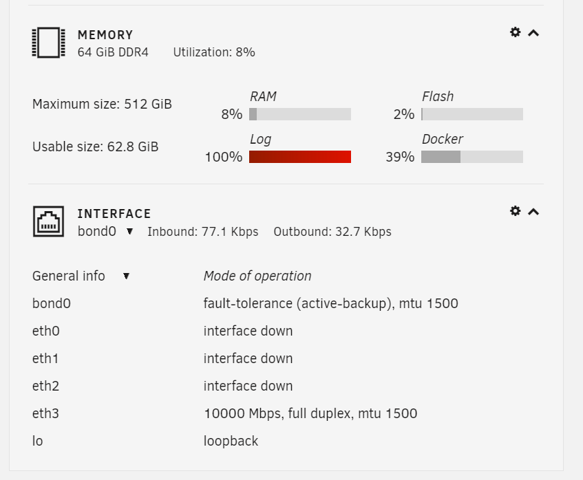

Interesting... I just noticed this. I'm certain the LOG shouldn't be 100%
