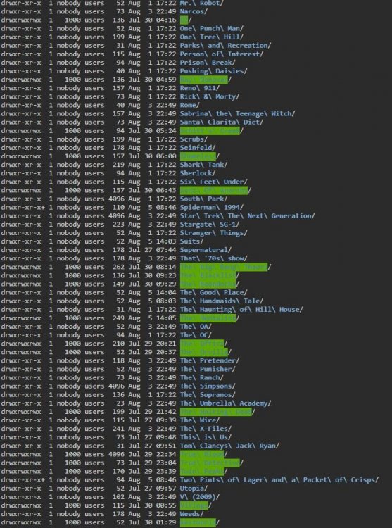

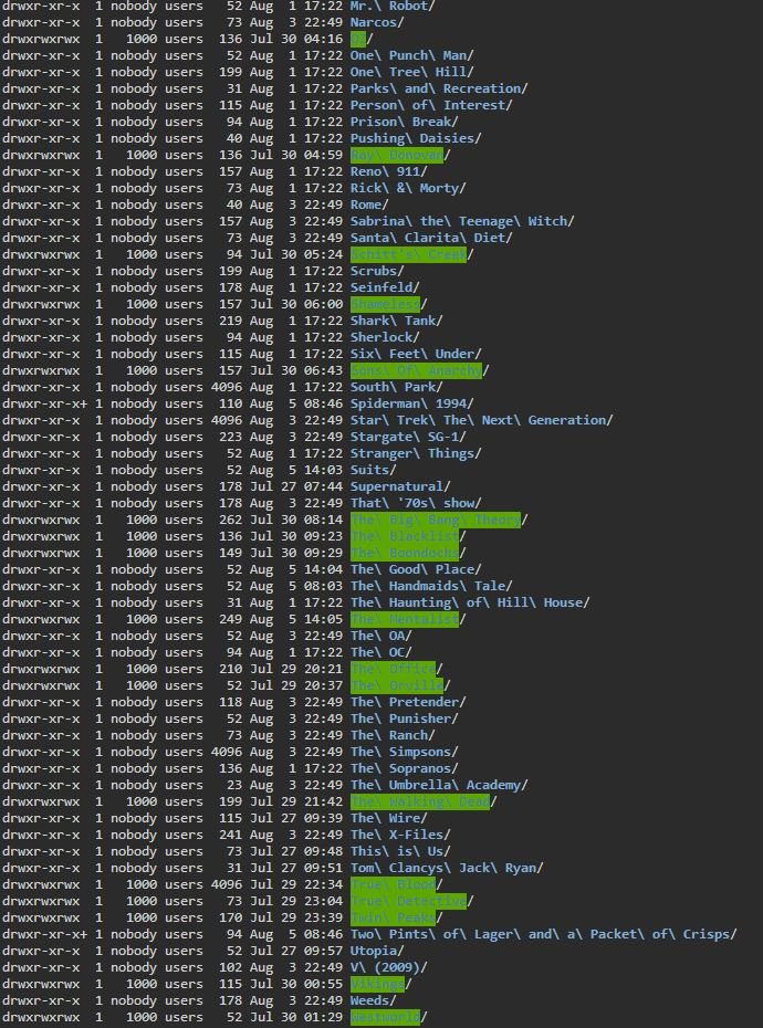

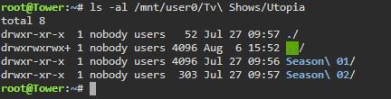

Ran the first cmds, results attached.
For the third one, I chose a random one, since they all behave the same.
Chose the TV Shows Share. Not sure what it means but some of them are in a different color as you can see.
So reading from the post you linked, I guess it means that my docker wrongly assigns permissions on those shares to "nobody" who is actually ... nobody !
I don't see any difference with the "Movies" share though but now that I think about it, I created that share while running another Plex Docker, which turned out to not work properly so I then got a different one. Which could explain why that share works !
BTW using Plex Docker: plexinc/pms-docker

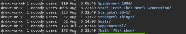

Notice the absence of the w's for the Owner and Other in the permissions in these entries:
And with these entries, the Owner is wrong!  It must be nobody
Read this post again and then read the balance of the thread carefully as your problem is only a slight variation of the situation discussed
You can temporarily fix this problem by running the Docker Safe New Permissions script (A part of the Fix Common Problems plugin and found on the Tools menu).

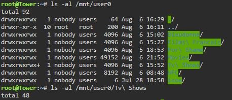

So after a bit more testing, the above only kinda worked.
I was able to create folders in some of the shares but not others. Or in my TV Shows shares for example, I could create a folder for a new show but I couldn't create a folder in an existing show's folder ( to add a season for example ).
I had to do some more research and found a definite solution:
chmod -R 7 /mnt/user0
This set up a Read/Write/Execute permission on all my shares. Did some extensive testing and it's working perfectly !
Cheers !
This is part of the operation of the Docker Safe New Perms script.  It also includes the code which will fix the Owner and Group names.   Most of us who are trying to help folks out like  try to avoid the use of the Linux command line to actually fix problems.  It is far too easy to really make a mess of things because Linux assumes that when you ask it to perform an operation, you know exactly what the result of that task will be.  Making a small syntax error can do an unbelievable amount of damage!

This path explicitly does not include anything on cache. The more general path would be /mnt/user (no zero).
Probably best not to muck about with the command line until you get a better idea how things work. Unraid is linux, but you can't assume everything always works the way you might expect from other linux distros. For example, the entire OS is in RAM. Any changes you make to the usual linux OS folders and files will not survive a reboot.
