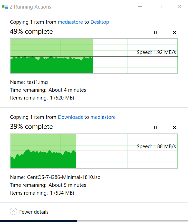

August 7, 20197 yr Author I know it is still doing its rebuild, but this is pretty typical of the read speeds I have been seeing and I also do not see any I/O issues in the logs. diagnostics-20190807-0301.zip
August 7, 20197 yr Community Expert If you have a rebuild running then I would EXPECT any copying speeds to be terrible!
August 7, 20197 yr Community Expert 9 hours ago, itimpi said: If you have a rebuild running then I would EXPECT any copying speeds to be terrible! And the rebuild speed will also be affected by the copying. Wait for rebuild to complete before doing any more testing.
