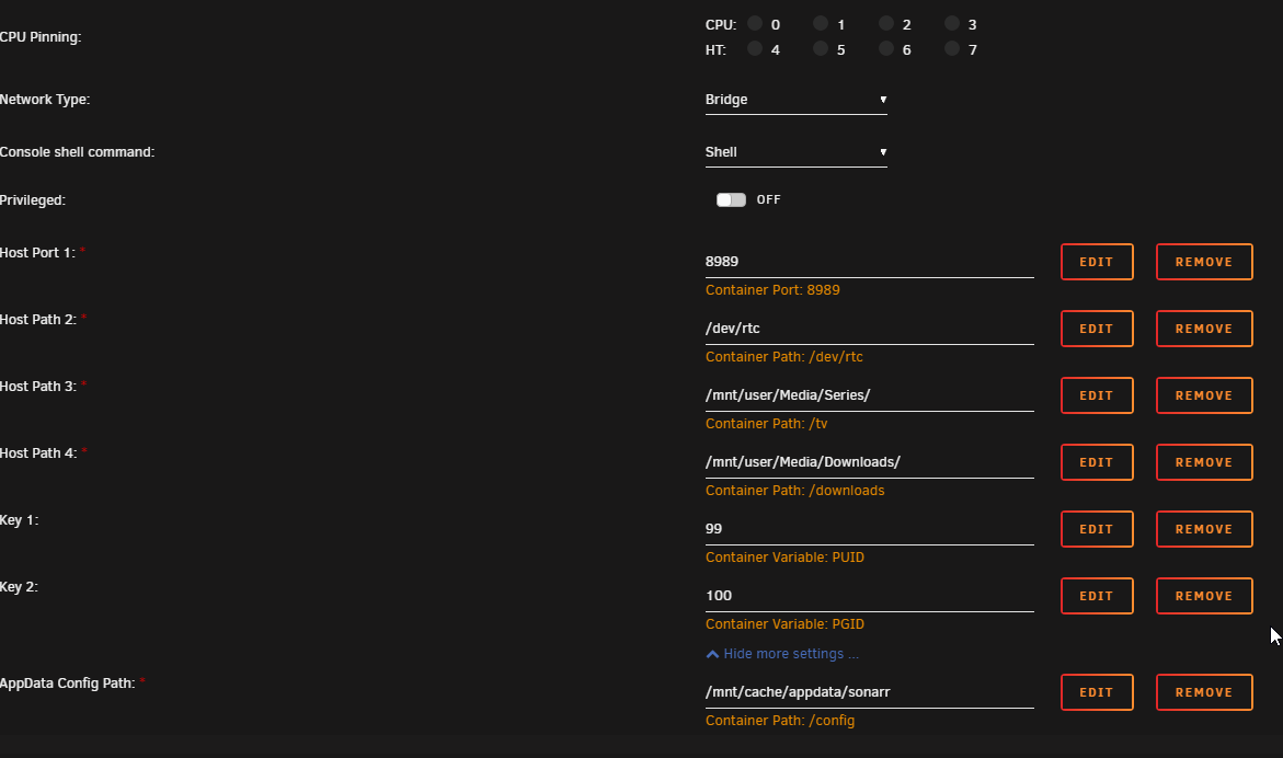

A restart of the docker seems to help and I find no errors in the error log. What can the issue be? This is the configuration I have set on my share mappings on my Sonarr container:

Showing config on 1 docker won't help much because the issue might very well be in a different docker.
Also, you are having downloads in the array. That's highly not recommended.
What I mean by loose is when I use the console to connect to the docker container and try to change directory to the /downloads folder that is mapped to my array I get an error that it does not exist. I did not know that you are not supposed to map downloads folders to the array? How are you supposed to do it then? Just have it all saved permanatly in the cache drive a seperate share?
