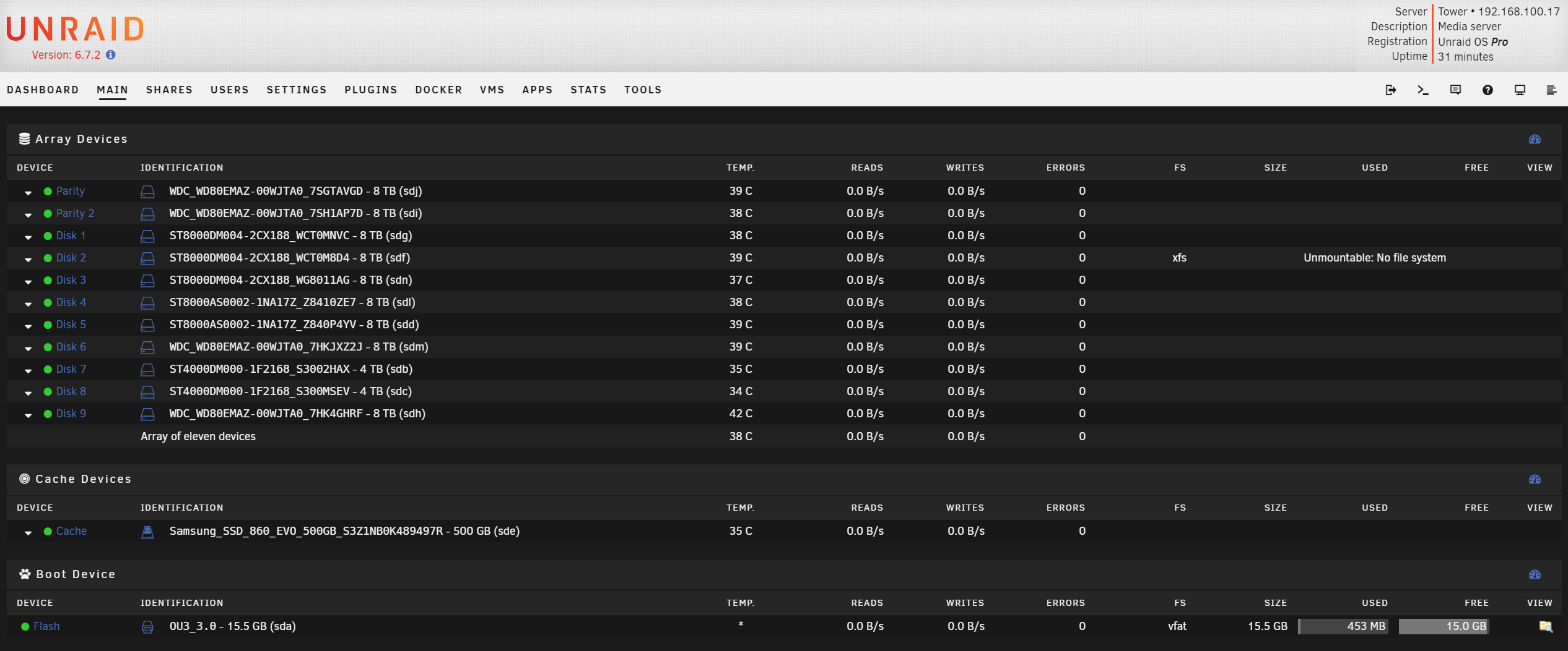

August 7, 20197 yr Hi, I got the error (Unmountable: No file system) on Disk 2 the same time when Disk 1 was rebuilding. (After facing this issue) I waited for Disk 1 rebuild to finish, then restart the array/server, but the Unmountable message on Disk 2 still appears. I went through this documentation and executed this command (-nv) in maintenance mode and got the below response: Phase 1 - find and verify superblock... - block cache size set to 707800 entries Phase 2 - using internal log - zero log... zero_log: head block 654523 tail block 654519 ALERT: The filesystem has valuable metadata changes in a log which is being ignored because the -n option was used. Expect spurious inconsistencies which may be resolved by first mounting the filesystem to replay the log. - scan filesystem freespace and inode maps... - found root inode chunk Phase 3 - for each AG... - scan (but don't clear) agi unlinked lists... - process known inodes and perform inode discovery... - agno = 0 - agno = 1 - agno = 2 - agno = 3 - agno = 4 - agno = 5 - agno = 6 - agno = 7 - process newly discovered inodes... Phase 4 - check for duplicate blocks... - setting up duplicate extent list... - check for inodes claiming duplicate blocks... - agno = 0 - agno = 3 - agno = 6 - agno = 1 - agno = 2 - agno = 4 - agno = 7 - agno = 5 No modify flag set, skipping phase 5 Phase 6 - check inode connectivity... - traversing filesystem ... - agno = 0 - agno = 1 - agno = 2 - agno = 3 - agno = 4 - agno = 5 - agno = 6 - agno = 7 - traversal finished ... - moving disconnected inodes to lost+found ... Phase 7 - verify link counts... Maximum metadata LSN (1:654601) is ahead of log (1:654523). Would format log to cycle 4. No modify flag set, skipping filesystem flush and exiting. XFS_REPAIR Summary Wed Aug 7 21:00:27 2019 Phase Start End Duration Phase 1: 08/07 21:00:13 08/07 21:00:13 Phase 2: 08/07 21:00:13 08/07 21:00:14 1 second Phase 3: 08/07 21:00:14 08/07 21:00:21 7 seconds Phase 4: 08/07 21:00:21 08/07 21:00:21 Phase 5: Skipped Phase 6: 08/07 21:00:21 08/07 21:00:27 6 seconds Phase 7: 08/07 21:00:27 08/07 21:00:27 Total run time: 14 seconds I would like your suggestion in how I can proceed with fixing this issue? Please let me know if you require any further information. Thank you. Unraid Version: 6.7.2 CPU: AMD Ryzen 7 2700X Mobo: MSI X470 GAMING PLUS (MS-7B79) Memory: 16 GiB DDR4 tower-diagnostics-20190807-1747.zip tower-smart-20190807-2047.zip Edited August 7, 20197 yr by HAMANY
August 7, 20197 yr Community Expert You should rerun the xfs_repair without the -n option but add the -L option. After doing that the disk should be mountable again.
August 7, 20197 yr Author 4 hours ago, itimpi said: You should rerun the xfs_repair without the -n option but add the -L option. After doing that the disk should be mountable again. Thank you. The disk is back to normal now
