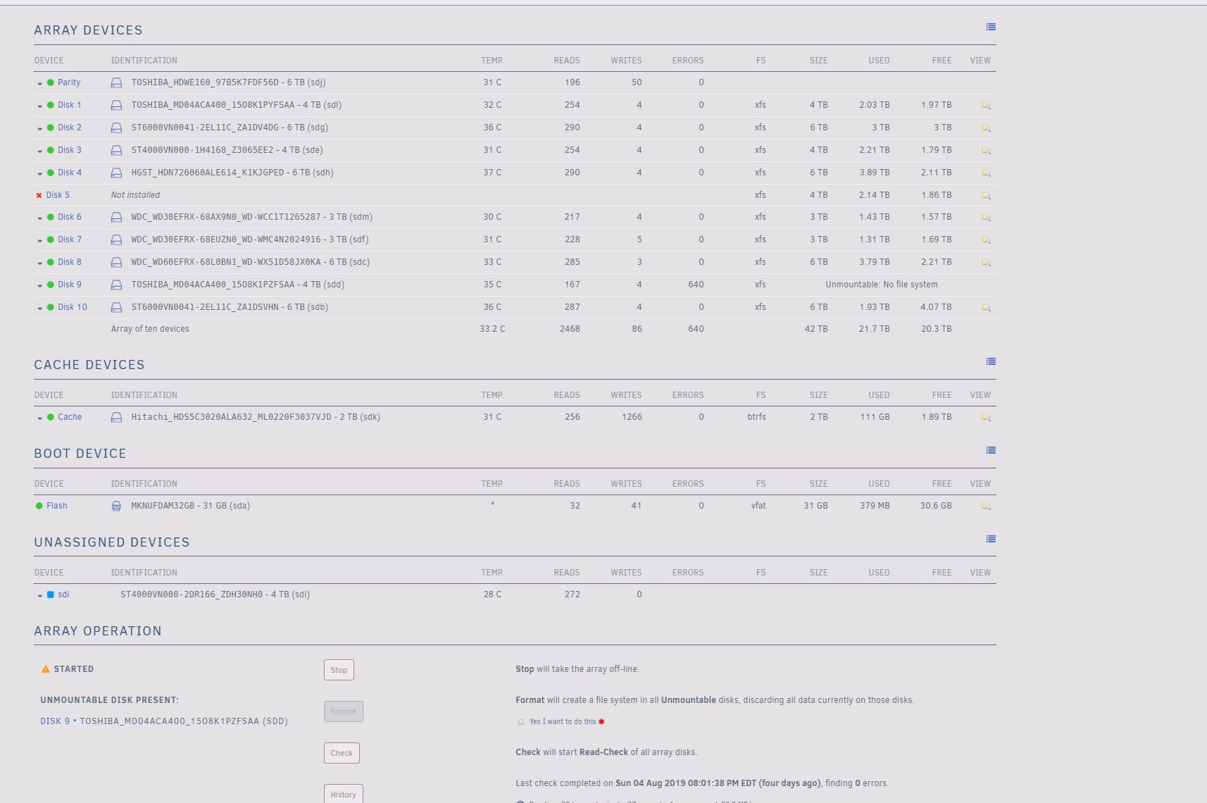

After an Extended power outage I lost one drive Failed, and another with a Unmountable: No file system errorr.

Disk9 appears to have dropped offline. Check connections.
Emulated disk5 is mounted. You should be able to rebuild it. Are you sure the disk is bad? Was it the Unassigned Device sdi?
I checked the connections and swapped the cables.
Disk 5 was failed Red X, and now is the Unassigned Device sdi
Think that happened after a few reboots
Both look like connection problems, check/replace cables for both, disk9 should then mount and just rebuild disk5, if the emulated disk still mounts.
I Just replaced them both with 2 brand new cable. Got 9 back, added 5 back to the Array and it is rebuilding.
