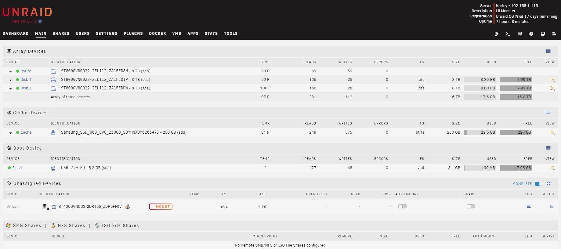

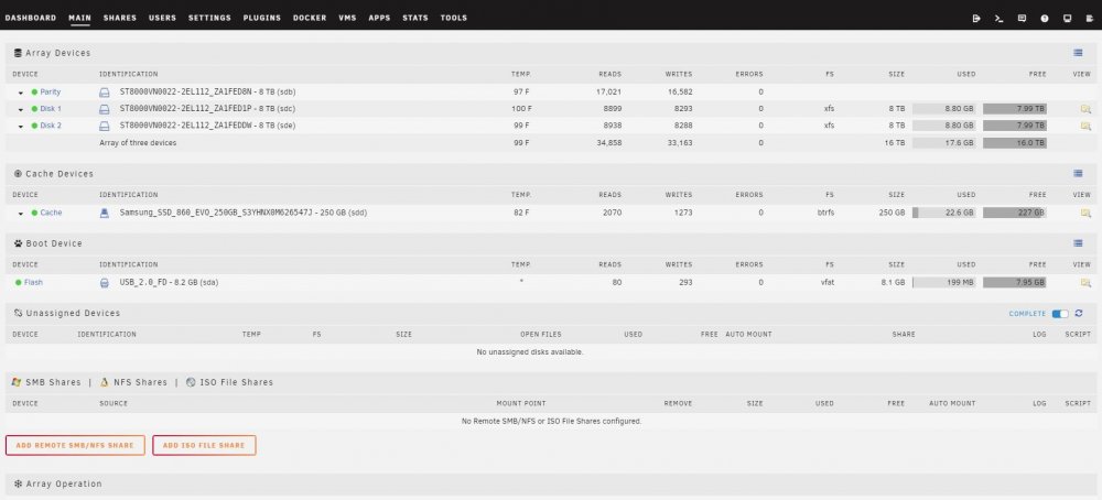

I'm not sure if this has to do with the latest UPDATE but here's the issue.
When hot swapping a drive in the past; the drive would immediately show up as an Unassigned_Devices and now, they don't!
I've tried the following:
Plugged drives into all the available bays, nothing.
Deleted Unassigned_Devices and Reinstalled, nothing.
The only thing that works is to [ REBOOT ] the server.

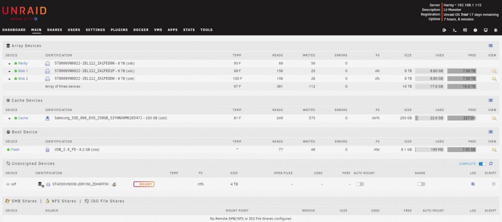

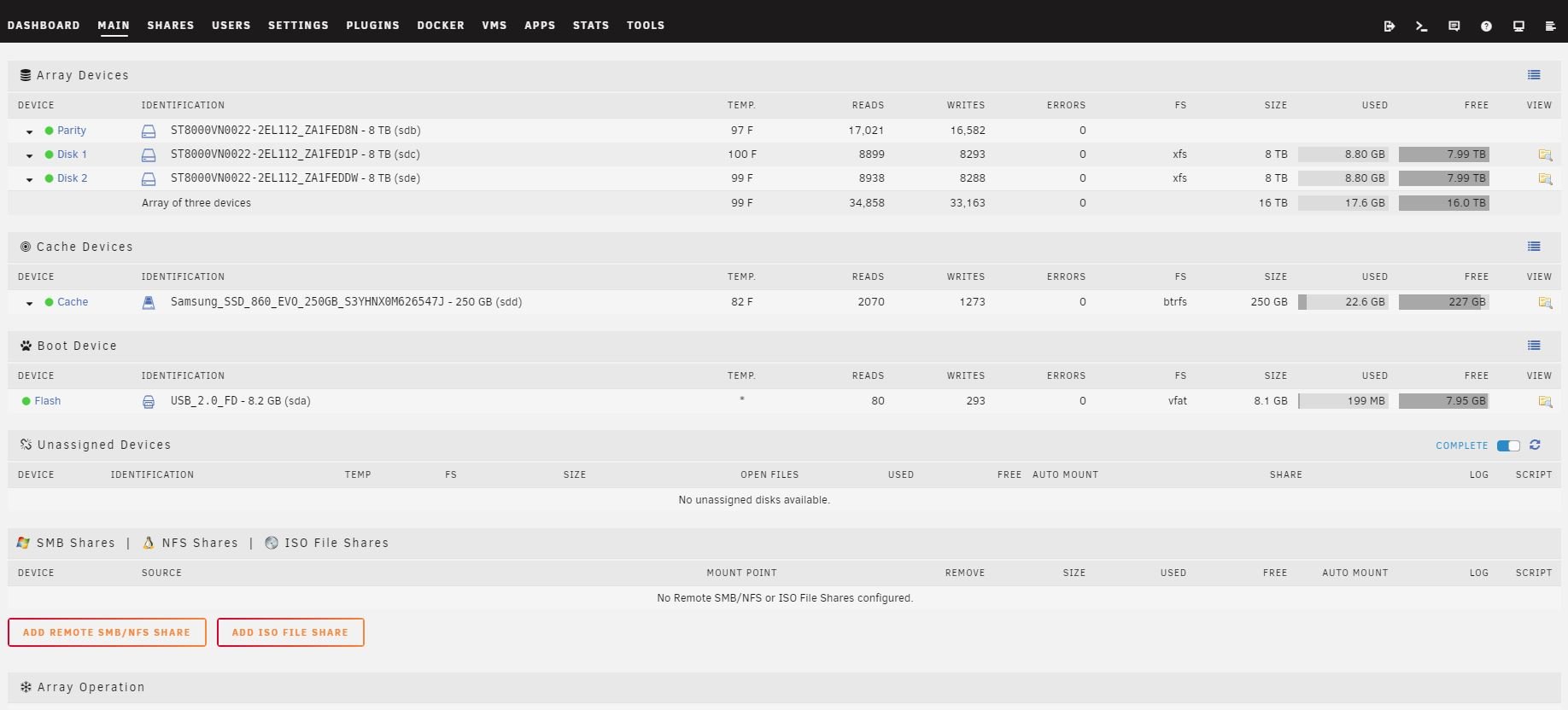

As you can see a before and after screenshot. Before, the reboot, NO DRIVE, after the REBOOT the drive miraculously appears ready to be MOUNTED.
Any help would be greatly appreciated!

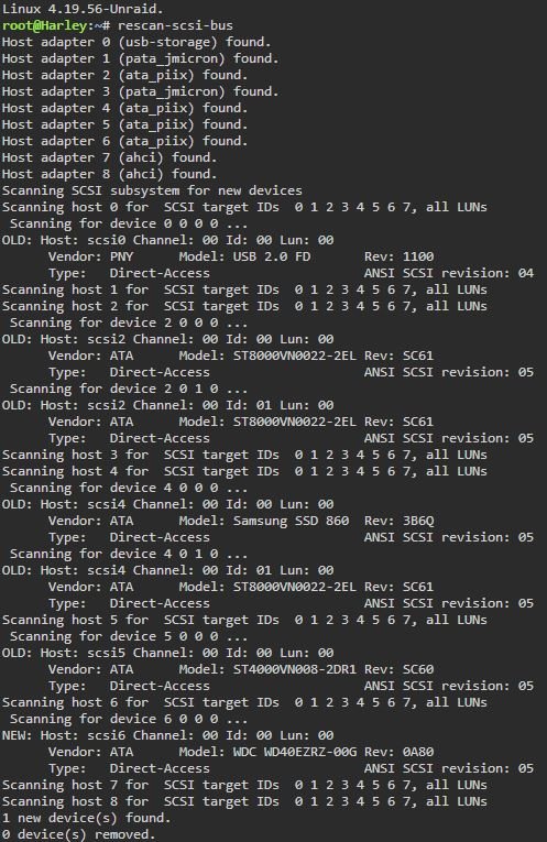

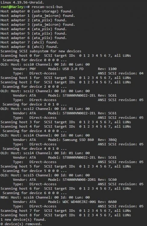

Try this in console
rescan-scsi-bus
Thank you.  I will give that a shot and report back.  I wonder what is the cause of the issue.
Thanks testdasi! Worked! Screencaps attached.

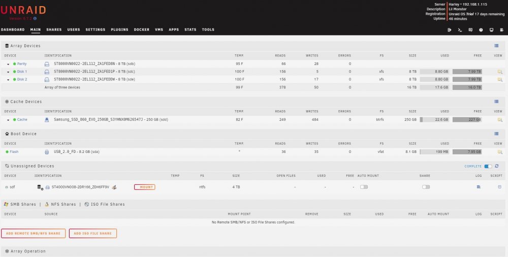

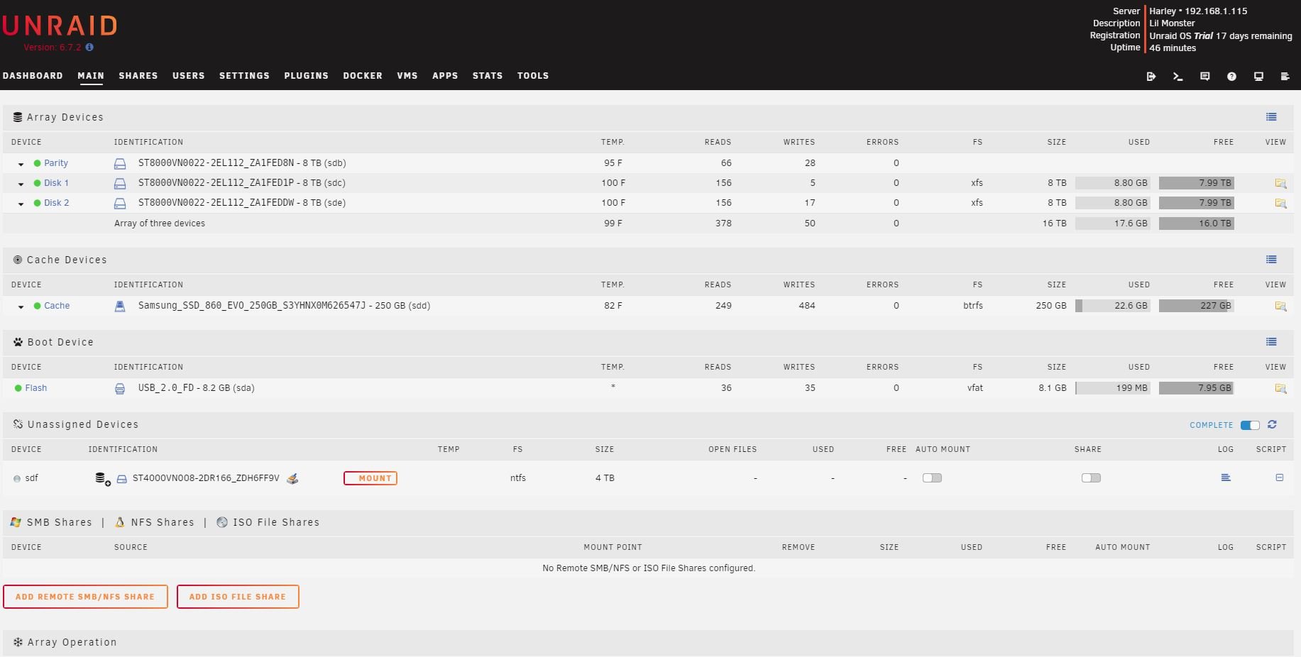

1. 4th drive installed and does not show up
2. 4th drive installed and rescan-scsi-bus was executed.

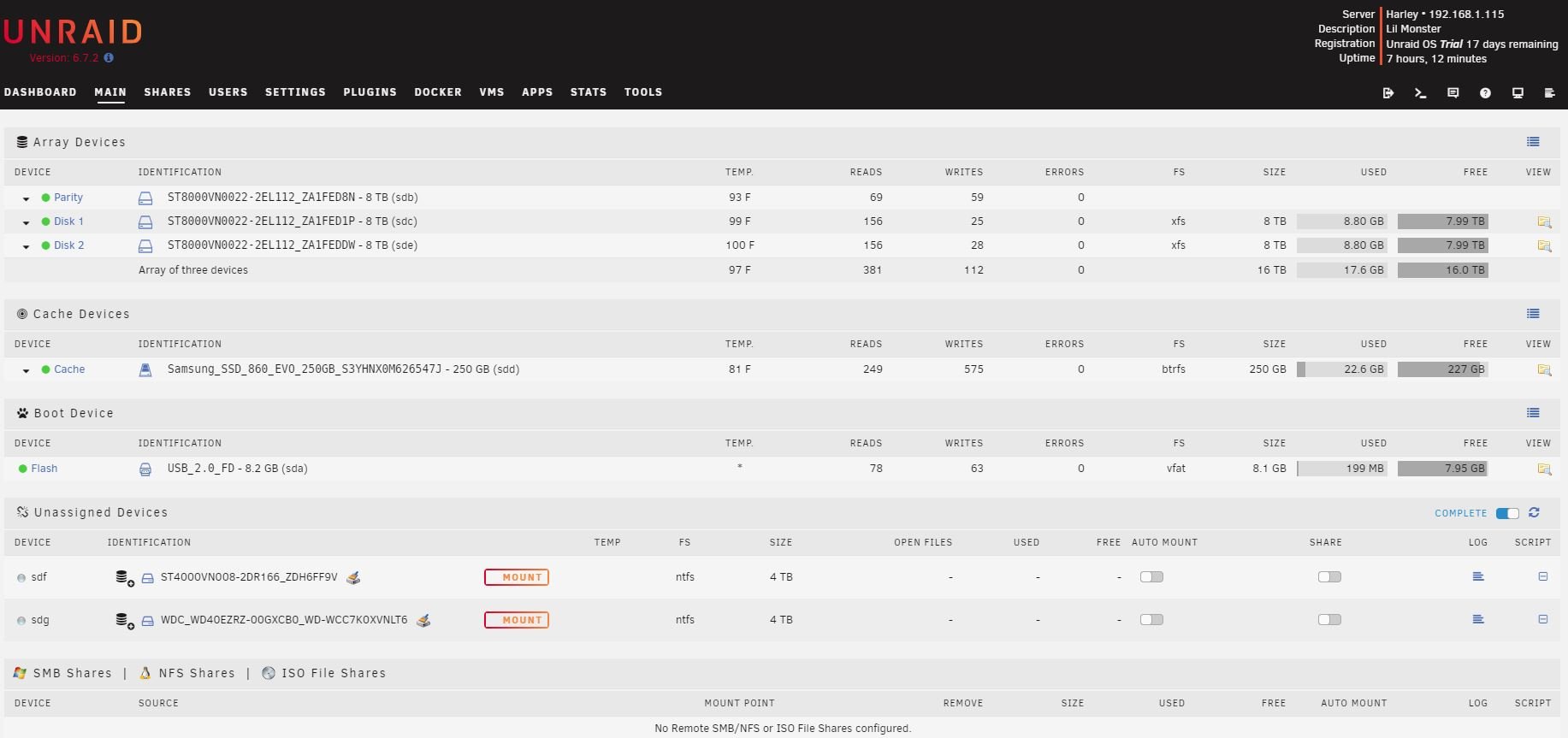

3. 4th now shows up as an Unassigned_Device
