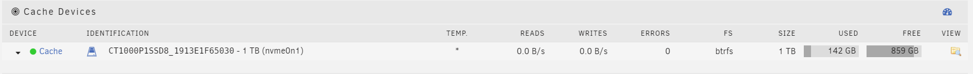

I'm running 9 or so dockers on the SSD, and have my downloads folder caching. SSD Trim and Folder Caching apps from CA are running. I stress tested it a bit when I migrated my Plex metadata folder onto it (over 300,000 small files). It shot up to 70 degrees C pretty quickly, but I've seen that from M.2 drives before so I didn't think anything of it. The first time this happened was during the Plex migration. It seized up and froze me out of several areas of the WebUI for Unraid, like dockers, VMs, and the dashboard. Required a cold boot to come back online. It appears like this now:
I can view the contents of it, but cannot access them. Docker appears to be running my containers, but none of them are accessible.
I'm fairly certain this is a bad SSD, but I wanted to see if anyone has experienced anything that could be causing this in the OS.
