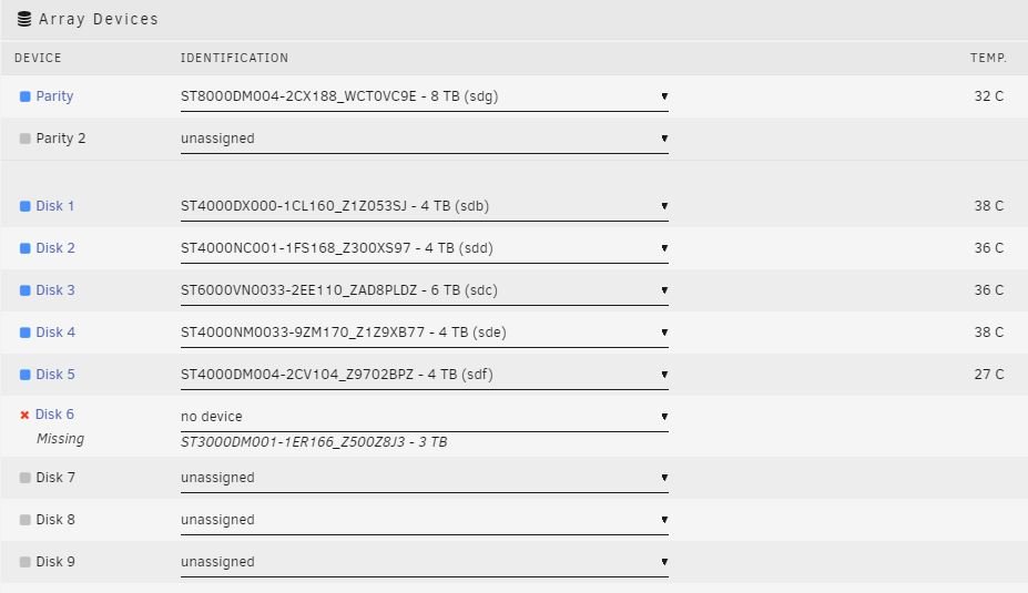

i actually have all the drives in the same positions they where in last time i was able to run the tests. after the last reboot, it says "stopped, invalid expression" and "You may not add new disk(s) and also remove existing disk(s)." I did throw an old disk in to see if i could recover data from it, and its showing as disk 6, missing. wondering if that has something to do with it. Also, I just noticed that the array thinks all these disks are new disks; showing blue squares next to them.

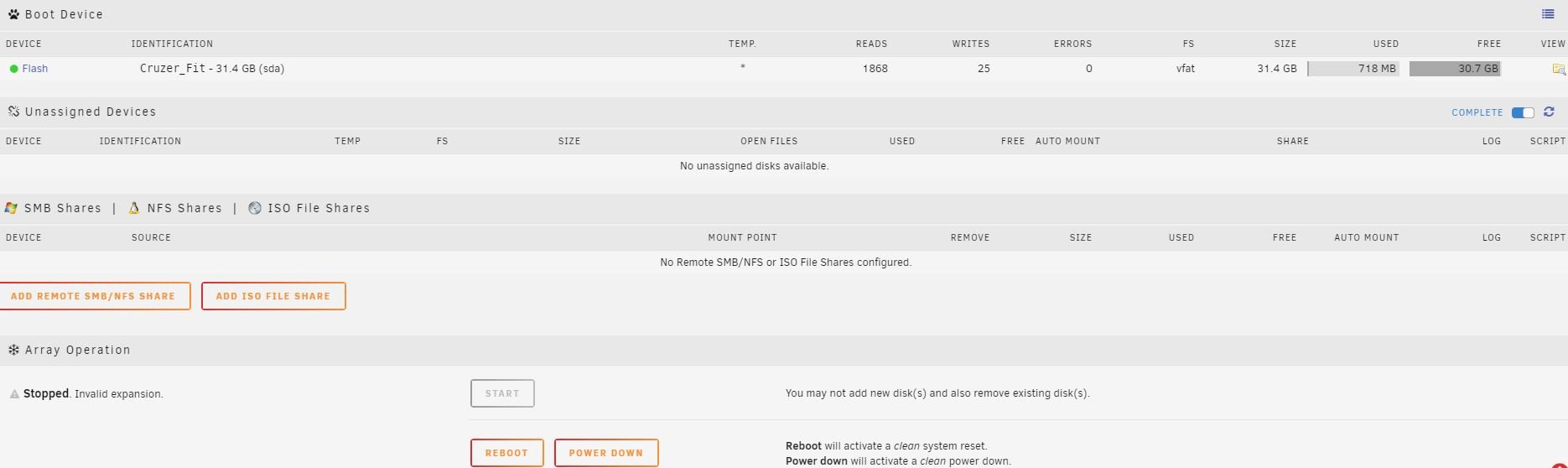

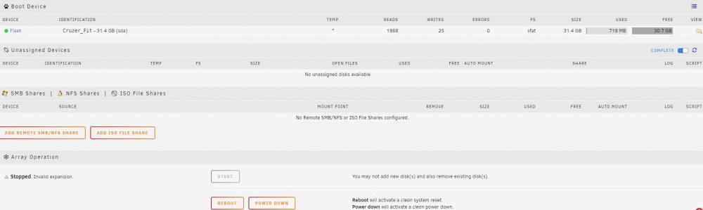

Post screenshots of Main - Array Devices, Main - Unassigned Devices, and Main - Array Operations.
And post a new diagnostic.
ok... I took all the disks that where part of the array, and mounted and shared them using "unassigned devices"

that disk 6, i placed in the disk 6 position by mistake, and haven't remembered how to remove it.
