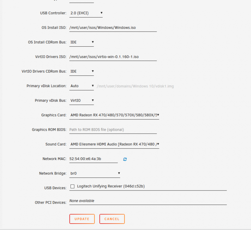

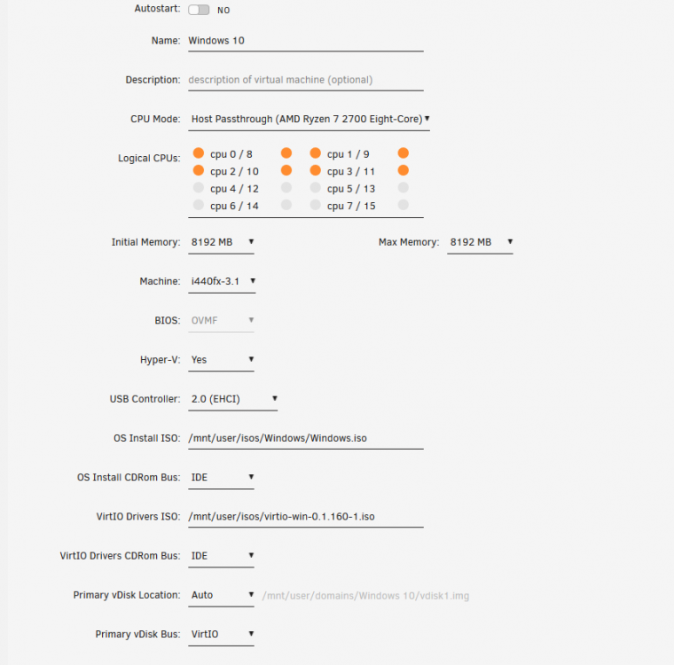

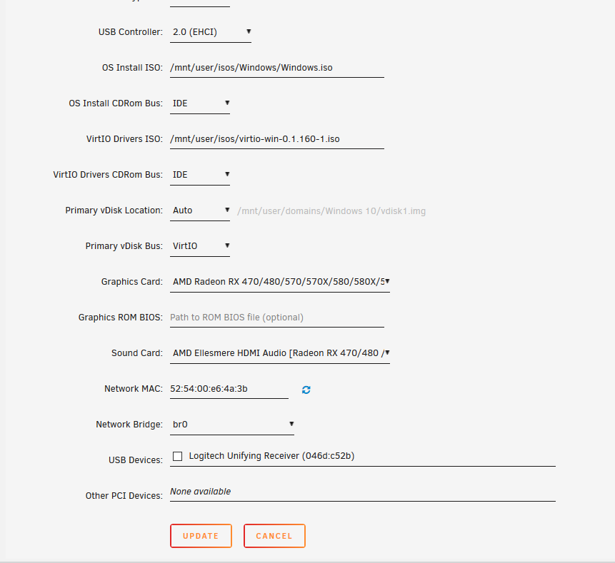

I have been struggling with getting my msi rx580 oc to passthrough to my VM windows 10 PC. I read through the boards to get the best configuration, esp since my GPU supports UEFI, it appears. When switching from VNC, to my RX580 for video and sound, my screen goes dark, forcing my to reboot the system to get my monitor back.
It appears I shouldnt need 2 GPUs to accomplish passthough. I downloaded the rom for the RX580 from techpowerup. Also switched on/off hyperv and used with no rom. Any ideas what I am missing here?
I attached my VM config below:
thanks for the help, I really like unraid thus far.

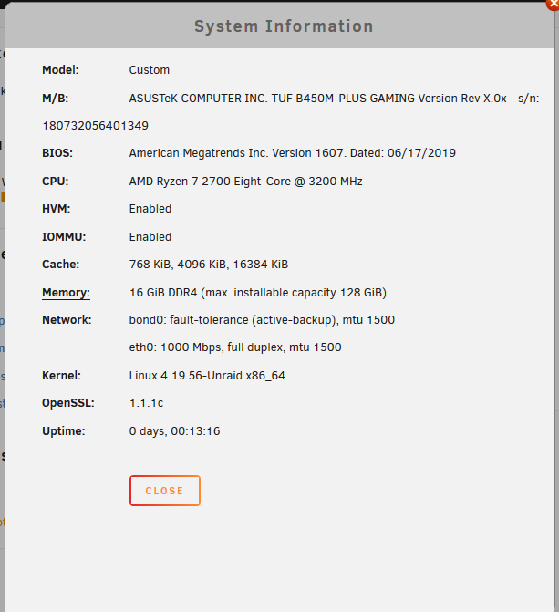

to add more to my post system detail wise, see attached.

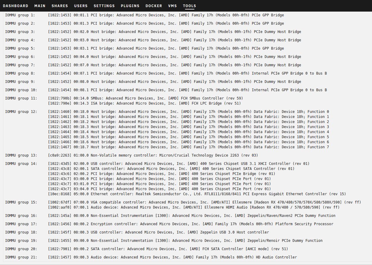

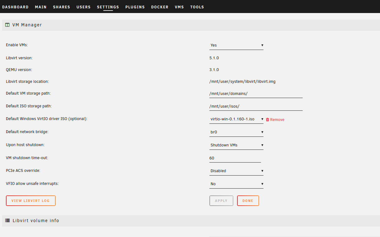

Virtualization and IOMMU are enabled on the host.
Unraid v6.7.2
Also rx580 is in it's own IOMMU group (group 15)

1 hour ago, sec787 said:
Unable to power on device, stuck in D3
