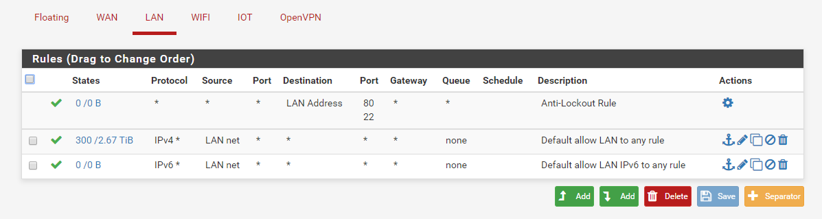

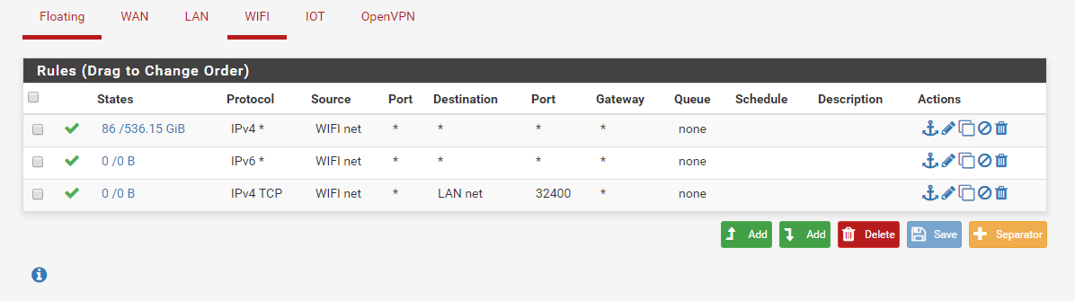

So the two networks are LAN and WIFI.
Rules for the LAN VLAN
Rules for the WiFi VLAN
Pretty basic... but firewalls aren't my forte. Anything showing up as horribly wrong? I can ping and access everything else between those two networks including dockers etc... there is just something with the webservice traffic that is getting dropped or blocked somewhere.
