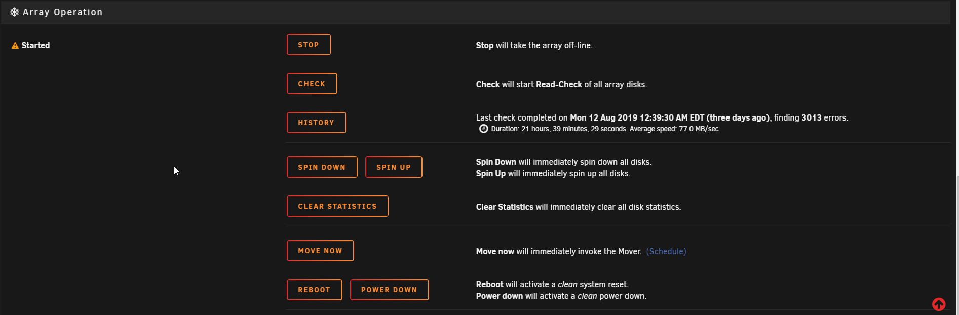

Let us know what is happening now and post a new diagnostics and screenshots of Main - Array Devices and Main - Array Operations.

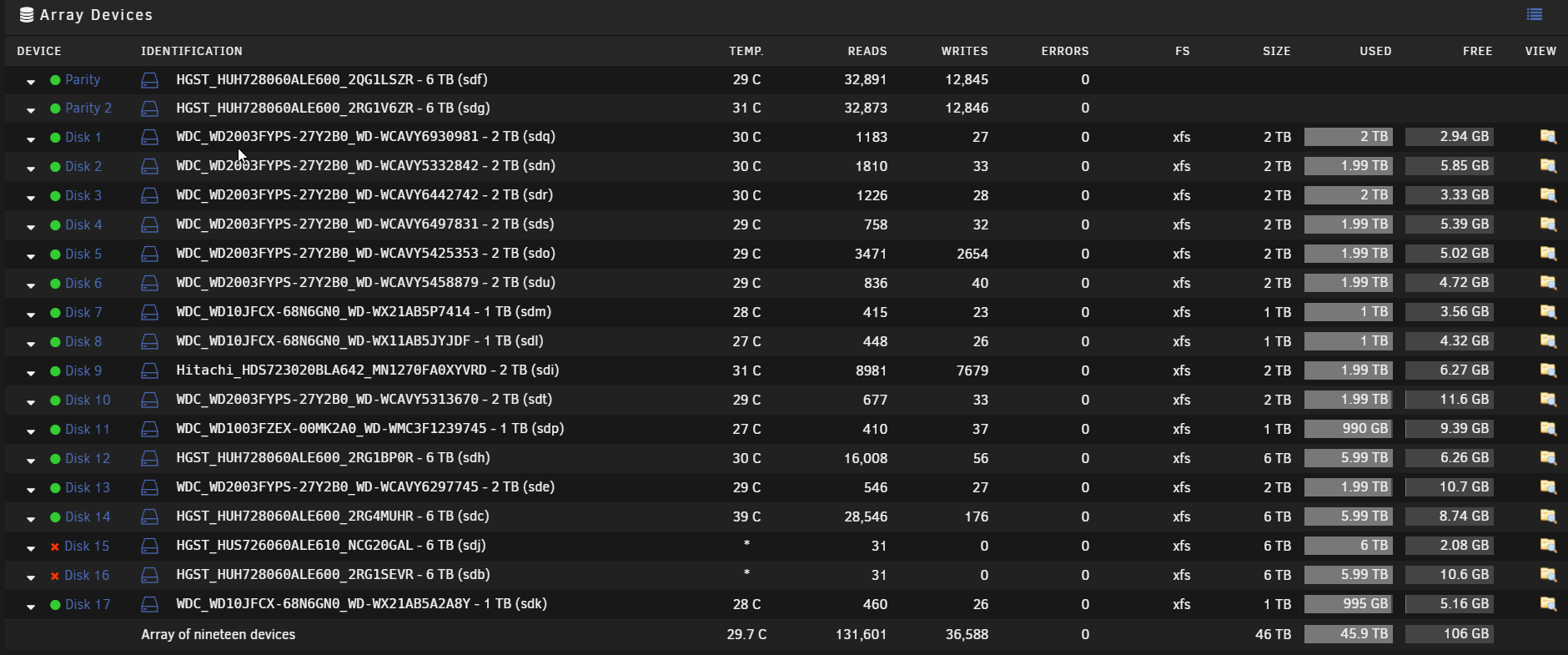

Here you go.
image.thumb.png.195ac59161e760c6fe5b6d5d857d0054.pngimage.thumb.png.f68c1f97d0cd8b066dca147e57a60f3f.png

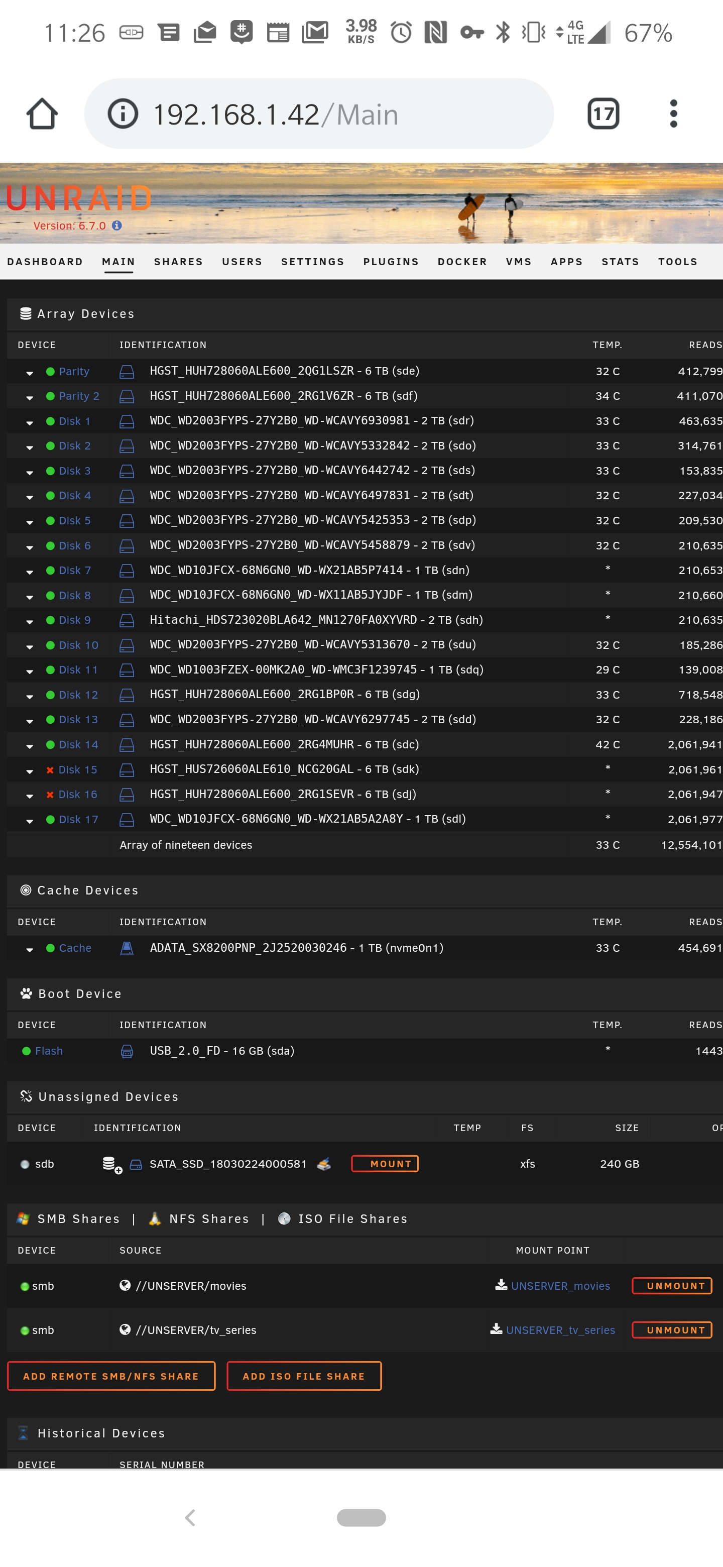

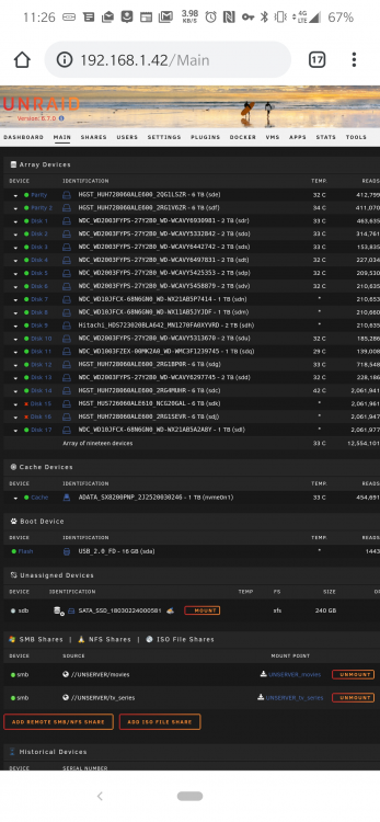

Originally, my array looked like this (this is from 11:26 AM 8/14/19, about 12 hours ago): image.thumb.png.815892f235c39cd5ee64b0a6036c62ce.png
After moving two 6tb drives inside my server from my external enclosure, and starting the array in maint. mode, all the drives with missing temps went back to normal, except the two actually disabled drives. At the time, those two emulated drives said they needed to be formatted as the file systems couldn't be mounted. After running the xfs_repair option on them removing the -n flag, it gave me the output I quoted originally but still wouldn't enable the drive, and the emulated drive still needed to be formatted.
I never removed any of the drives from the array at this point yet. I rebooted to see if that would re-enable the disks to no avail.
I then started the array in maint. mode again, stopped it, unassigned disks 15 and 16, (no starting of the array in between) re-assigned them, then restarted the array in maint. mode. At that point I got the notification that both disks had returned to normal operation. I assume it meant the emulated disks, as I stopped the array, and the disks were still showing as disabled, but when I started the array in normal mode, the emulated disks were mounted with the physical disks still disabled.
I hope this clears any confusion up.
I can't tell from that last screenshot whether the emulated disks were mounted or not because it is clipped on the right where it would show.
The other screenshot in your earlier post seems to show the emulated disks are mounted, and so you say. If that is the case then it should be OK to rebuild them. If you browse the emulate disks you should be able to see their contents.

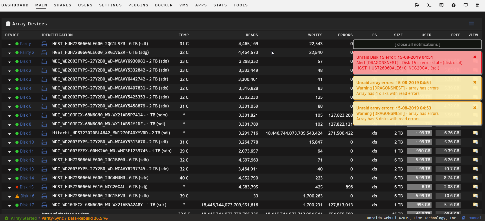

Problem with the enclosure/port multiplier dropped all disks connected:
Aug 15 04:50:25 DragonsNest kernel: ata8.15: Port Multiplier detaching
Aug 15 04:50:25 DragonsNest kernel: ata8.00: disabled
Aug 15 04:50:25 DragonsNest kernel: ata8.01: disabled
Aug 15 04:50:25 DragonsNest kernel: ata8.02: disabled
Aug 15 04:50:25 DragonsNest kernel: ata8.03: disabled
You should really avoid SATA port multipliers with Unraid.
20 minutes ago, IDontBelongHere said:
I'm now getting tons of read errors on multiple drives.
Of course that is going to compromise the rebuilds. Probably we should have suggested rebuilding to new disks so you didn't mess with the originals.
I guess you can check connections of those disks and try again, but
