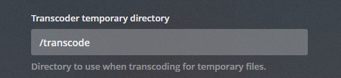

August 15, 20197 yr Author thanks @testdasi for the reply. but I have one question first with the Plex Trancoding I have just looked within my Plex settings, and I see for the Host Path 2, that it is pointing to /tmp is this the same as type of thing as your script ? if not then can you point me to how to add the Bash script at boot up/ and with in Plex
August 15, 20197 yr 26 minutes ago, chris_netsmart said: thanks @testdasi for the reply. but I have one question first with the Plex Trancoding I have just looked within my Plex settings, and I see for the Host Path 2, that it is pointing to /tmp is this the same as type of thing as your script ? if not then can you point me to how to add the Bash script at boot up/ and with in Plex You need to install CA User Script plugin to create a script and schedule it to run at first array start. You can do it the command line way, the plugin just make it more user friendly. The CA User Script GUI is rather self-explanatory but if you need more help, you can ask in the dedicated support topic (just search the forum for Unraid CA User Script support). Once you get the script, schedule it and run it, when you edit your Plex docker template host path 2, you should be able to see PlexRamScratch in a drop-down when you click on /tmp. Just select it, which should update the path in the box and save the template. Your within-Plex setting looks correct. PS: you do NOT need the script to config Plex to use RAM for transcode temp (i.e. map /transcode to /tmp). It's just that Plex will have access to all your RAM and depending on load may cause you to run out of memory. What the script does is to create a limit to how much RAM Plex can use. Edited August 15, 20197 yr by testdasi
