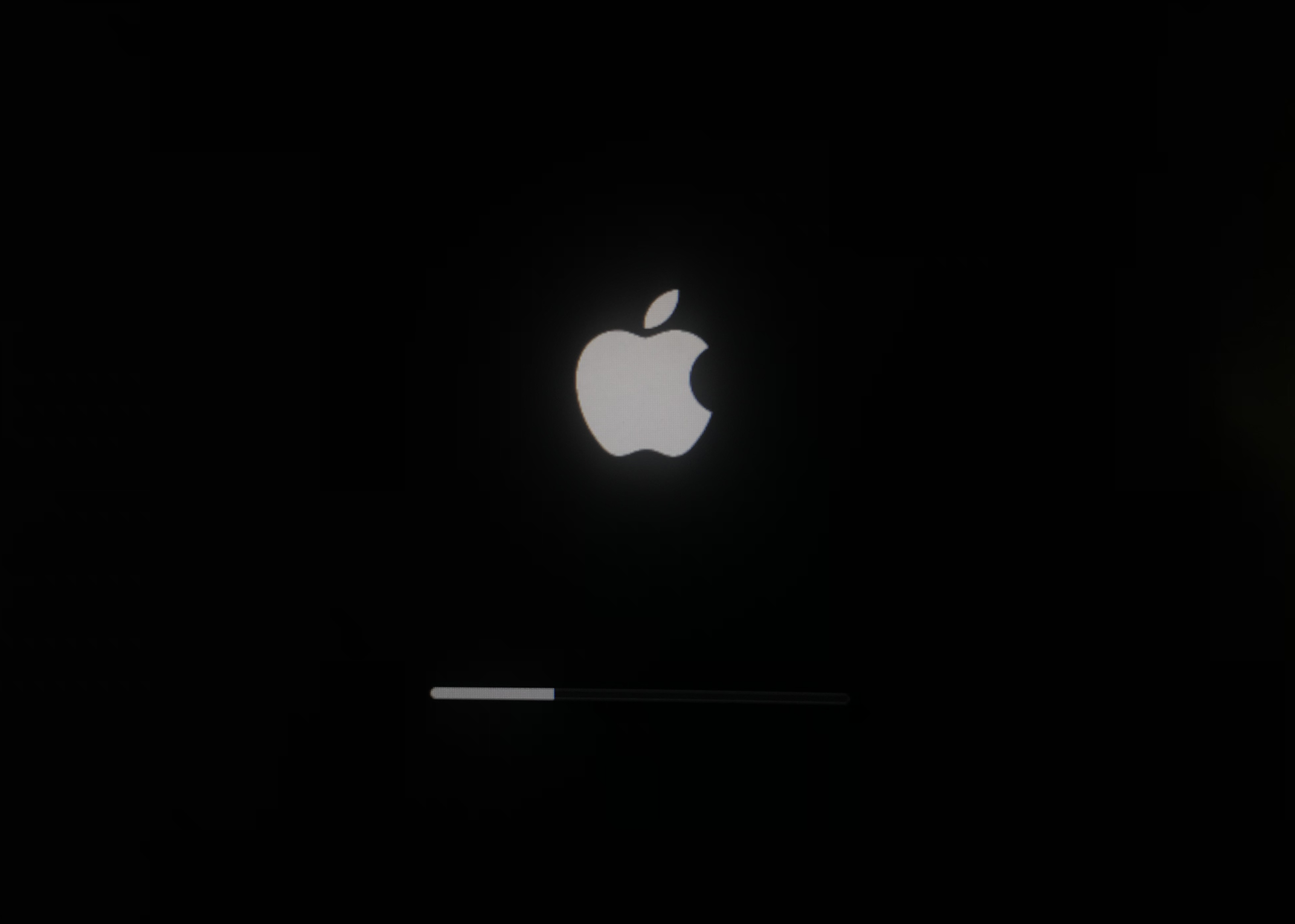

  • when starting vm w/ primary gpu bios, apple boot hangs around 25% and screen is split of unraid cmd on the upper half and black dots, yet vm still working with remote client without recognized graphics

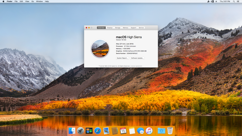

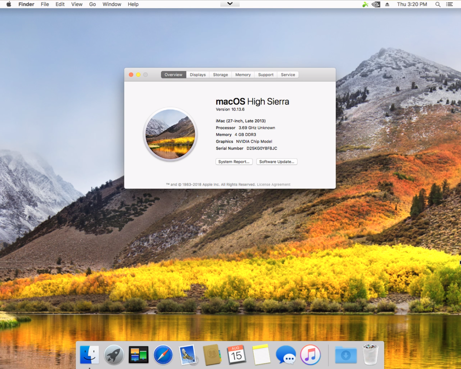

  • vm runs normal with secondary gpu (gtx 970) passedthrough

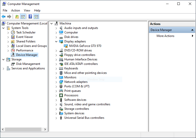

  • was able to get primary gpu passed only once on windows alongside secondary gpu, and it was immediately after using dumbed bios from secondary gpu. not anymore

this is obviously a gpu bios issue, if i am correct. any idea how i could go about this?

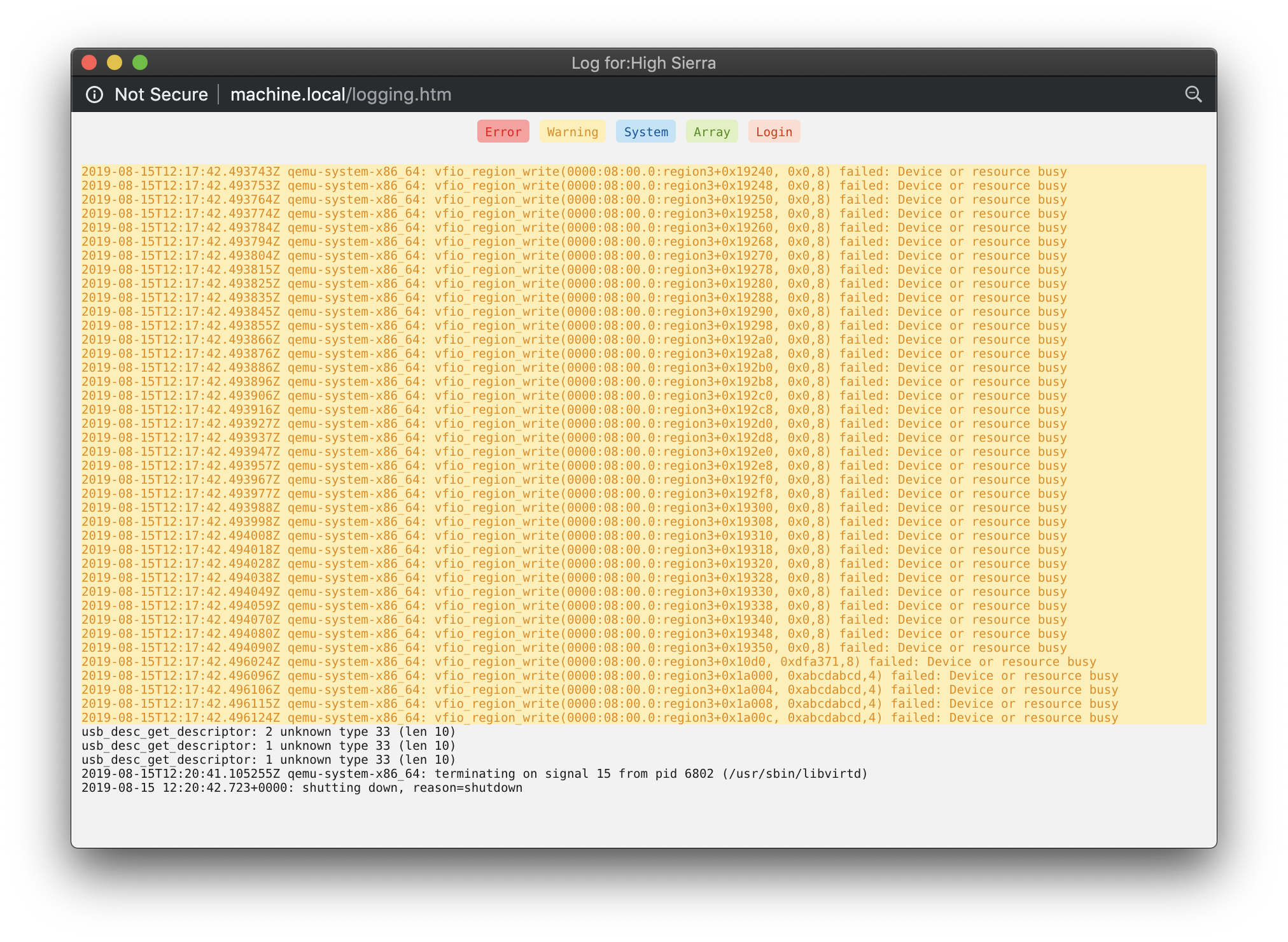

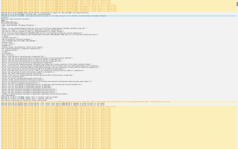

You need more details than "don't work" e.g. log, xml etc.

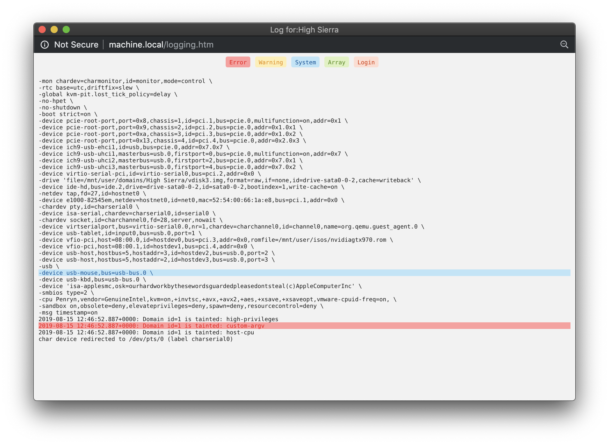

apologies for lesser detailing… more below
high sierra xml (primary gpu):

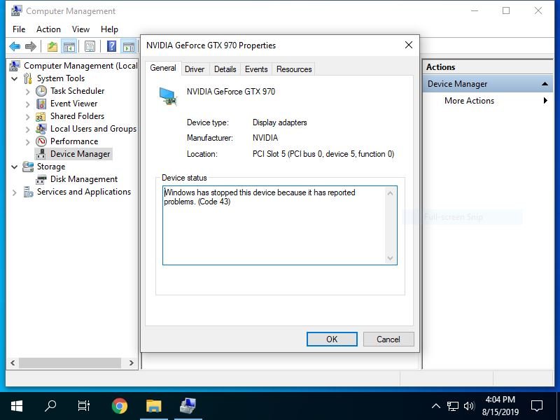

as mentioned, i was unable to passthrough primray gpu even with windows. got it to work only once, in the first time after dumbing vbios from secondary and running it on windows vm, but overnight and on next day trying it on mac vm it stopped working even when put back to windows.
You didn't reboot overnight right? Sounds like reset issue, not uncommon with primary GPU passthrough.

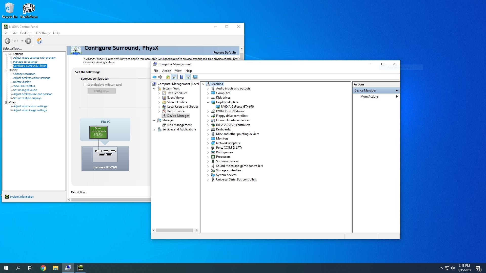

primary gpu passedthrough (windows)
secondary gpu passedthrough (windows)

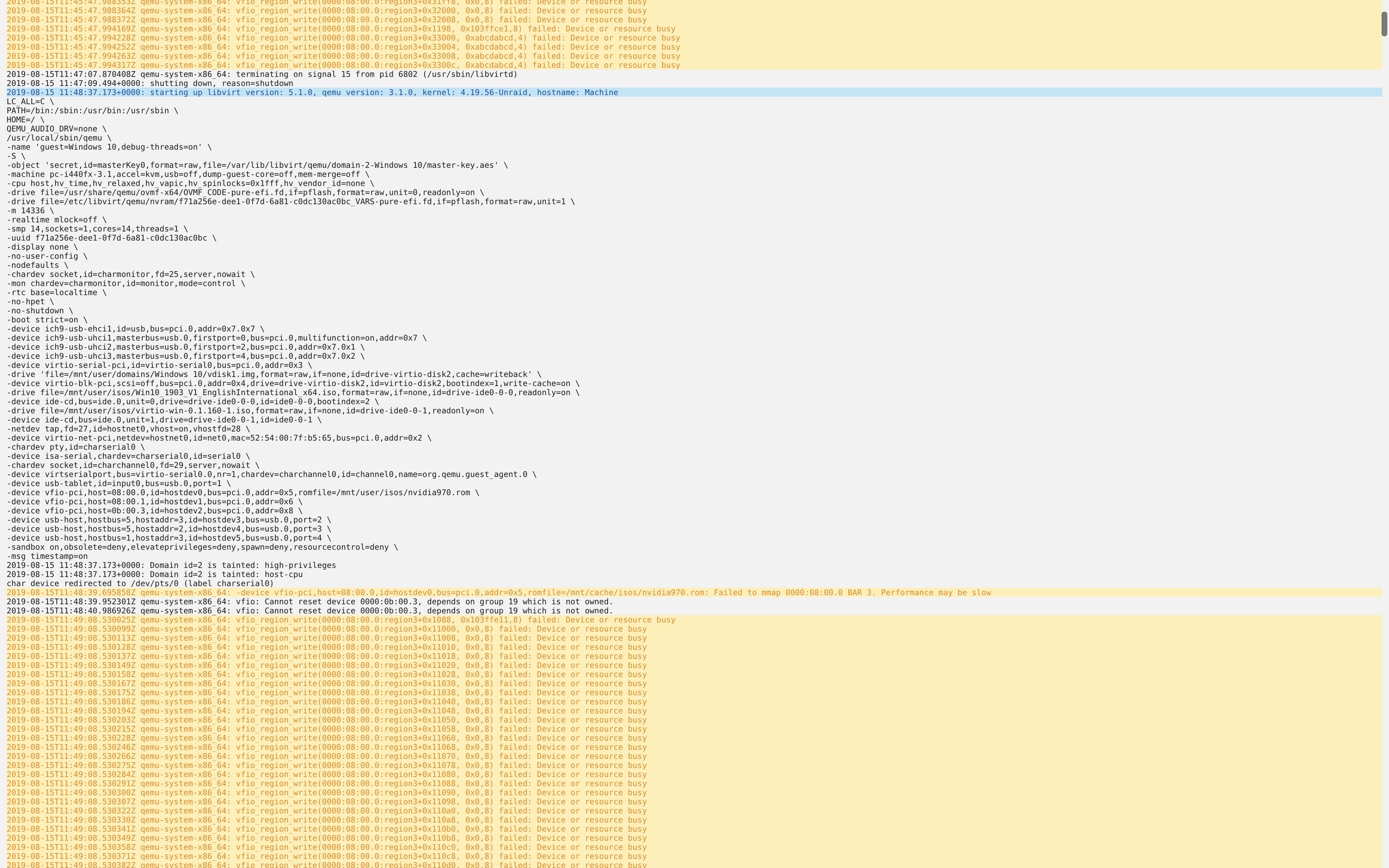

primary gpu passedthrough (mac)
hangs on load. this is taken from my phone
this is how it is on remote client
1951847578_ScreenShot2019-08-15at3_20_49PM.thumb.png.16e7cda2b5e9ec938d3f35006c49c602.png
log is the same as windows on primary gpu
592074077_ScreenShot2019-08-15at3_22_47PM.thumb.png.8d902e7f788b9e9b0a7883e501956bfe.png

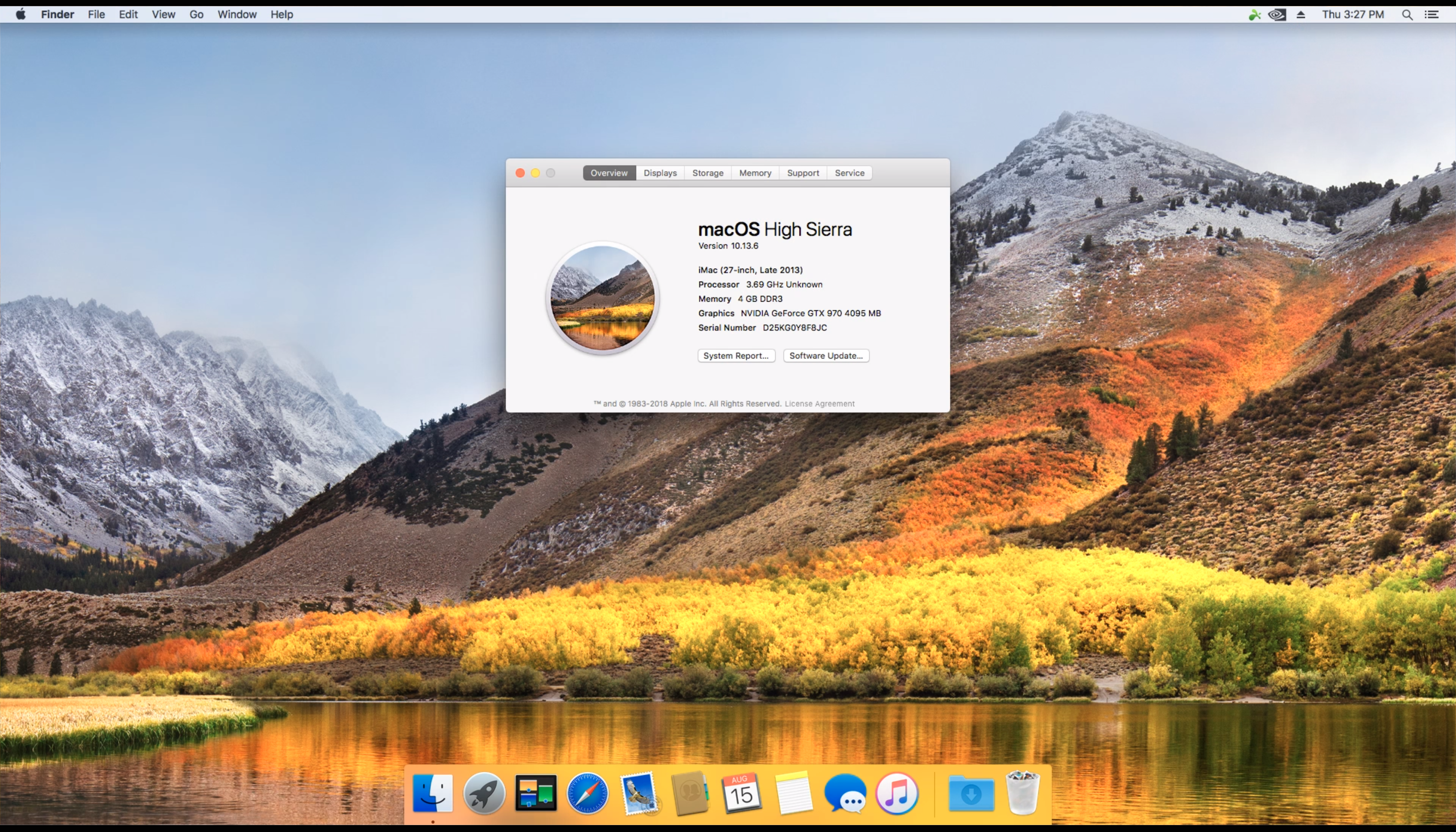

secondary gpu passedthrough (mac)
781446796_ScreenShot2019-08-15at3_27_22PM.thumb.png.0814f805042d925b7f21683351a3b5ba.png

In your primary gpu windows screenshot, there is an exclamation mark on the 970 device suggesting Windows error. What is the error?

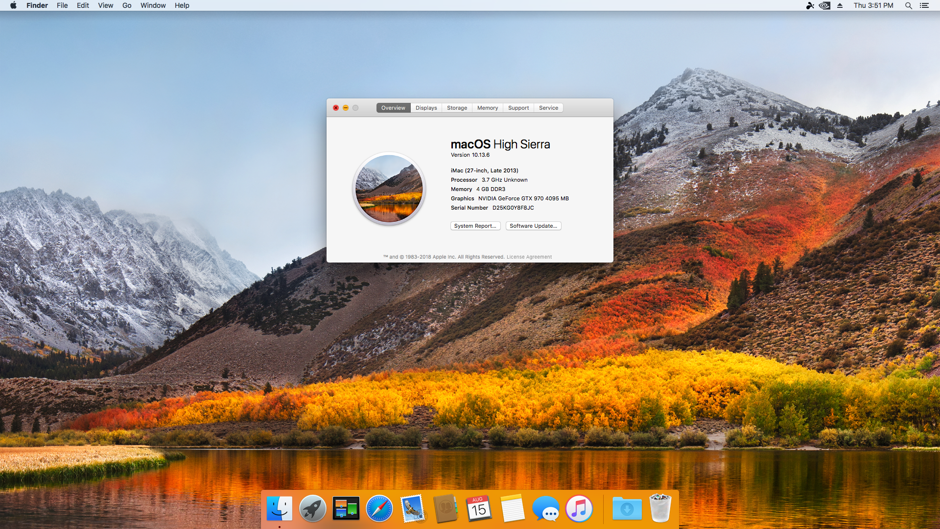

20 minutes ago, testdasi said:
In the meantime are you booting Unraid in UEFI mode? If so switch to legacy mode and try again.
Booting in UEFI is known to holding on to the GPU too tightly.
i love you ❤️
this fixed it for me… currently running the primary gpu on mac through hdmi
240651774_ScreenShot2019-08-15at3_51_42PM.thumb.png.7af3665f62c93bc0c5031cae40eba7ef.png
log
477639409_ScreenShot2019-08-15at3_54_02PM.thumb.png.35fc1f3824a630576451cf7a9986b6ee.png
switching back to uefi to check that message again, will update you in minutes
update:
here is what it says (code 43)
Edited by iilied
update
Code 43 is Nvidia driver detecting that you are using it in a VM. Nvidia consumer card i.e. non-Quadro is not supposed to be run in a VM so if the driver detects a VM envi, it will refuse to load. This happens a lot with primary GPU pass-through.
