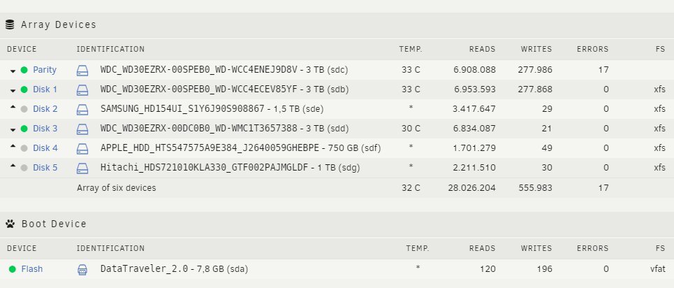

This is the array status reporting 17 errors (not parity errors, the array shows as healthy):

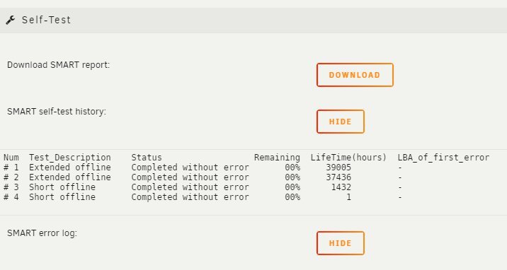

This is the Test results from the Parity Drive

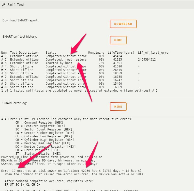

This is the test results from the Disk3 Drive. Here you can notice:
- Last test, completed without error.
- The previous one (#2) Completed with read failure.
- Down in the error log, Error 19 happened at 42930 hours of age. No other error until now (2000 hours more).

Disk3 is OK for now, but is more likely to fail again soon, parity is failing.

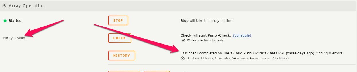

What do you mean with "Parity is failing"? As far as I know, parity is still ok and no error was corrected from parity:

How can you be that sure? I just ask out of curiosity, to learn myself. Because I did the SMART extended test and it was ok and there's not a single error logged into it.
Error 1 [0] occurred at disk power-on lifetime: 38981 hours (1624 days + 5 hours)
  When the command that caused the error occurred, the device was active or idle.
  After command completion occurred, registers were:
  ER -- ST COUNT  LBA_48  LH LM LL DV DC
  40 -- 51 00 c0 00 00 af 89 d9 88 e0 00  Error: UNC 192 sectors at LBA = 0xaf89d988 = 2945046920
You can see recent UNC @ LBA errors, these are media errors, aka bad/failing sectors, these are confirmed in the log:
Aug 12 21:24:16 GALEON kernel: ata2.00: cmd 25/00:c0:50:d9:89/00:00:af:00:00/e0 tag 15 dma 98304 in
Aug 12 21:24:16 GALEON kernel:         res 51/40:7f:88:d9:89/00:00:af:00:00/e0 Emask 0x9 (media error)
Aug 12 21:24:16 GALEON kernel: ata2.00: status: { DRDY ERR }
Aug 12 21:24:16 GALEON kernel: ata2.00: error: { UNC }
Aug 12 21:24:16 GALEON kernel: ata2.00: configured for UDMA/133
Showing again UNC errors (media error)
Now these errors can some times be intermittent, and if the disk passed the extend SMART test is OK for now, but it's much more likely to fail again in the near future.
The other two disks show a few ATA connection/timout errors on the log, these are usually cable/connection problem.
Also, make sure it really passed the extended SMART test, sometimes people misinterpret the way the results are logged.
