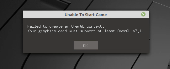

Hello,

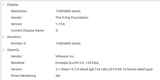

Im trying to run Dota 2 on a Linux Mint VM but I have been unable to do so. I tried to use vulkan, dx11, dx9, opengl and nothing. I think it has to do with how Steam is recognizing the VNC im using to project the screen. Below is the display specs that Linux Mint shows and the error. Does anyone have an idea? Could it be that im missing a driver? Im on the latest Mesa driver for what I know. Thanks.
@Ernie11 Forget about the idea of playing games on a "virtual" gpu. It's an emulated GPU which maybe provides such feature sets like openGL or vulkan, but without any of the hardware acceleration behind it what a physical GPU provides. If you wanna play games in a VM which needs some horsepower, passthrough a physical GPU.
