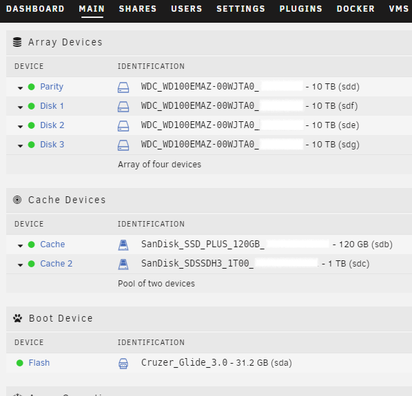

Your docker templates are stored on the flash drive, so that is the likely problem.
Go to Tools - Diagnostics and attach the complete diagnostics zip file to your next post.
Also, what was your intent with pairing up a 1TB SSD with a 120GB SSD in the cache pool? If you haven't manually adjusted things, that will end up with 120GB of useable space, basically ignoring the capacity of the 1TB, and a free space display in the GUI that is seriously wrong.

I had a 120GB SSD, but wanted to enlarge my cache, so I added the 1TB.

The problem is that by default the cache is set up as BTRFS RAID1 which means that all data is stored on more than one drive.   As a result with two drives of different sizes the available space is limited to that of the smallest drive.    If you want the space to be added together (with no redundancy) then you can manually convert the cache to operate like that.
I don't really care if the 120GB is included.  If that causes an issue, I can just remove it.  But I also don't really have a use for it, so if there is a way of getting them both to work, that would be fine too.  I'm all ears.  And thanks for the info.

Your docker image is 100G, way more than it should be and that would consume most of the 120G you have for cache. Why did you make docker image so large? I always recommend 20G, and if you fill that much up you have something misconfigured. Docker image should grow very little, and 20G should be more than enough.
Your docker image is corrupt. Possibly you have been filling it, I don't know. You will have to delete and recreate it. Some of it is on the array anyway so recreating it is the easiest way to fix that. Only give it 20G.
Personally, I would just get rid of the 120G cache and free that port up for future use. It isn't really a significant amount compared to the 1TB. If you really did want to add them together raid0 would be the way to do that:

Lastly, I'll remove the 120GB drive.  Doesn't seem worth the trouble of getting it added correctly.
Edited by chi_town60608
I guess i should ask;  is there a 'proper' way to take a cache disk out of the array?

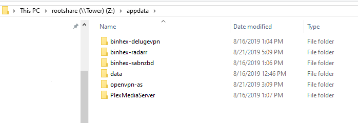

Are all your appdata folders on the new cache drive?
I have the 'Use cache disk" option for appdata set to 'Prefer'.   Not sure if that helps answer your question.
Doesn't answer what we need to know. My suspicion is that you ran out of space on your 120GB cache pool, and the file system was corrupted. Without a backup of your appdata folder from before this mess started, I suspect you will have to set everything up again from scratch.
As you said, your data on the array is fine, but the containers lost their settings when the cache pool got corrupted. When you added the templates back, that simply installs the containers with all the fields filled in the way they were, but has nothing to do with the appdata contents, which means they all act like brand new installs.
As to whether or not the original appdata contents are able to be recovered, that depends on exactly what happened behind the scenes when you were adding and removing drives to the cache pool. Absent an actual backup of the appdata like you would have with the CA Backup / Restore Appdata plugin, I doubt there is any way to get back to where you were without rebuilding things like you alluded to in the first post.
The only thing I can think to do would be to attempt a data recovery on the original 120GB cache drive using BTRFS restore or similar. @johnnie.black may have a better idea about the situation.
