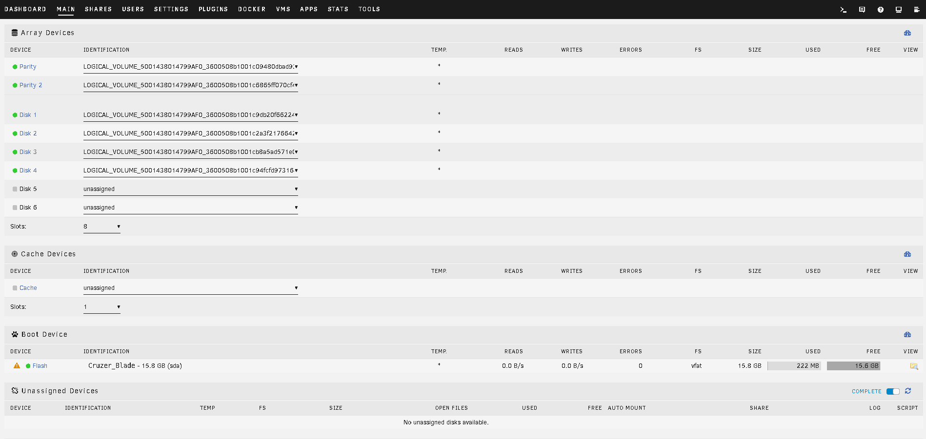

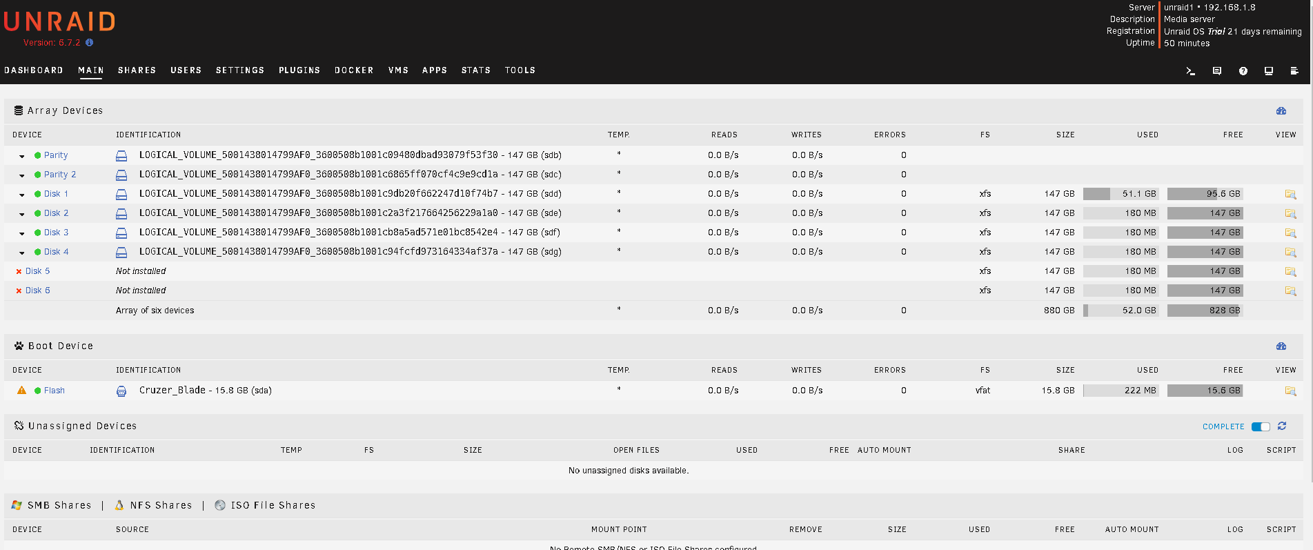

August 17, 20197 yr I am new to unraid so trying a few things to see how it all works before moving my data across. I am using an old HP 380DL G7 with 8 147gb SAS drives for the testing. Install went well, I set up 2 of the drives as parity drives and the rest as storage. I wanted to test a 2 drive failure, so removed 2 drives. This seemed to work with the data being emulated at first. Then I did a parity rebuild which also worked correctly. -1st question: during the parity rebuild, I assume there is no protection if another drive fails as we are already rebuilding from 2 drives? -2nd question: what if only a single drive failed and I started a parity rebuild, is the array safe from another drive failing due to having 2 parity drives, or am I in the same position as Q1 since both parity drives are being rewritten, there is no protection from a 2nd drive failing while the rebuild takes place? So now I wanted to move on, and re-add the 2 drives I removed back to the array, but unraid did not see them, it just shows "Not installed" on the Main page. The disks were labeled as Disk 5 & 6 in my case. Even though they were not showing as installed I could click on the disks and see their settings. They also do not appear in unassigned devices. Stopping and restarting the array made no difference, nor did restarting the server. If I look at tools>system Devices, it showed all 8 disks in the SCSI Devices list. Reading through various threads it seemed I might need to re-define the array. I did a Tools>New Config and Preserve current assignment for all. This shank the array to just 6 disks showing out of the 8. I rebuit the parity again after the new config and the 6 drives are fine, but I still can't find a way to add the 2 removed drives back to the array. now on the main page Disk 5 & 6 are just showing as unassigned, but there is no option to assign them in the drop down. If I look at tools>system Devices, it now only shows 6 of the 8 disks in the SCSI Devices list. HP bois shows all 8 drives Q3: Any suggestions? Thanks, Pete. PS I don't have any other sas drives to test if the problem is just with the serials of the 2 I removed. unraid1-diagnostics-20190817-0630.zip Edited August 17, 20197 yr by pete69 Solved

August 17, 20197 yr Author Hi Thanks for the reply. I wasn't expecting to access the data on the removed drives when I reinstalled them after the rebuild, I just wanted to add them back as new drives to expand the the array again. But unraid was not allowing them to be added, even though the settings data was still showing for those drives in unraid. With the array stopped the option to assign was not available on these drives. The issue turned out to be the internal HP P410i raid controller tagging these drives as bad after I removed and re instated them a couple of times, even though it is running in HBA mode. Thanks for answering the 2 questions though. As I understand it, in this case the parity rebuild wouldn't have been rebuilding 2 drives, as the drives had been removed without replacements. It would be rebuilding parity across the entire array with the remaining drives so that 2 drive redunancy is mantained with 2 fewer drives?
