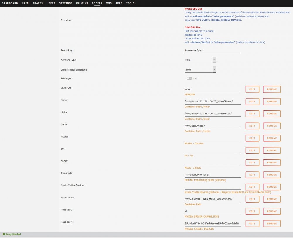

adding a picture of my Plex setup.
i am mounting a couple of shares off another server. but problem still occurs when i don't.

Unfortunately, these paths are not on a Physical Disk.
The path has to be on one to a physical device.  Typically, the path would be a device similar to on like this:  /mnt/cache/  or   /mnt/disk1/   or /mnt/user/  or   /mnt/user0/

Any of these are paths to a physical device.  The  /mnt/user/  and the  /mnt/user0/  point to the User Shares.
BTW, it is not a good idea to use a device mounted with the Unassigned Devices plugin for a Docker App because if the device is missing/not-mounted, the directory will be created in the RAM disk.

There is nothing wrong with mapping a path to a UD mounted share (I do it all the time).  It works perfectly, and is how the system is designed to work.  But, this is subject to the remote server being on 24/7  If it's not then it is not a good idea to do.
I would suspect however that the issue here is actually that the /config mapping in the template (Show More Settings) is /mnt/user/appdata/Plex...  Change it to /mnt/cache/appdata/Plex...
