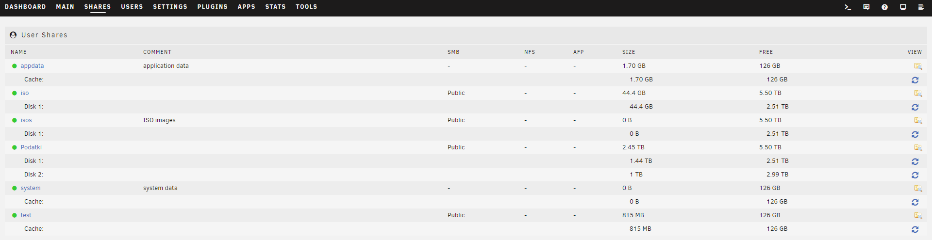

August 18, 20197 yr Community Expert Go to Shares - User Shares and Compute All. Wait for it to complete. If it hasn't produced a result after several minutes, refresh the page. Post a screenshot of the results.
August 18, 20197 yr Author 3 minutes ago, trurl said: Go to Shares - User Shares and Compute All. Wait for it to complete. If it hasn't produced a result after several minutes, refresh the page. Post a screenshot of the results.
August 18, 20197 yr Community Expert Your most recent diagnostic showed some files from system still on the array, but that shows all of it on cache. With all the cache-prefer or only shares on cache and all other shares on the array, there is nothing for mover to do. I assume you are getting that error when trying to write to the test share? What happens if you set Minimum Free for cache to zero?
August 18, 20197 yr Author 6 minutes ago, trurl said: I assume you are getting that error when trying to write to the test share? What happens if you set Minimum Free for cache to zero? I created test share to test if I can even write any data on to cache and it works. I also tested iso share and it work. The only difference between "iso" share and "podatki" share ("podatki" share was the one giving me an error) was the min. free space setting, so I changed the setting in "podatki" share from 1TB to 20GB and now it works fine.
