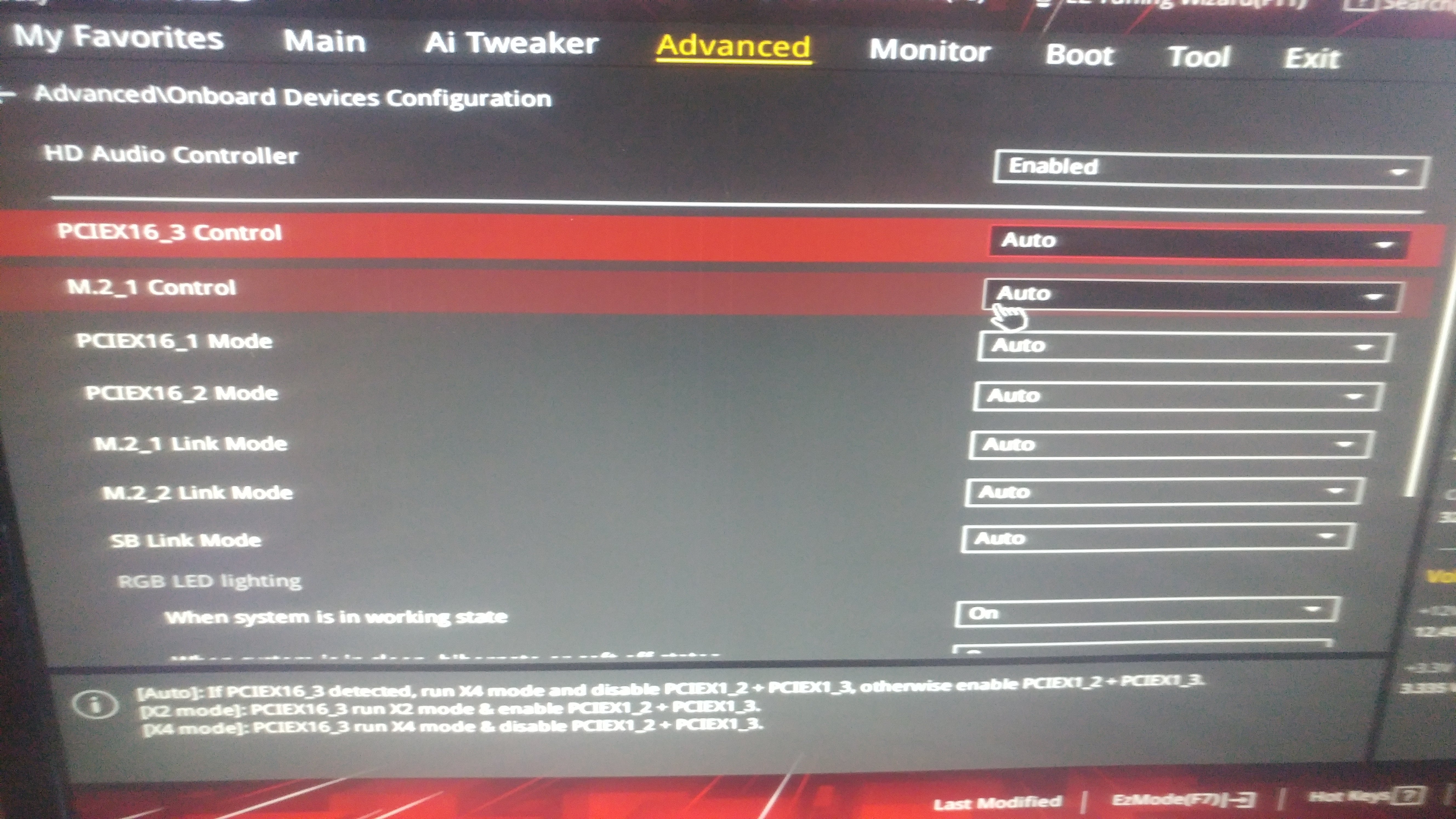

August 17, 20197 yr I followed the tutorial and i have two graphics cards. The top graphics card gtx 1660ti i was using for the unraid os attaches to my main monitor. The second bottom graphics card gtx 1060 was on the bottom. In info both graphics cards show up attached to seperate groups. Then i setup my vm and make sure the windows10 iso is in the share and selected. I made the sure graphics card 1060 was selected. And the audio device attached to that card was selected as well. Then the vm says it is started and has a green arrow but then the screen the vm is attached to through the 1060 just stays blank and nothing happends. I also get this error if i stop the array and then start it again that says. Internal error unknown pci header type 127. I changed pcie16_1 and _2 to mode 3 gen. That was the only thing in the bios that i could find had to do with my graphics card slots on my motherboard. Edited August 17, 20197 yr by Nebula1
