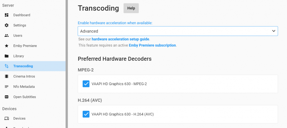

On 8/25/2019 at 9:25 AM, jang430 said:
@ken-ji, did a fresh setup of another unraid box.  Can't get the emby gpu transcoding to work.  Using Intel Celeron G3930.  Already did the following:
#!/bin/bash
# enable iGPU for docker use
/sbin/modprobe i915
chmod -R 0777 /dev/dri
# Start the Management Utility
/usr/local/sbin/emhttp &
Does anything have to be done with Emby server?
Thanks in advance.
Yes, have Emby Premiere and turn on Hardware Transcoding in Emby. Set it to Advanced to see if the iGPU is correctly setup
