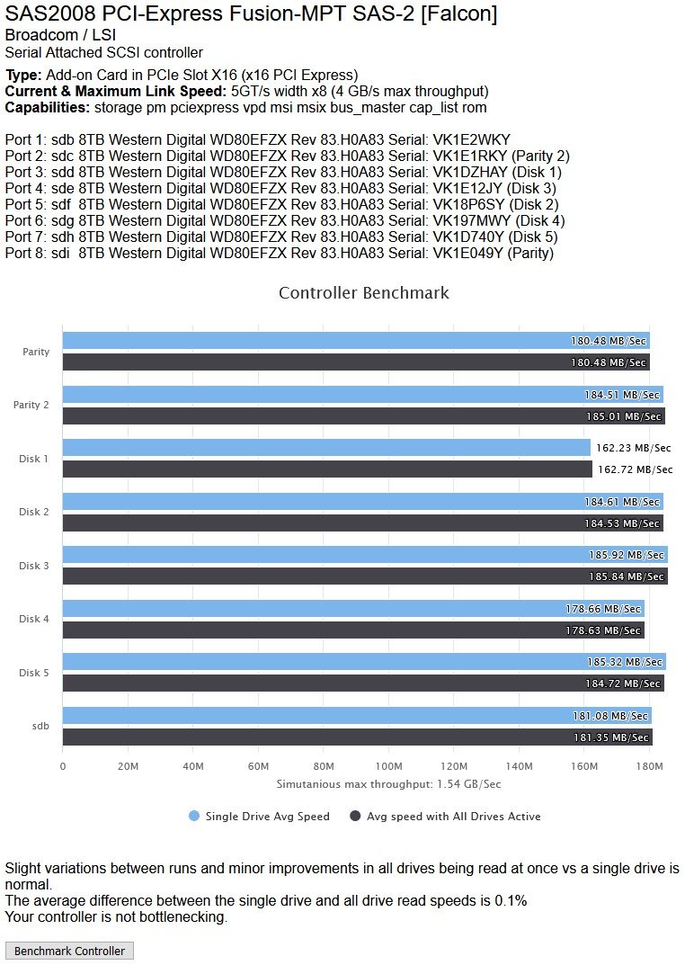

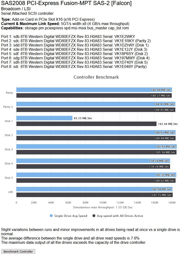

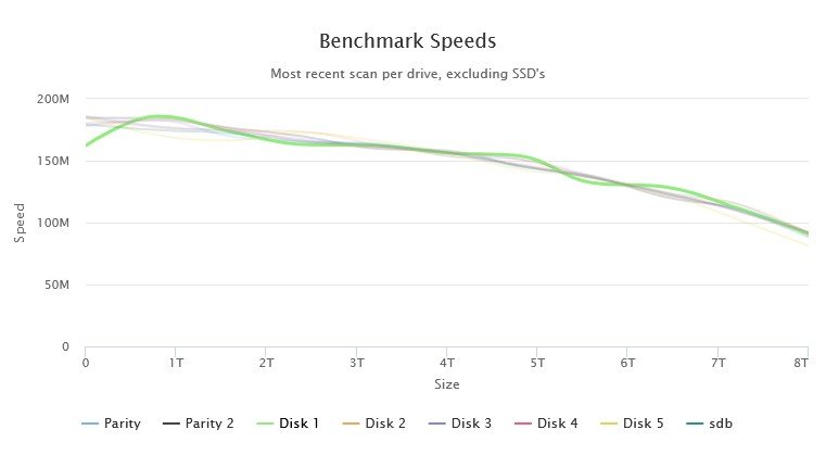

Earlier I had run the DiskSpeed docker and it did show anomalous behaviour on Disk 1 (see pics below) so despite the SMART report seeming clean I shall be performing a Parity rebuild then taking that disk out of the array.
I have one unassigned disk which I shall clear of my scratch backups and bring it in to replace Disk 1.

Despite changing the SAS-SATA cable, trying the drive on a new HBA card and deleting the partition, it still did its odd shutdown thing one time in four. It still showed a slower transfer rate between 0-1Tb and that odd wobble between 5-6Tb compared to all the other seven identical drives. All the time it still performed perfectly well as a functioning hard drive in that it never lost data.
