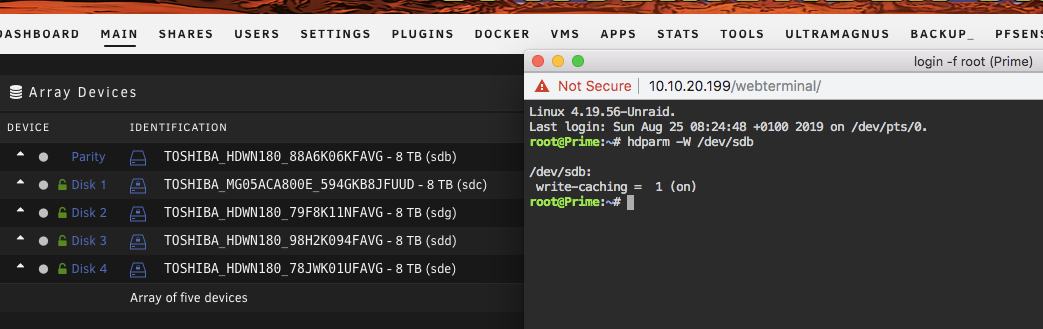

One quick thing that you can try too is check if write cache is enabled on the drives.
On the webui you will see each disk has an id ie sdb sde sdf etc
For each disk use this command. Example here is for my disk sdb
hdparm -W /dev/sdb
1934890986_ScreenShot2019-08-25at09_38_07.thumb.png.0c4fdd985d7730bf1e3e56689c8eb907.png
If it doesn't say write-caching on for the drive as above.
You can enable it by using command
hdparm -W 1 /dev/sdb

Yep - I've just checked and write caching is enabled for each disk :).
