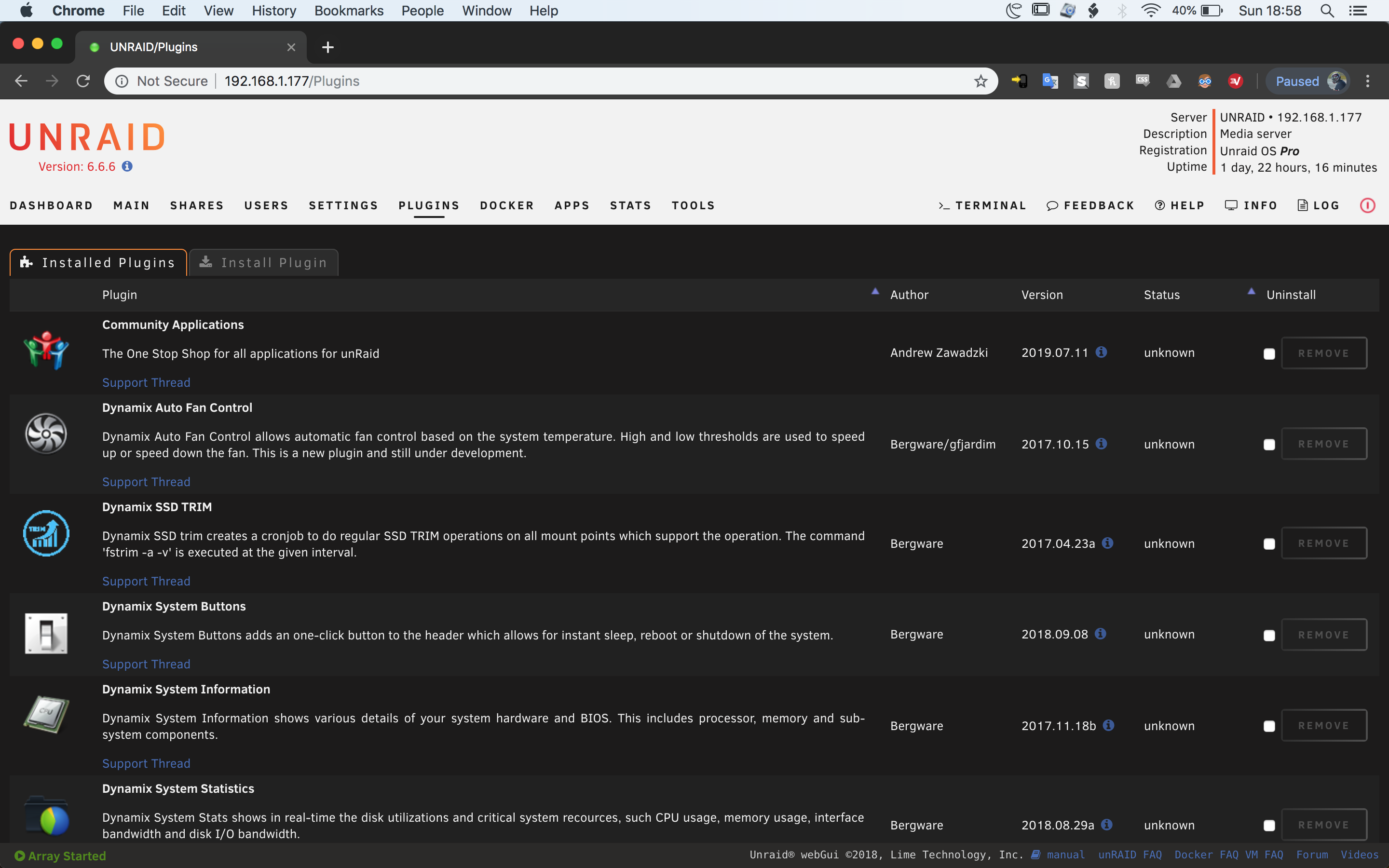

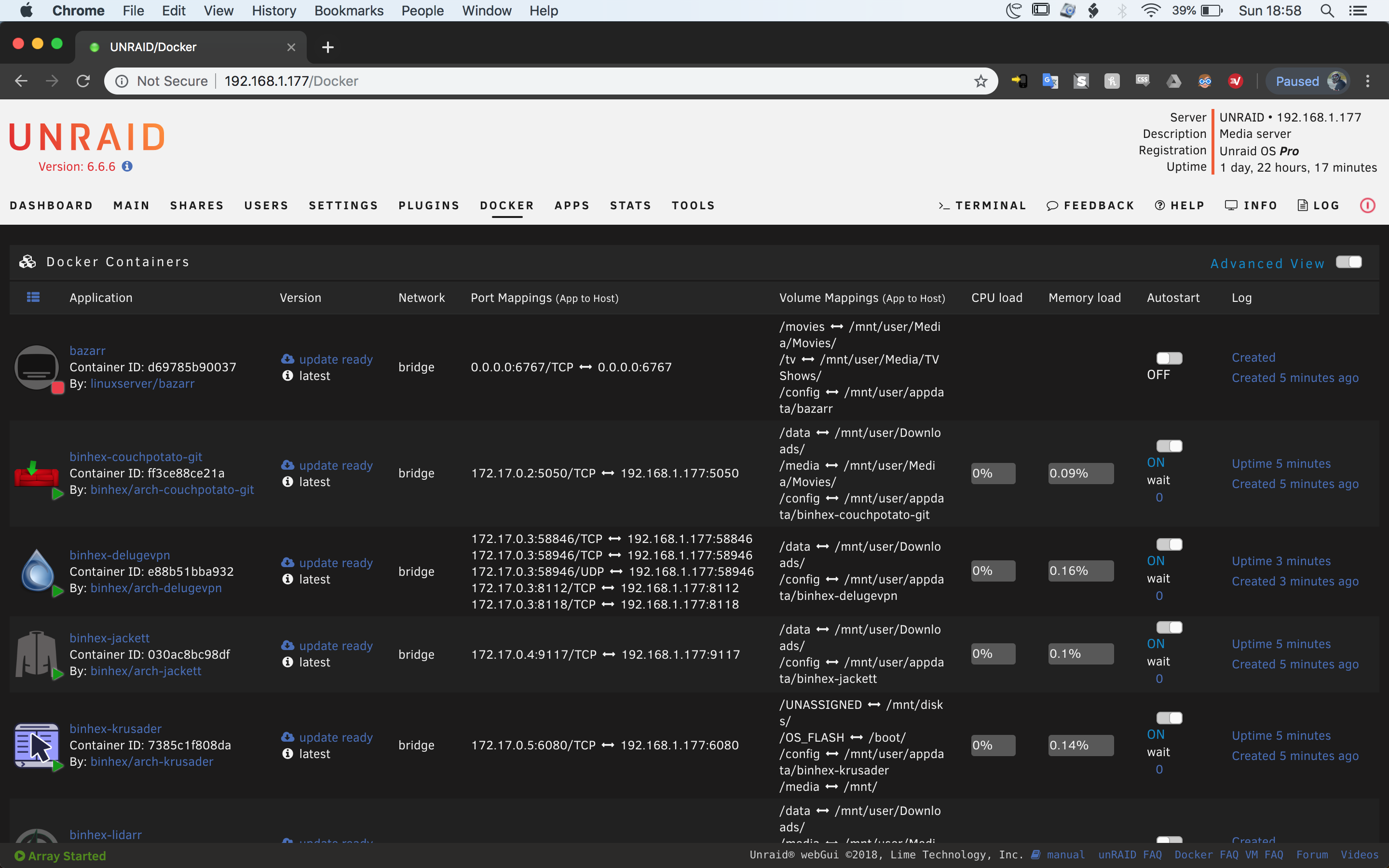

Yesterday my wife mentioned that she was having issues connecting Plex to the server. I rebooted the system and everything seemed to work. Today I went to watch one of my shows and noticed that the newest episode wasn't available. When I got into the dashboard I noticed things were looking off. All of my dockers seem to need an update and the status for all of my plugins is unknown. When I try to update any of the docker images, it pulls nothing, runs through the process, completes and then still tells me I need to update. I've also noticed that none of my programs seem to be working as they should. Dockers like Radarr and Sonarr are no longer talking to their indexers. I can still manually use programs like Deluge and SabNZB though. Is this a bug or some setting that might have gotten changed? Attached below are some screengrabs to show what I'm talking about.

Go to Tools - Diagnostics and attach the complete diagnostics zip file to your next post.
Why are you ignoring this?
Aug 18 19:11:05 UNRAID root: Fix Common Problems: Error: Unable to communicate with GitHub.com ** Ignored
Aug 18 19:11:05 UNRAID root: Fix Common Problems: Other Warning: Could not check for blacklisted plugins
Aug 18 19:11:05 UNRAID root: Fix Common Problems: Other Warning: Could not perform unknown plugins installed checks
Aug 18 19:11:11 UNRAID root: Fix Common Problems: Other Warning: Could not perform docker application port tests
Because I'm an idiot and since nothing was prompting me on the main screen I forgot to check Fix Common Problems myself. Looks like it's a DNS error on my router
Thanks @trurl. The DNS settings got changed somehow and didn't match my router. Thank you for your help
You told Fix Common Problems to ignore it so it didn't tell you. You shouldn't tell FCP to ignore a problem unless you understand exactly why it might not apply to your case.
Do you have Notifications setup to alert you immediately by email or other agent when a problem is detected? This is especially important with disk problems. You must take care of a problem immediately or you could wind up with multiple problems and data loss.
