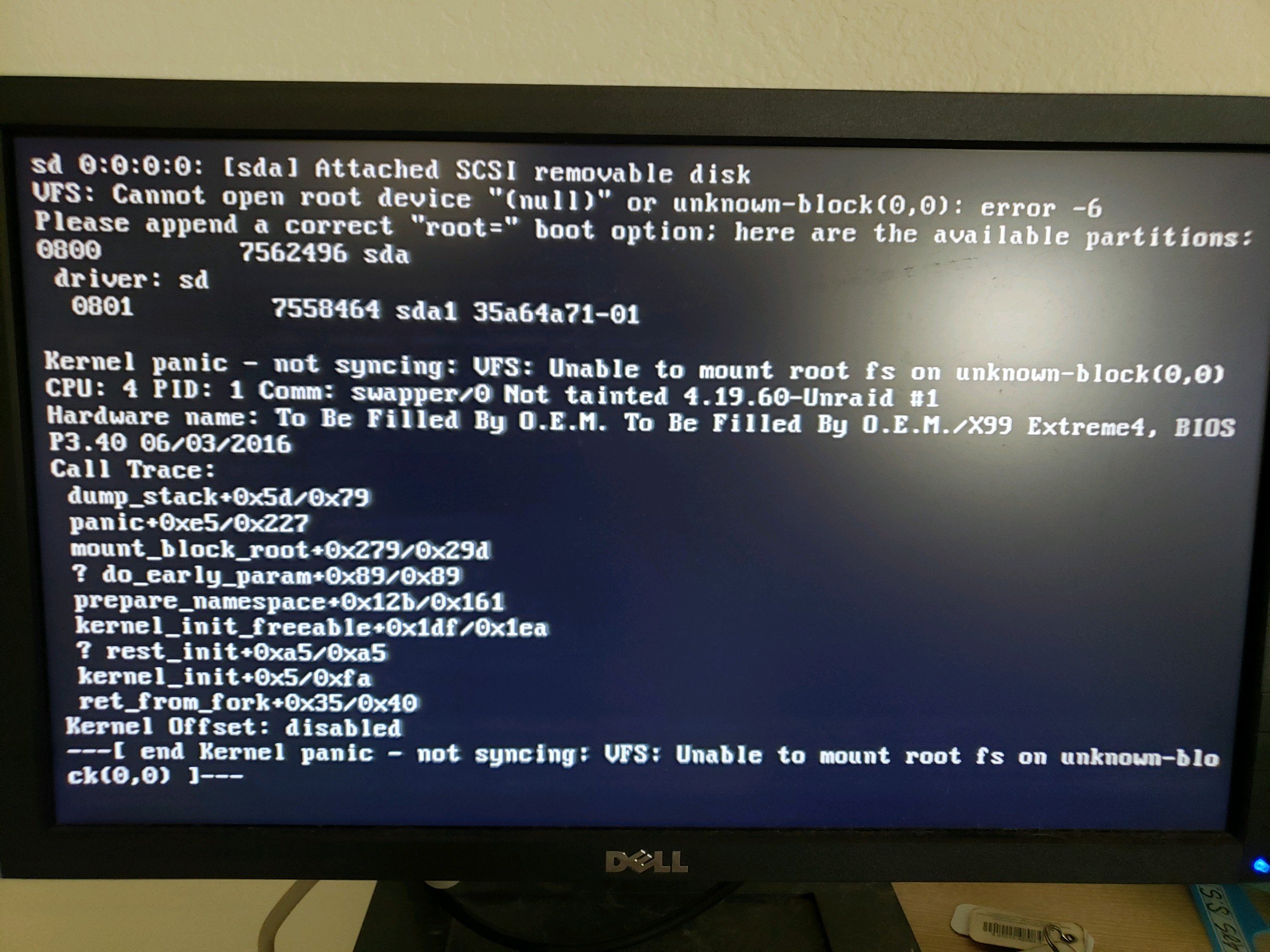

Hi, I have a strange problem, after about 6.7.2 I started having a strange problem. When ever i reboot the server if I boot to non-gui mode (default) I get a Kernel panic - not syncing: VFS: Unable to mount root fs on unknown-block(0,0). there are a few other errors. This is consistang It will not boot, but if I change it to boot to the gui mode the server boots fine. I have currently updated to the latest 6.7.3-rc2 and still have this problem. Makes it difficult to reboot since this is normally a headless server. Does anyone have any ideas on what could be causing this.

A while ago I had a similar issue with booting.  My server would not boot except in GUI mode; just a flashing cursor on the screen otherwise.  It turned out something had changed in the Lunux kernel, drivers, etc, that required that I boot in UEFI and not legacy BIOS.  As soon as I made that change in unRAID and my MB BIOS, I have not had an issue.  I don't know if this is your issue as I never saw any kernel panics.
