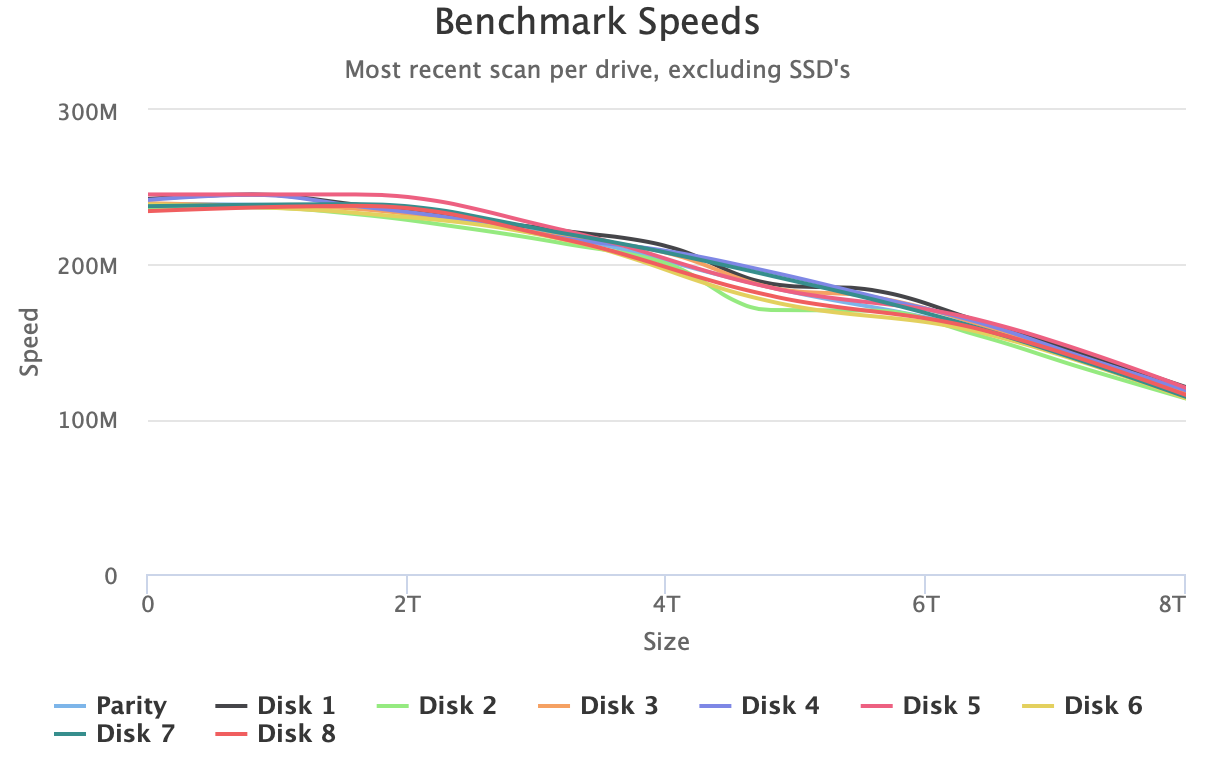

I have 8 Seagate Enterprise Capacity SATA drives, all flashed to latest firmware and a Seagate Ironwolf 8TB.  Their speed is all roughly identical - I've re-done disk speed tests on them today (screenshot below) to ensure there is not an individual drive issue nor an obvious cable issue and it all looks good.  They're attached to a Dell Perc H310 flashed to IT mode which has PCIe 2.0 x 8 lanes which has more than enough bandwidth.
I had assumed this low speed was due to parity, but another member says this is not normal and not what he gets.

506137233_ScreenShot2019-08-19at10_47_33.thumb.png.ea0678ee18f15c66744ab3a825cbddb7.png

That sounds like a good speed for writing to the parity protected array :)  you might get better speeds if you have Turbo write enabled but that is at the expense of needing all drives to be spinning which is not the case for the default mode.
Thanks, that's what I thought.  Although I am often in disbelief that it is that much slower than a single drive, but so be it I guess.
