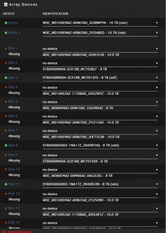

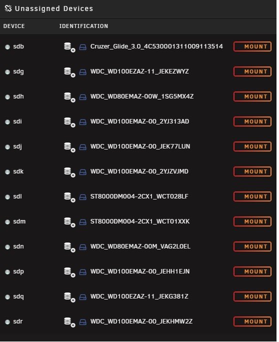

Just as the title states I replaced the HP controller with the lsi 16i and most disks are now missing.I do have a snap shot of my assignments before the replace. All disks are shown in the unassigned devices. My parity disks are ok and mounted.
Should I mount all the disks and then unassign my parity drives, start array , stop array and then mount my parity disks back in and let parity rebuild. Or is there a better way?

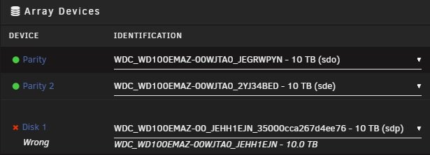

I added a pic of when I choose from the drop down menu. Same disk but still states it as wrong.

Try toggling Settings -> Display settings -> Display world-wide-name in device ID:
You should also update the HBA firmware, it's very old.
It looks as though the different controllers are reporting the disk serial in slightly different formats which is why Unraid is not realising they are the same drive.
