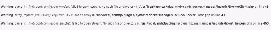

This also shows up on the main tab of the GUI:

Flash drive problem, try a different port, USB 2.0 preferred, if same get a new flash drive.
