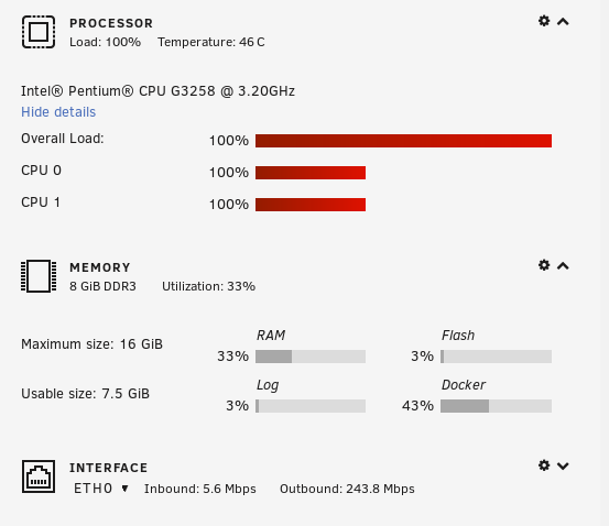

Hello, I have been having this issue for as long as I've used Unraid so I've just assumed that it is due to the low CPU power of the G3258. However, I am wondering if there is anything I should be tuning/tweaking to potentially fix this.
Whenever I transfer files over NFS (to & from the server) the CPU usage of the G3258 rises to 100% with a rough throughput of ~30MB/s.
I do not think this is due to the low power of my CPU however, as transfering the same files from one disk to another only uses maximum around ~60% of the CPU, with a throughput of the disk maximum (~120MB/s)

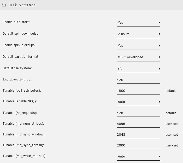

Disk Settings:
NFS Settings:
I can't see how my CPU usage would rise ~40% just by transferring a file over my network, rather than locally. Unless it does require that much processing power.
Any ideas?
Cheers

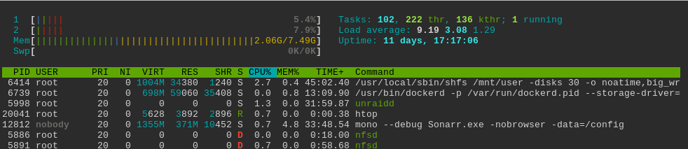

In a Terminal session (either via SSH or GUI), type   htop   on the command line.  That should give a picture of what your CPU hog on a real time basis.
I'm a little confused as to what I'm seeing honestly, load is sky high yet shfs only appears to be a using a few percent.
Cheers

Are you sure that wait time truly is a problem?  The only way that wait time would be a problem is if was slowing down some other process that was running concurrently.  Are you seeing any real slowdowns in things like the GUI response?  Your first screen capture (the one showing both CPU at 100%) is of the Dashboard screen of the GUI.  Was it sluggish or non-responsive?

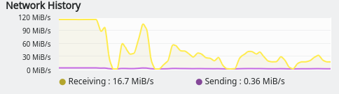

I'm starting to think this might actually be an issue with my client and not the server. Here is my network history graph from client:
As you can see it starts off fine (perhaps a buffer?) then drops to a crawl just like NFS. I think this means its not a server issue. I might need to look into changing my IO scheduler.
Cheers
