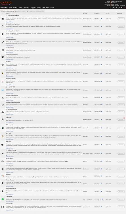

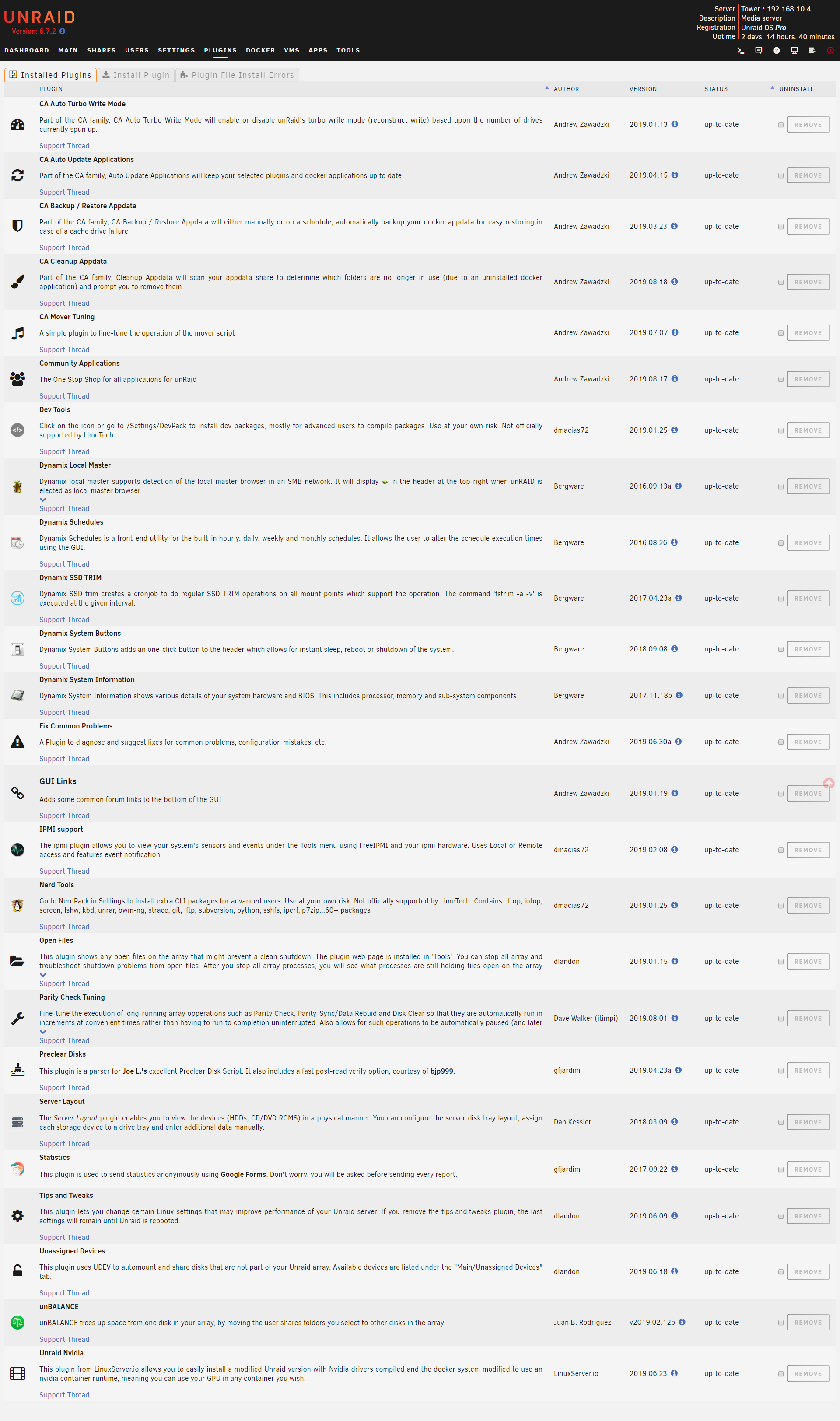

 Plugins:
1286782344_FireShotCapture002-Tower_Plugins-192_168_10.4.thumb.png.0b752ddd6a981d2567513982a62a7365.png

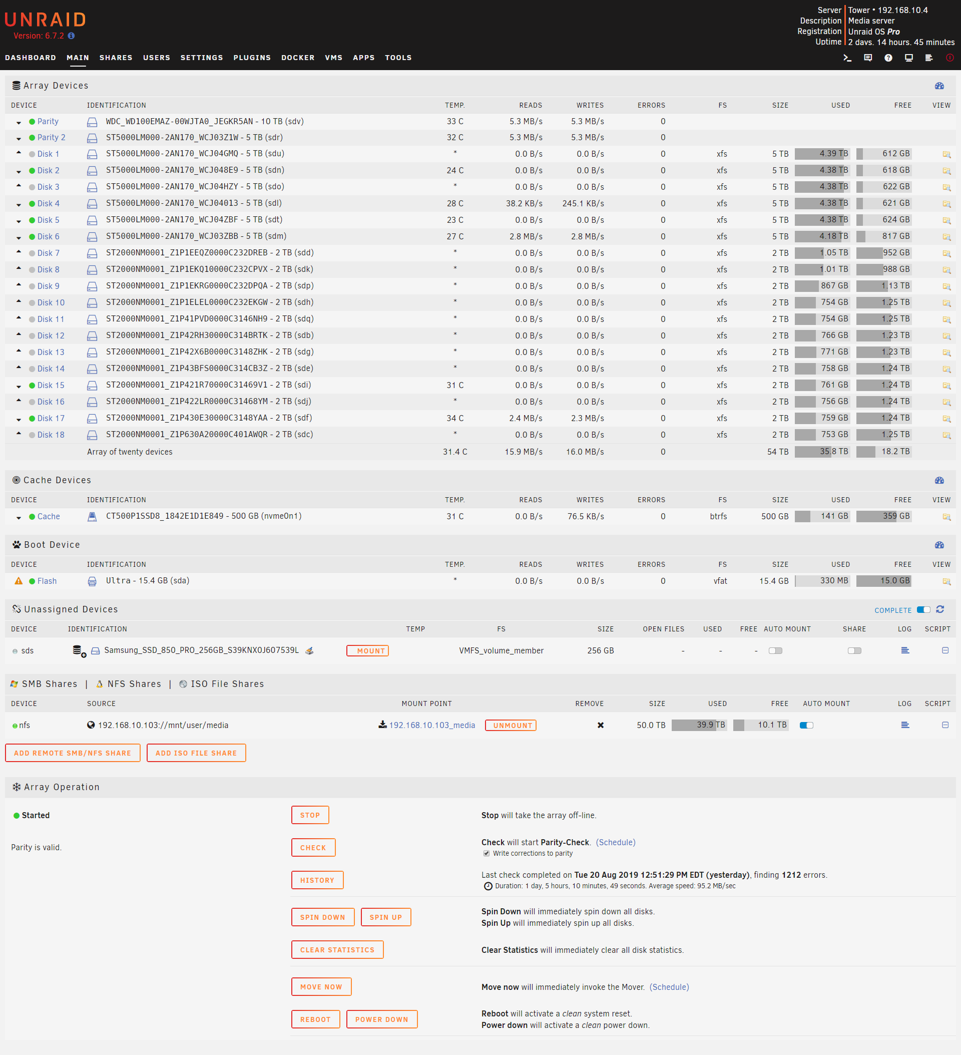

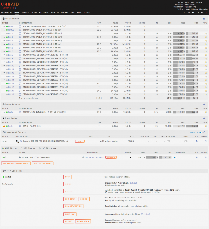

Screen Shot of Main Page for extra detail about setup:
1352857515_FireShotCapture003-Tower_Main-192_168_10.4.thumb.png.6913a0aa09281509707379c82f4624a3.png

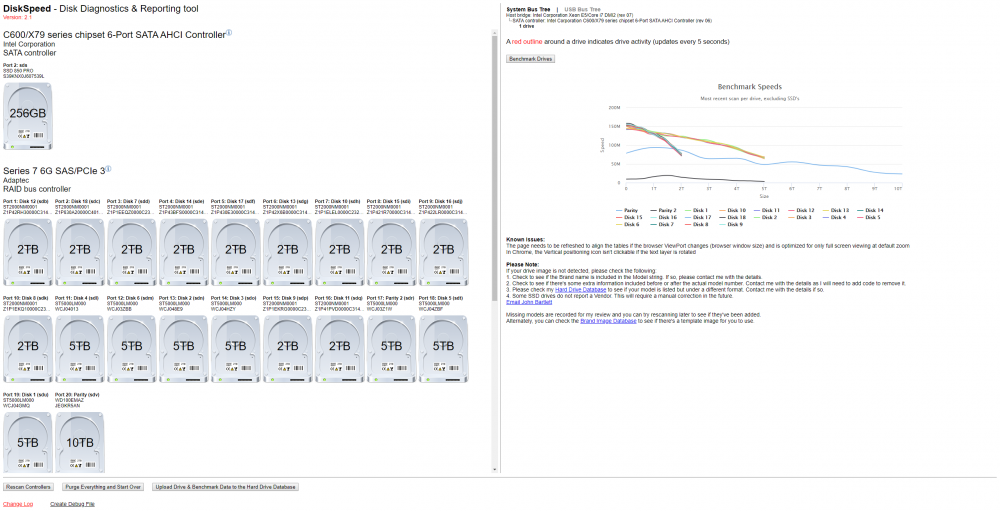

Just post the graph, the one testing the controller, if you can't run the controller test without hanging there's likely some hardware issue.

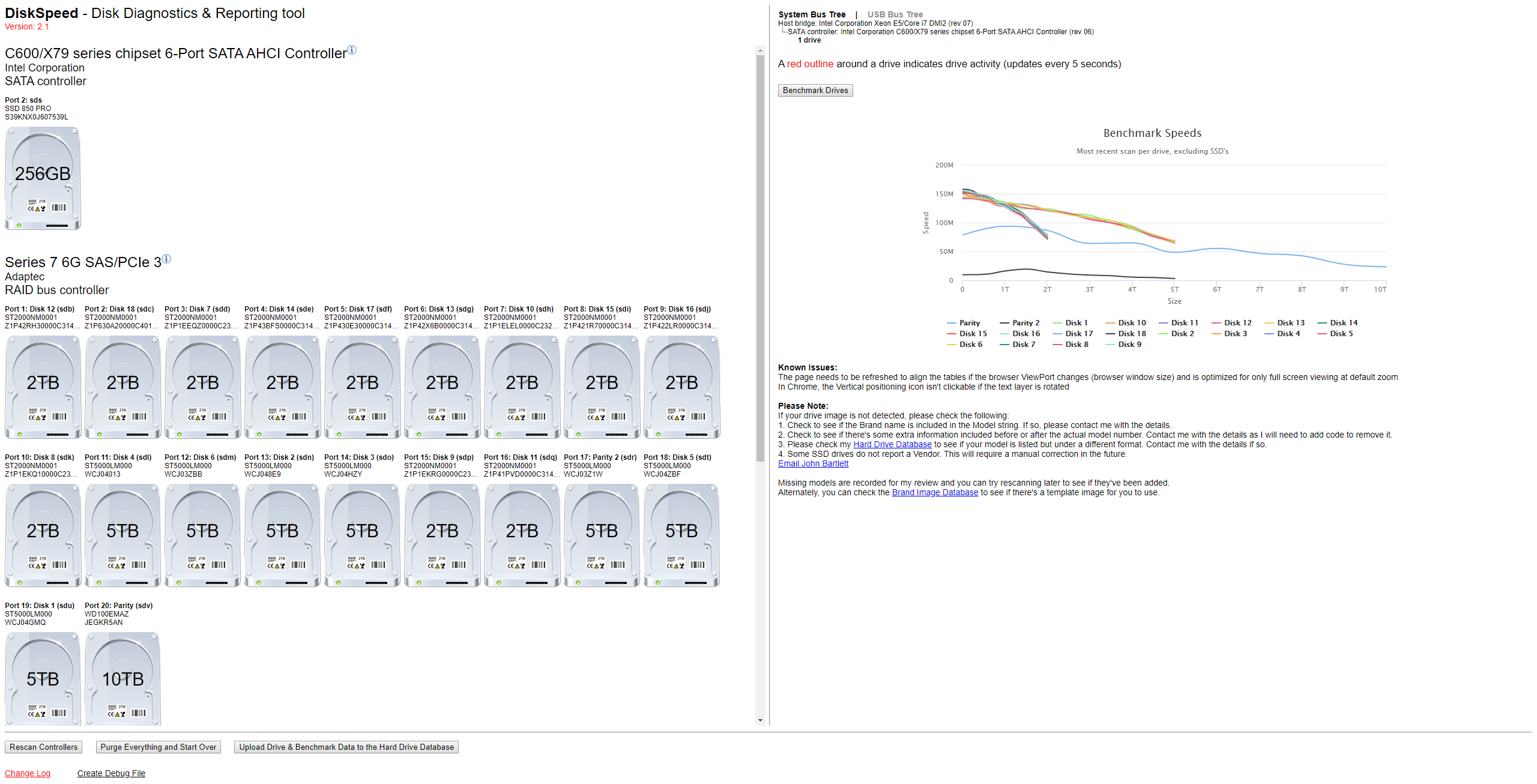

here is the most current graph1863557077_FireShotCapture004-DiskSpeed-192_168_10.4.thumb.png.0af87e8679c3447edbf8b02860ed3137.png
I wanted to see the controller test, where it tests each disk individually and then all together, click the highlighted part to run it:
Here is the test you are looking for. Tried running twice and both died out with an error for disk 16. Going to try and reseat and possibly replace the drive to see if that helps the test complete fully.
