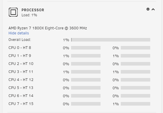

Hi everyone.  I'm trying to make sense of the wacky CPU usage reporting I see in unRAID.
The problem is, the dashboard is showing 6%-8% overall CPU load (most of the time, 6%) while my one and only VM (Win10 x64) is sitting idle at the desktop.  If I open the VM in VNC and look at task manager's details tab, System Idle Process is at 99%.  This is as idle as Windows 10 gets.
top shows qemu-system-x86 using more than half a CPU core.  This almost kinda sorta matches what the Dashboard is saying.  But right there in the same top output, the line starting with %Cpu(s) shows 99.8% idle, 0.1% user space, 0.1% kernel space.  These things are telling me different stories and I don't know what to make of it.  I've also got a terminal there running htop, and its data is rather substantially different from Dashboard as well.  Does anyone know why these numbers are so different?

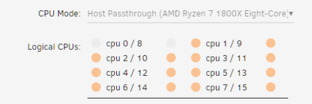

This is a fresh install of unRAID 5 days ago.  Currently I am not using this system for file storage at all except the minimum required to get the hypervisor enabled, which meant setting up a single disk in the array.  I have one virtual machine configured.  It is Windows 10 x64 and has one drive, a SATA SSD which is mapped directly to this VM (it was originally installed on bare metal, and can boot outside of unRAID).  The VM has 14 cores (or hyperthreads) assigned to it -- that is all of them except for the first (CPU 0 - HT 8).  I previously had assigned all but the last core (CPU 7 - HT 15), and the problem was no different.

I decided to see if reducing the core count assigned to the VM would cause a proportional drop in idle CPU usage.  I changed it from 14 logical CPUs to 8.
OLD CONFIG:
NEW CONFIG:
I didn't expect to solve problem of too-high idle CPU usage just by reducing the pinned core count, but it has been running idle like this all day and top shows qemu-system-x86 using only 4-5% of one CPU core.  That is quite reasonable for idle usage of a Win10 VM.  Power consumption is down to 45 watts too (used to be 55 watts), according to the outlet the machine is connected to, so I know it isn't just a CPU usage measurement error.
