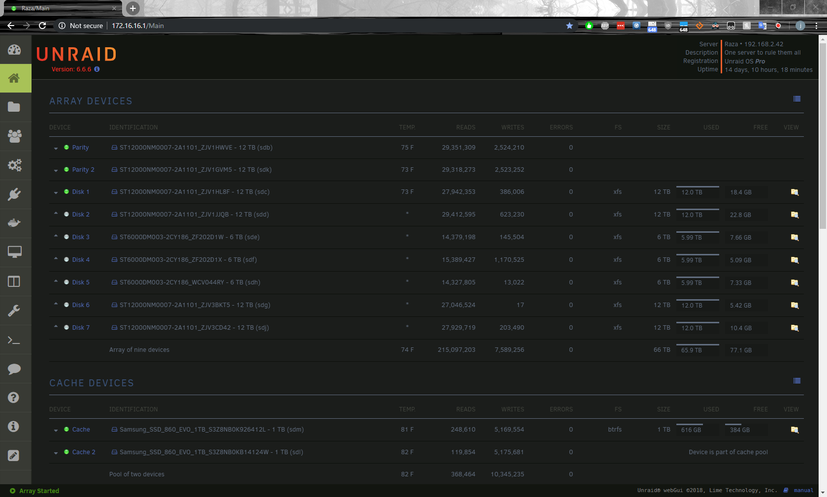

My server is a dell r720xd, so 14 drive bays (has 2 2.5in bays on back). 2 are for ssd cache and 1 is an ssd for VMs, which leaves 11 3.5in bays for drives. As you can see in the picture, really out of space. With 16tb exos drives still being new enough that they are ~25% more expensive per tb and haven't really seen trends yet on the off chance that there was a defect with drives, was going to go with 14tb exos. To use larger drives, I need to have bigger parity. Below is the proposed plan as for best steps to take based on what I've seen around, but guessing it has some steps that are not needed or other streamlining methods...and also last step is where not sure best method that is also safest.

First off, I know nothing about drive quality, so the question of which drives are good... I got nothing.
Your overall plan makes sense to me, replace the 2 parity drives first, since they need to be the biggest. After that I would go for the "rebuild drive" option instead of the "moving data" option. This allows you to drop a smaller drive back in, should a rebuild fail, and not lose data, as well as being the quickest option (that I know of). Hopefully this helps.
Replace your parity drives and rebuild parity. Take the 2 parity drives and use to replace any of the data drives. You can replace 2 drives at one time and they both will rebuild at once. Saves some time.
