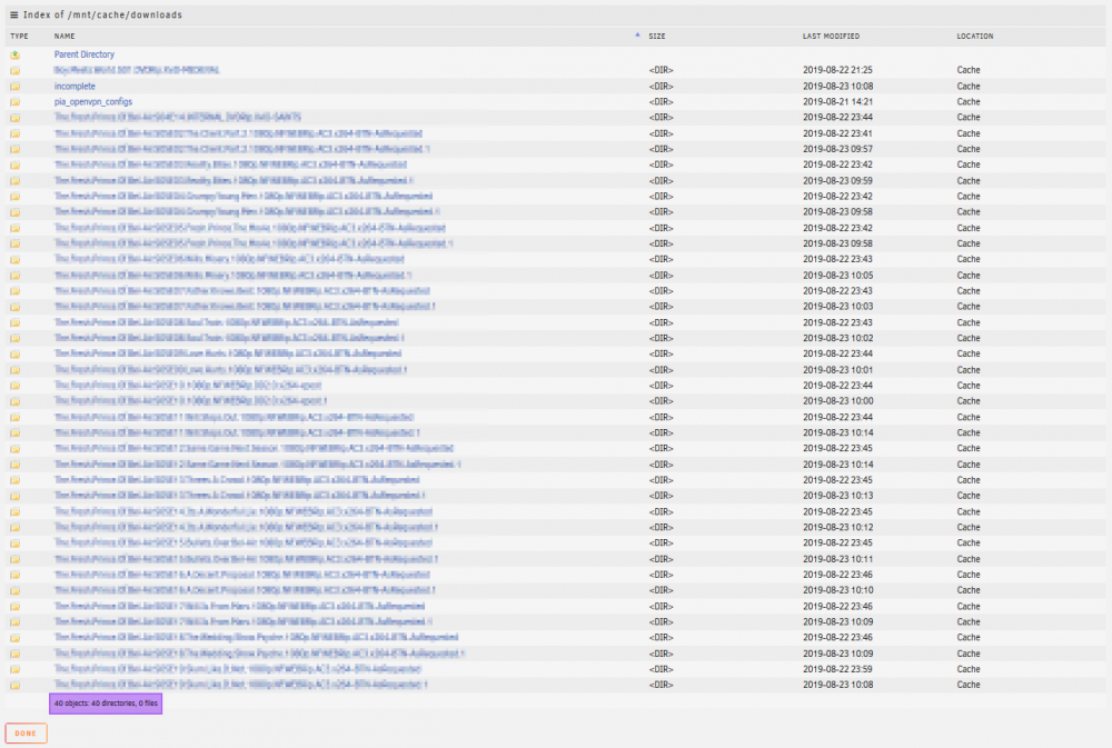

So the issue appears to be that the mover isn't actually moving stuff over to the array.
The cache disk is an older 120GB SSD and is not in a cache pool. I intend to upgrade this cache disk later next week.
After doing some downloading, I noticed the cache disk data wasn't being moved over to the array.
I tried to manually invoke the mover (which is scheduled to run hourly), and whereas the button would turn grey previously, it just changes back to orange.
I enabled mover logging and I can see that it starts and ends really fast, and that it skips the docker stuff which should be normal, but the downloads folder is still full of items that should now be on the array.
I have stopped the array and rebooted the server which did not resolve the issue
The only change was I added more ram to the server yesterday at around 8pm, but the mover process worked after that for a bit. I noticed it stopped running as intended around 11pm last night.
