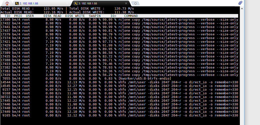

This is the result of the iotop when everything works fine

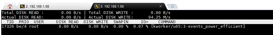

When it goes wrong It is seen that rclone processes disappear in the iotop. Although the rclone is still running.
If I stop the rclone the situation is even more strange since no process is supposed to be writing on the disk but the iotop is triggered and is usually like this for 5 minutes.

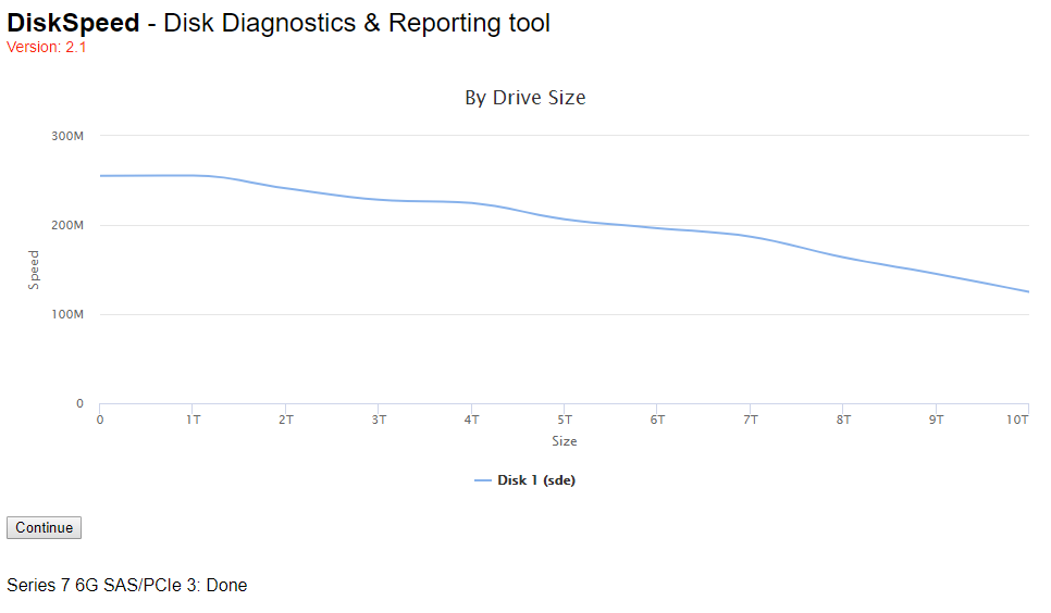

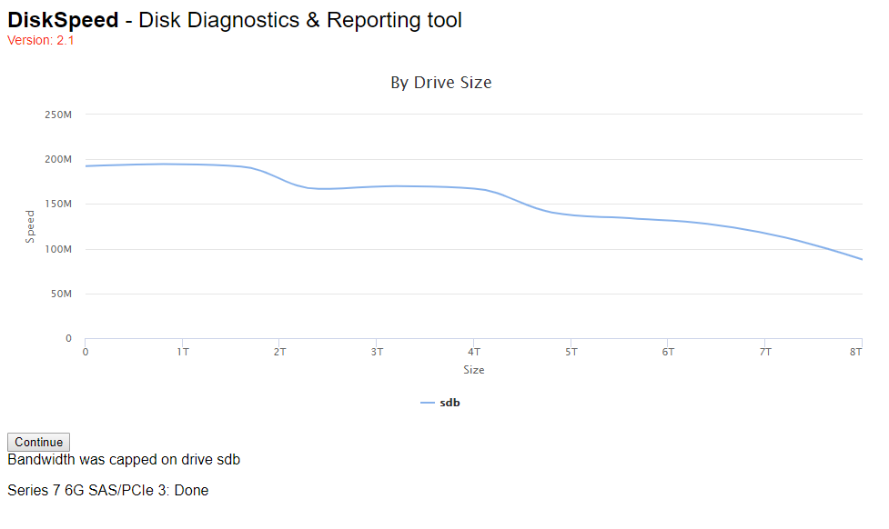

Result of an SMR disk:
Result of an non-SMR disk:

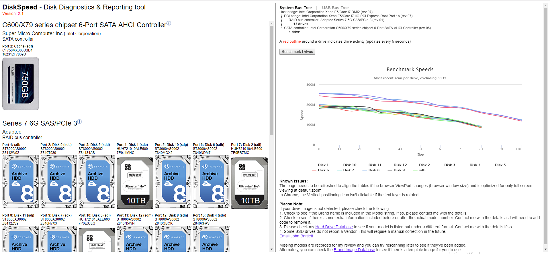

Result of everything the array has at the moment:
Speed excellant, but plugin seems haven't write test, so can't identify any write issue on SMR dsik.
When files writing to array, it will allocate to a disk, so could you try allcoate the write to another disk and check again. Next, I notice md_write_method was "auto" , may be you can try set to reconstruct write to see have any different.

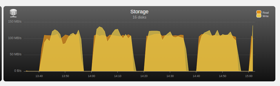

I have found a workaround while I find the definitive solution.
Using the CA Users Scripts, I have scheduled a task to copy for 15 minutes and stop, and launch it again after 5 minutes. So I always get the top transfer
I will adjust it if I see that I can extend the times more
I have transferred 300Gb in 1 hour.
