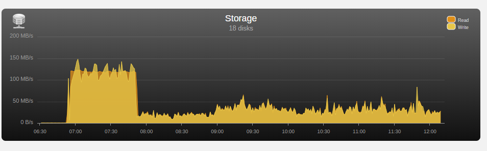

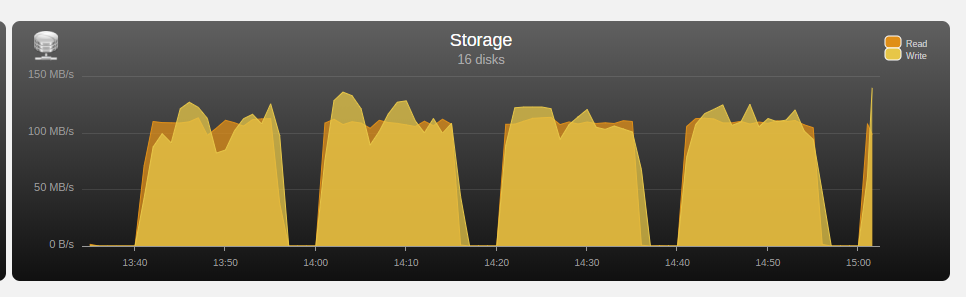

12 minutes ago, jvdivx said:
I have found a workaround while I find the definitive solution.
Using the CA Users Scripts, I have scheduled a task to copy for 15 minutes and stop, and launch it again after 5 minutes. So I always get the top transfer
I will adjust it if I see that I can extend the times more
It better then nothing.
