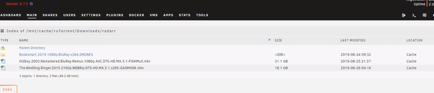

Back story - flash drive died. Rebuilt a few weeks ago. Everything was working great. A week later, cache filled up and apps were no longer working since it was out of space. Deleted some files off one of the cache folders to make space.
Anyways - here are some files that will not move off cache. I've ran mover manually a few times now. Nothing changes. Tried tools > New Permissions. Didn't change anything.
Any idea why it won't move off?
image.png.c4574a7597f8aa174dc4b9f2007b65c0.pngimage.thumb.png.b1a289106fcfe995d24de247ac857cf4.png
Mover won't touch any files that are in use.  Are they seeding?

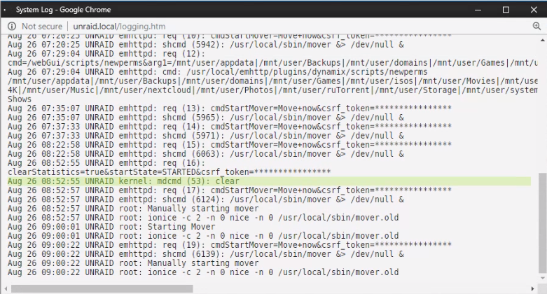

Make sure mover logging is enable, run the mover and post diags.
I just enabled it, ran mover, and not seeing any new log in the /logs/ folder on the flash drive. Is it somewhere else?
This is in the web interface log if that helps:
Edited by Fiala06

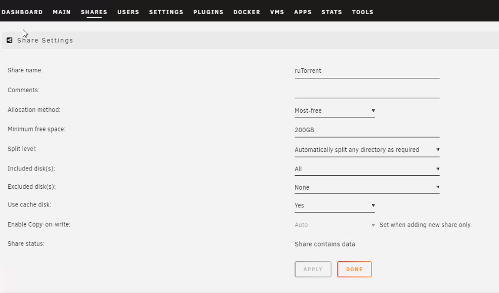

If there are no mover related errors in the log most likely the share where the data is is not set to cache="yes"
See first post. It is set to yes. Guess I'll just continue to monitor it. Don't recall ever having this issue before.

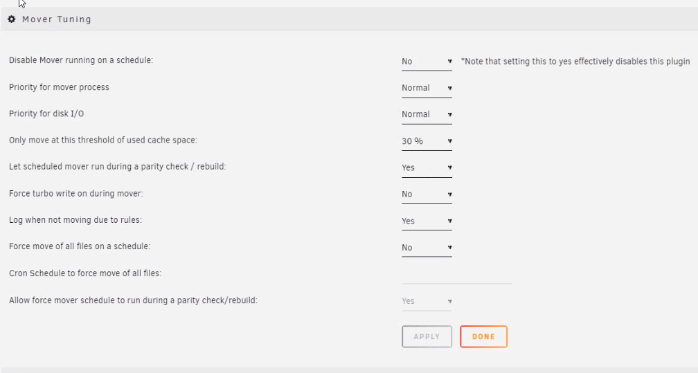

Why is it using mover.old, are you using some mover related script or plugin?
Oh didn't notice that. I do have CA Mover Tuning and thats what I enabled for loggging. Not mover itself. Oops wonder if thats whats causing problems.
So here is the log from the actual mover this time, not the CA Mover Tuning plugin logs.
